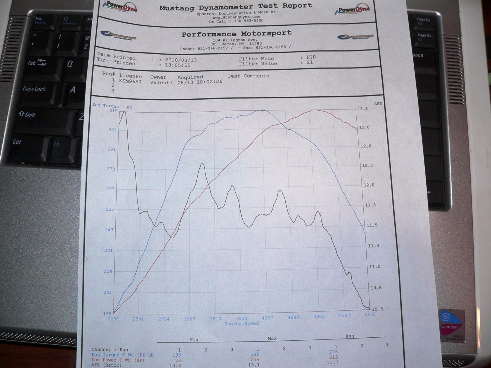

Mach 5 Posted August 14, 2010 Author Report Share Posted August 14, 2010 dyno run from today  1st running tune @10psi 315tq 279hp  video coming soon! Quote Link to comment Share on other sites More sharing options...
RobertISaar Posted August 14, 2010 Report Share Posted August 14, 2010 for 10PSI, those are some great numbers. Â the wildly flucuating AFRs hurt it in places, but those are some damn good numbers. Quote Link to comment Share on other sites More sharing options...
AL Posted August 14, 2010 Report Share Posted August 14, 2010 Yah that thing is running super lean Quote Link to comment Share on other sites More sharing options...

Euro Posted August 14, 2010 Report Share Posted August 14, 2010 Those are some good numbers for the first run. Quote Link to comment Share on other sites More sharing options...
mra32 Posted August 14, 2010 Report Share Posted August 14, 2010 I'm not a tuner, but for a boosted engine...those AFR's seem about right...on the RICH side. And the fluctuations are like 1 on the AFR scale, not including the beginning and the end where it goes closer to soich and pretty dang rich respectively. Does 1 point of fluctuation make a huge difference? Â Car is dope...any suspension modddzzz? Quote Link to comment Share on other sites More sharing options...
AL Posted August 14, 2010 Report Share Posted August 14, 2010 on the RICH side Oh yah, I am not sure what I was thinking Quote Link to comment Share on other sites More sharing options...
RobertISaar Posted August 14, 2010 Report Share Posted August 14, 2010 well, let's take a look and analyze: Â see where it leaned out a LOT at ~3500RPM and you see a very obvious dip on the torque? going lean not only cost power, but it is also more likely to cause detonation as well, which when in boost can be total devastation. if you look at every other lean peak, you can see the drop, with the exception of the last two, but they were also very mild compared to the rest. hell, look at the first peak/drop, there's a subtle change, but it is still there, and there's a good chance that was with very little/no boost. Â contrasting: the first huge dip, where it dropped to ~11.4:1? you can also see the HP/TQ drop slightly because of it. it looks like ~11.6:1(according to whatever specific wideband read this) would be the sweet spot with this engine. richer wastes fuel and drops power, leaner can cause detonation, drops power, heats up everything and can make your block shit a rod or two. Â that being said: TQ peaks at 4300 and HP peaks at 5000 or 5100, with some damn good numbers for 10PSI compared to GM's official ratings at 8.5PSI(205HP)..... and this is at the wheels too, no? Quote Link to comment Share on other sites More sharing options...
Turbo v-sick Posted August 15, 2010 Report Share Posted August 15, 2010 Not bad for a mail order tune, Just needs some small fuel corrections. The tune is set up for safety and break in of the new engine, It's far from wicked.... :burnout: Quote Link to comment Share on other sites More sharing options...
Mach 5 Posted August 16, 2010 Author Report Share Posted August 16, 2010 (edited) Thanks for the comments guys!! Adam yeah especially since we're at diff alt.. the tune is very good considering we didnt know what to expect. Im very pleased! Well I guess Im gonna try datalogging it this week and see how it goes from there. Â video- http://www.youtube.com/watch?v=JKFgRlcchyw http://www.youtube.com/watch?v=PvkqS4JNa90&feature=channel http://www.youtube.com/watch?v=namP2urQ5Z4 Edited August 16, 2010 by Mach 5 Quote Link to comment Share on other sites More sharing options...
