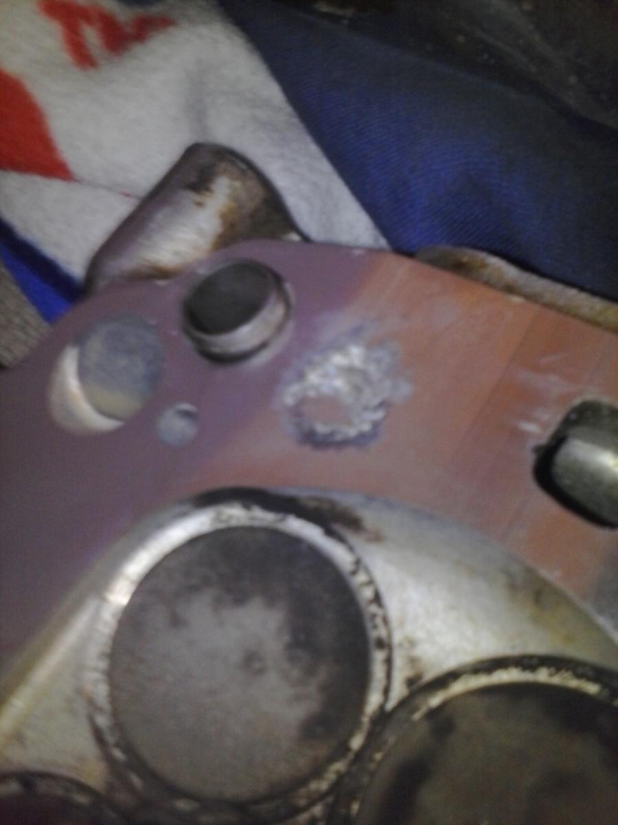

But I did end up getting my heads cleaned up, milled down .008 inch, the pitting is still there but very, very minimaly. Just wanting to get a better seal on the gasket. And now I'm just waiting on parts to get here from Rockauto!
