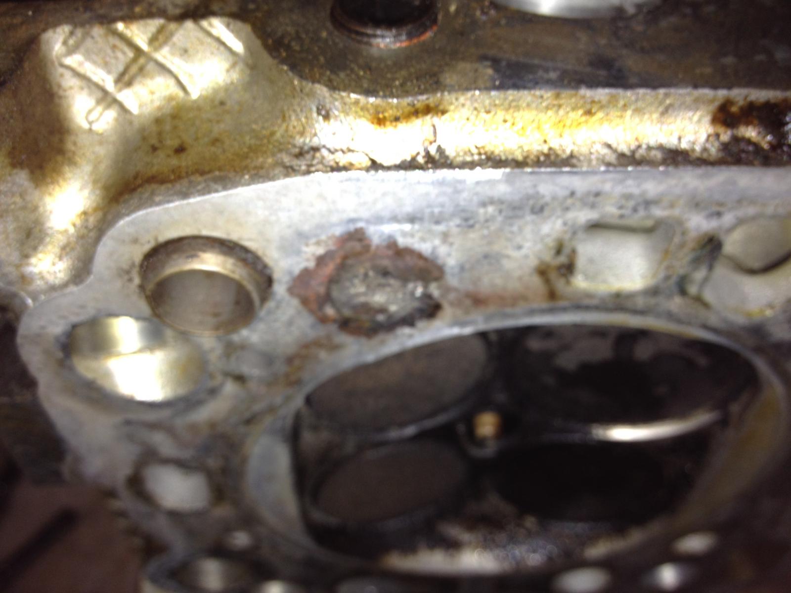

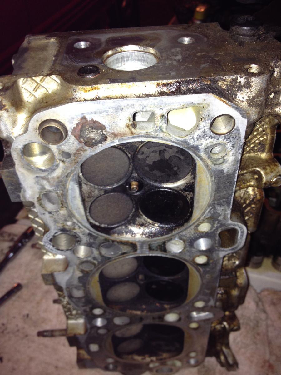

I need some insight on milling the heads on my lq1. It has some "pitting" where a blocked off coolant passage went to and that happened to be the spot where the gasket popped. I highly doubt it will seal good if i dont machine them. So do I get them both milled to the same specs and how much can be safely taken off so I dont risk PTV clearence.

Depends on the severity of the corrosion and pitting...can you send a pic? My experience has been to clean the surface as best as I could...
And, the part that many may disagree with, is since I generally don't have the option to machine the block's deck surface, I always apply Permatex High-Tack, to ensure a good seal between the head gasket and the deck...not the spray one, but the liquid one with an applicator, sort of like PVC glue. Nasty, stinky stuff, but I've never had to pull one back apart in over 30 years of having done so.

I will try to post one up, give me a few minutes.

Well, that should be cleaned up when the heads are at the machine shop...how does the corresponding deck surface look on the block?

just have the shop take off as little as possible to get it cleaned up....
if a combined .010" gets taken off, your compression will be up from ~9.29:1 to ~9.52:1. i'm not sure how much the LIM will tolerate without being modified, but beyond that and i'd start looking for either new heads or a new short block.

I just take the heads to the machine shop and tell them to "clean it up"
They just skim cut it until it looks good. Never had an issue.
The block itself is in nice shape, not pitted at all and clean all gasket material off.
I just want to clean it up enough so it will seal from around the edges,
