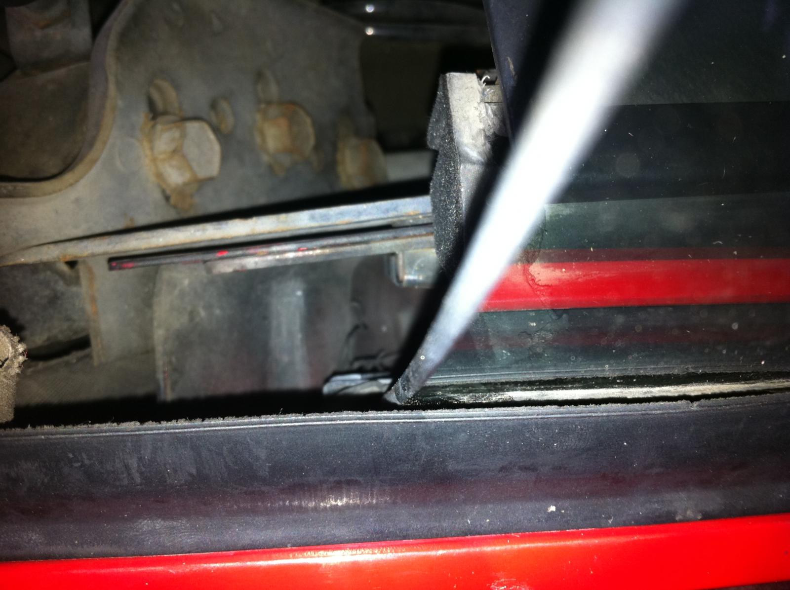

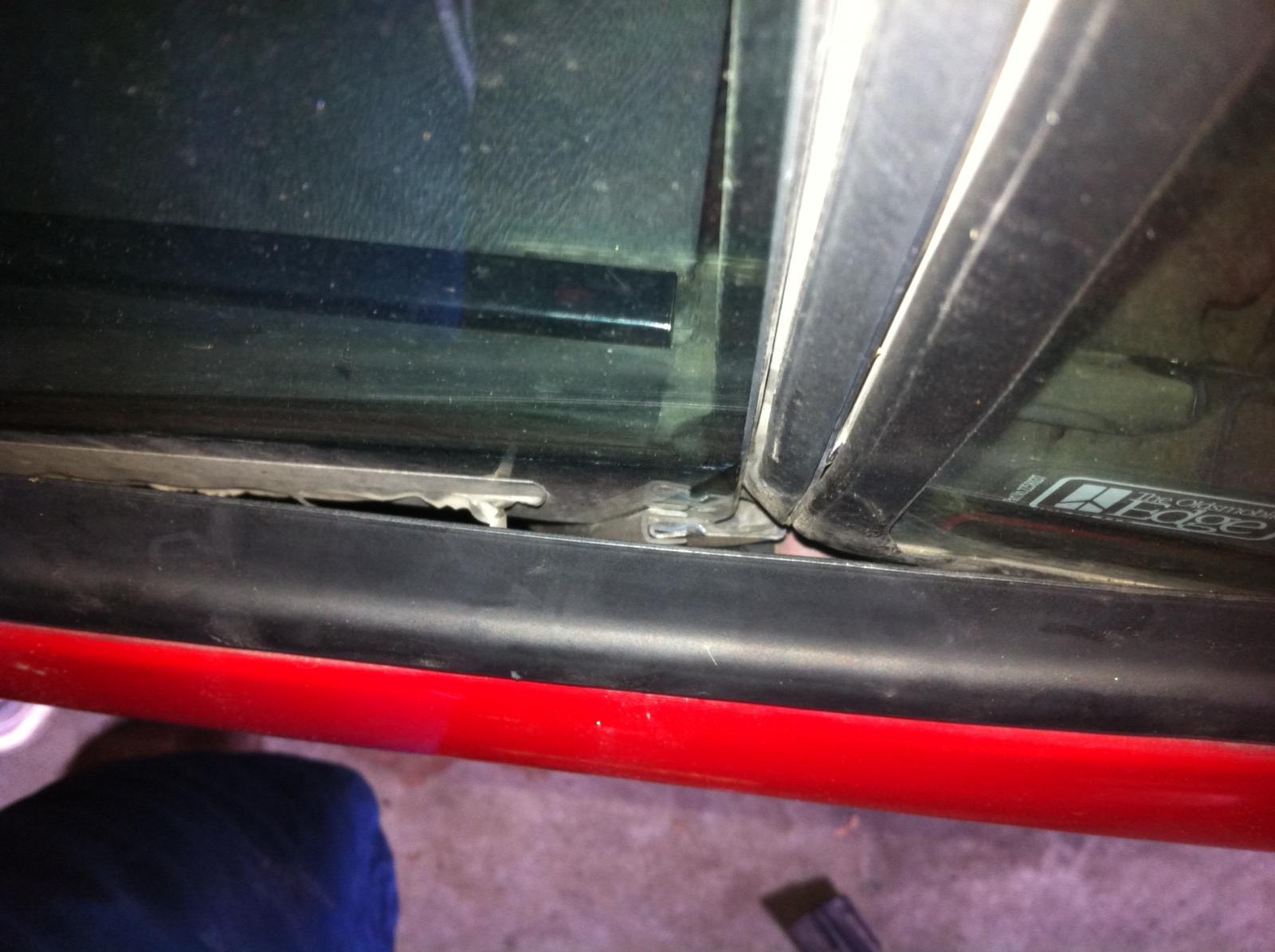

93-02 f-body exterior window wipes
I also bought some of these off a camaro at my local junk yard. I haven't put them on yet since I couldn't figure out how to get the trim piece off. They look like they'll work perfectly. Can you do anything to keep them from cracking in the future?
Thanks for posting this, it gives me hope for mine. I'm a little nervous to tackle some of this stuff myself.
Yeah, I've heard put Vaseline on them so they won't dry out or crack.
I have some OEM weather stripping that is in near perfect shape. But taking off that trim piece is something I don't wanna do.
I know there are 3 8mm bolts that you have to reach to get from inside the trunk. Then there is one screw behind the black metal cover. You will see it when you open the door. On the B pillar.

What did you find is the easiest way to remove your red trim piece that is in front of the weather stripping?
What size are the bolts?
the bolts are 9mm. put the top all the way up and lay on your back in the trunk to reach the three nuts or you can reach them from the side but the last one is a stretch. also its easier if you take off the carpeted covers over the trunk lid hinges. THEN... be careful pulling it off, it should have 2 sided tape between the rivets. I pulled gently and sliced it with a razor.
After those are off I put the top down so the small back window was down out of the way when you drill out the old rivets and like mentioned before its still a good idea to put something between the drill and the glass. I used 3/16 rivets, just had to drill out a little extra.
