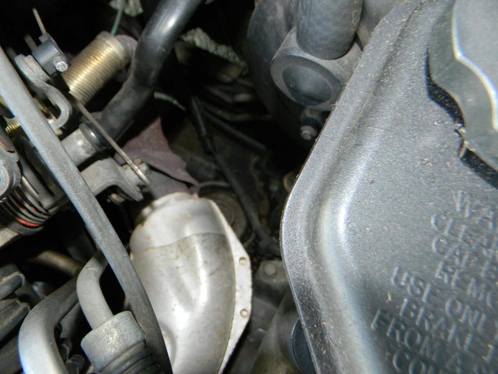

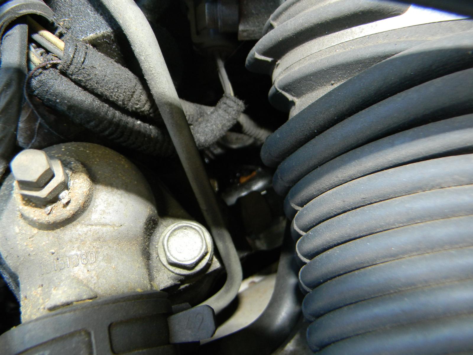

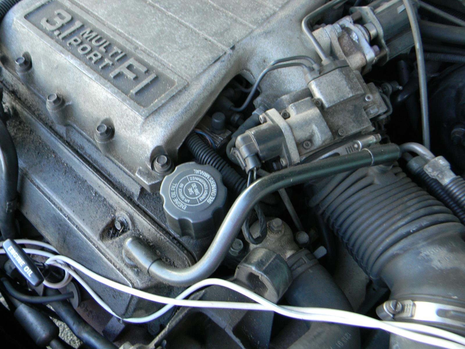

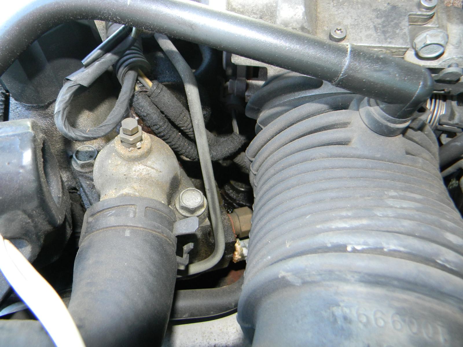

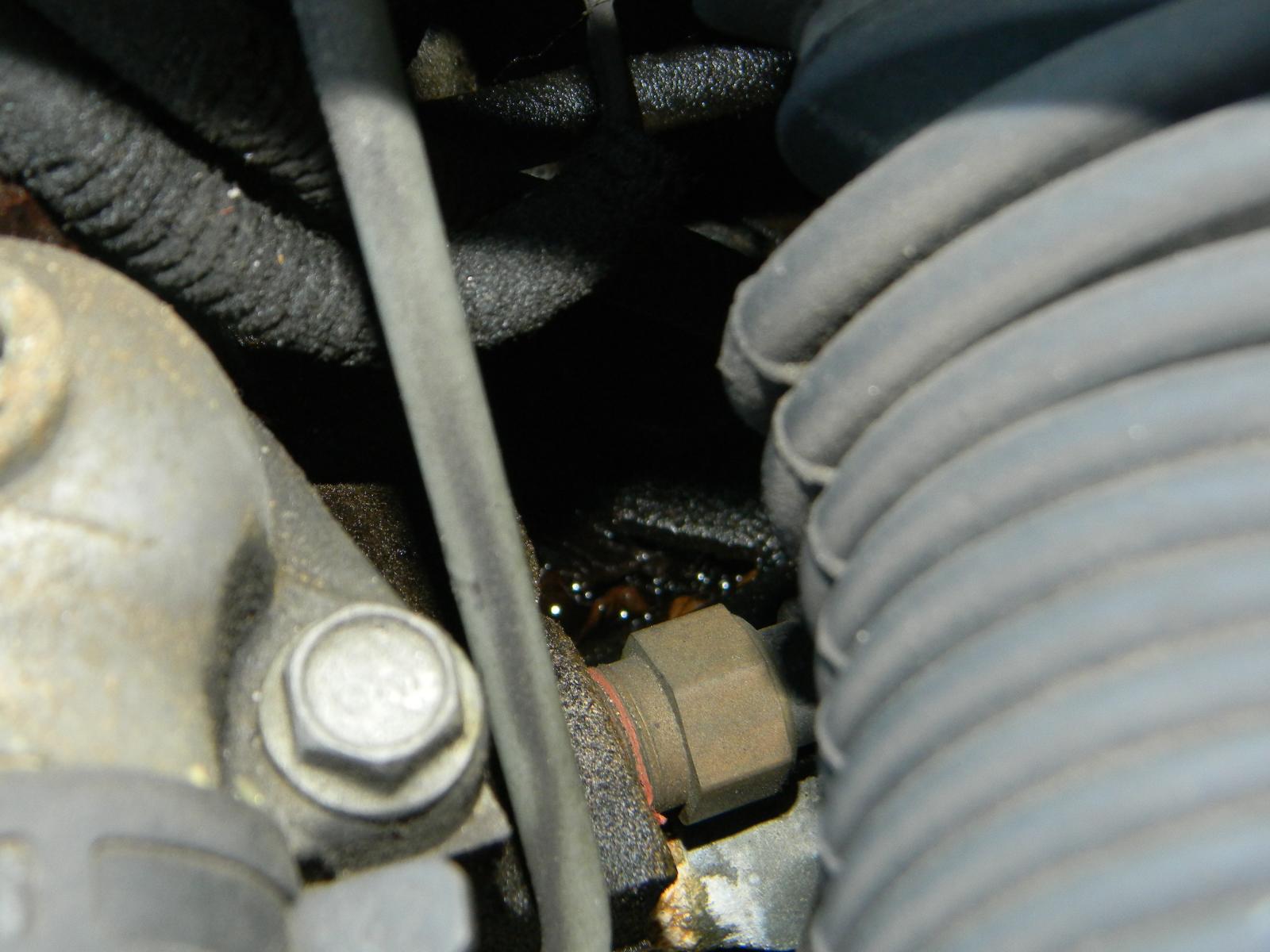

Chris2012 Posted October 22, 2012 Report Posted October 22, 2012 I'm going to attempt to attach photos (yay it worked, but they're not in order). I'd say it loses about a quart a week. 182,000 miles, plan on taking it on a long trip (~1300 miles). She's all I got right now I'll try to explain. There's a recesses area just to the right (perspective of someone standing in front of the hood/engine) of the plenum?/throttle body?, oi the thing that says "3.1 Multiport FI". Basically just behind (same perspective) the filler cap. It's oily down in there. It leaks out apparently, then travels toward the rear of the car. You can see the pathway in one of the pictures. Sometimes it even seems like coolant comes out of there also. No oil is not smokey or anything like that, looks normal. Assuming it is a crack, I'm planning on getting in there, cleaning it thoroughly, then jamming epoxy putty in there. I should think it would hold for a while. Oh it's a one way trip 92Lumi 1 Quote
80's tech Posted October 23, 2012 Report Posted October 23, 2012 o-ring on oil pump drive shaft? [ where distributor would be ]. 92Lumi 1 Quote
RobertISaar Posted October 23, 2012 Report Posted October 23, 2012 that's exactly what it looks like from those pics. Quote
19Cutlass94 Posted October 23, 2012 Report Posted October 23, 2012 Yep thats what it is. Those o-rings get hard and brittle and crack over the yrs letting oil out. 92Lumi 1 Quote
