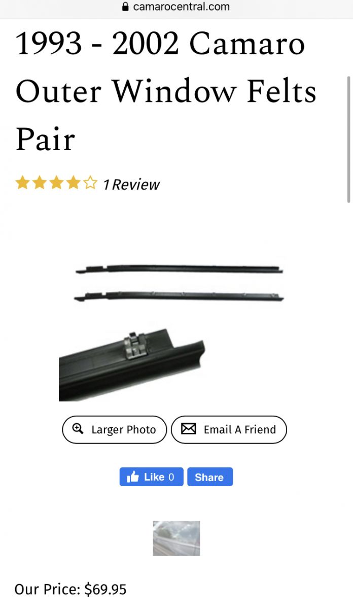

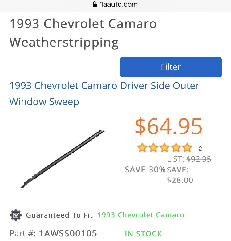

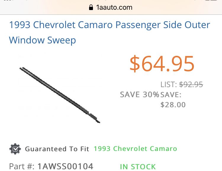

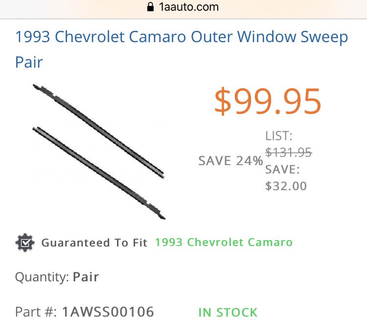

jonosso Posted August 6, 2020 Report Posted August 6, 2020 On 7/5/2016 at 2:12 PM, 94 olds vert said: These, get these lol I see that the Camaro weather strips are specific to the driver and passenger doors. Your one post stated that you cut off from the pillar edge while leaving the back of the original end. I assume that means that it is important to purchase the Camaro drivers side for the Olds driver side and the same for the passenger side applications. Am I correct? Also, is there a quality difference between Camaro Central and 1A Auto? Thanks, Jonathan Camaro Central (pair) $69.95 1A Auto (pair) $99.95 1A Auto (individual sides) $64.95 94 olds vert 1 Quote
94 olds vert Posted August 6, 2020 Author Report Posted August 6, 2020 Yes, driver side for driver side and the passenger side for the passenger side. These hold up much better than the original rubber gm used. Quote
jonosso Posted August 6, 2020 Report Posted August 6, 2020 8 minutes ago, 94 olds vert said: Yes, driver side for driver side and the passenger side for the passenger side. These hold up much better than the original rubber gm used. Thank you for the fast reply!!! Do you know of any quality differences between the two vendors? The price difference makes me wonder. Quote
94 olds vert Posted August 6, 2020 Author Report Posted August 6, 2020 Oem is the best. I would look at a local scrap yard to find these parts. I would think all after market parts are the same. Quote
jonosso Posted August 7, 2020 Report Posted August 7, 2020 3 hours ago, 94 olds vert said: Oem is the best. I would look at a local scrap yard to find these parts. I would think all after market parts are the same. Ok. Thank you very much for your helpful and speedy replies. I really appreciate it. Quote
