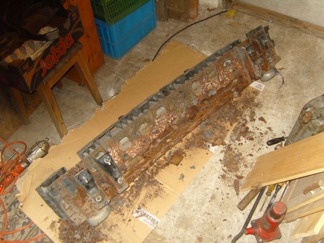

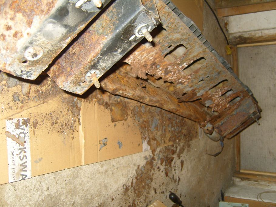

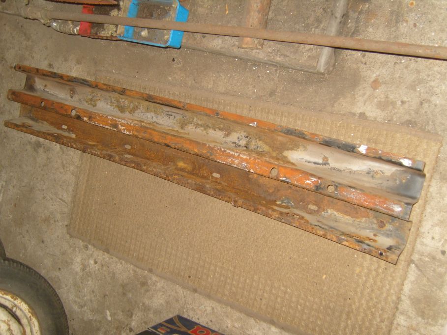

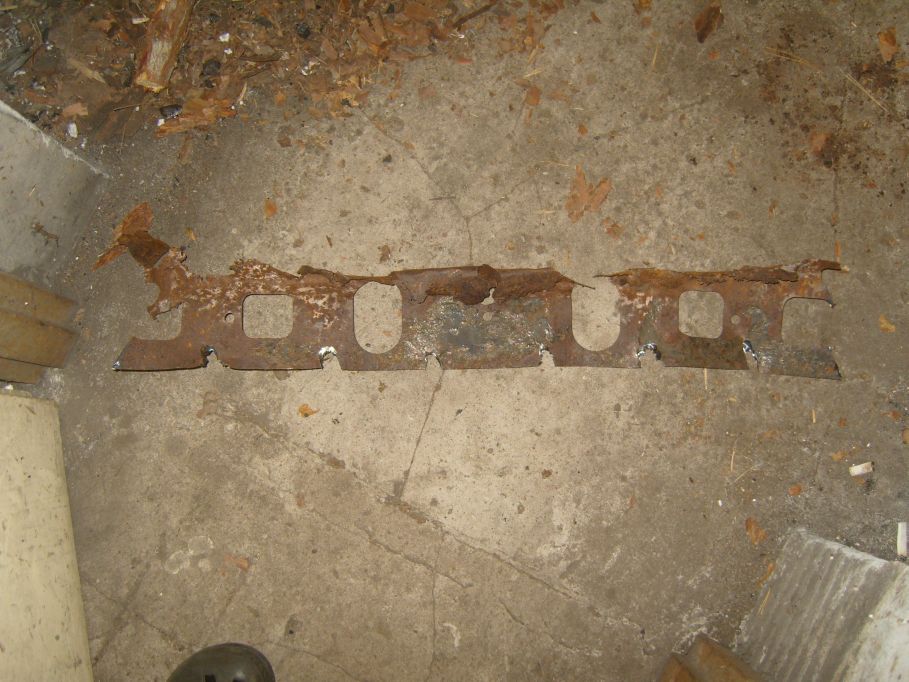

It's a straightforward job now that all the elements have been split. The front (as it sits on the car) of this bar will be covered with a single piece of sheet steel, as per the original. One of the photos attached shows a bit of the old panel, with factory-cut holes.
I can't decide whether to add these holes to the replacement panel, to keep the car looking original, or to dispense with the holes. The former route would enable water to get in and around but make it possible for an annual refreshment of rustproofing treatment. The latter route of a closed panel would keep water out but not allow future access.
I'd be grateful for comments and opinions on this dilemma, before I get going on it on Tuesday.
Either way, it's going to be in a much better state than it is now :).

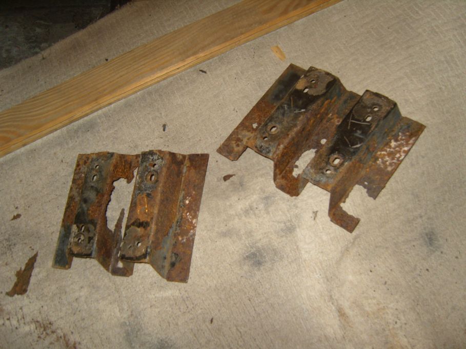

Note, for anyone who might do this job:
The mounting brackets with the captive bolts were spot welded to the original large piece of steel I am replacing, and the large panel then spot welded to the reinforcement bar. There are no direct welds between the mounting brackets and the profiled rear section of the reinforcement bar, and this made it easy to strip the whole thing down.

Keep/make any holes that are needed for bolt accesses. Otherwise, don't add holes, or bother to make it look like stock.

The original bolts were joined in pairs by a strip of metal and held in place in the holes by push-on clip washers. Some nuts came off okay, others felt the wrath of the grinding disk. I'm considering using standard bolts and welding the heads to the insides of the mounting brackets. Once the car is finished, I'll be giving it an annual once-over for my friend, the owner, so I can run each nut off and back on regularly so they don't seize.

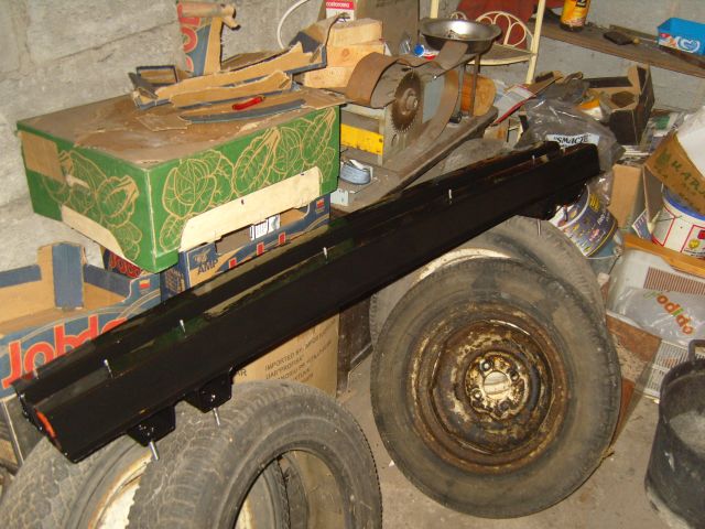

Got the rear bumper rebuilt, it's back on the car looking like a reinforcement bar :). I got a bit lucky I reckon. I'd welded four bolts at the upper mounting points, and the bumper went back on no hassle.
Here's a tip if you ever get a welded-on bolt a millimetre or two out of alignment. Grind the thread down on the side until the bolt goes in its hole. The nut will still do its job, if you don't take too much off. This will not be appropriate for ALL situations, but would have helped me with the bumper replacement if a bolt or two (or four :)) hadn't wanted to go in.
Before and after photos..........must tidy up soon :):
