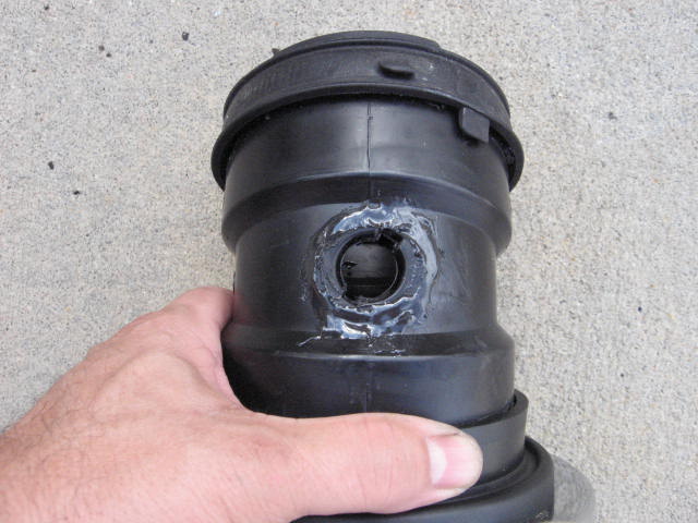

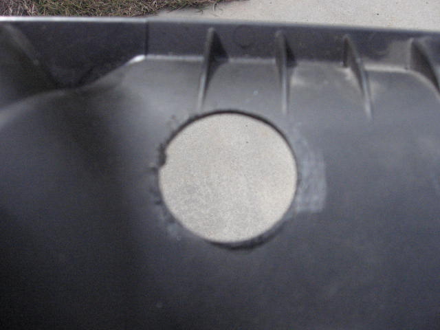

I grabbed an elbow from Lowes and lucked out in that it fits perfectly. The various rubber bands or connectors fit perfectly too from the original set-up. I drilled out the OEM Air Box where the Air Temp Sensor goes. I then J-B Welded the sensor's fitting into the black PVC elbow. Very easy and very cheap. About 5 minutes of drilling and J-B welding.
Right now, I am going to be trying out the K&N knock off (Spectrum Cone Air Filter) since I am still in the R&D phase. Once that works out, which I am assuming it will, I will snake the cone filter thru the fender. That should actually be pretty easy too since the PVC stuff slips together and I can glue it. Overall, for a real cold air induction in the works. I got about $25 bucks invested thus far. Assuming all goes well, another $5, and I am done. The only thing left is figuring out how to mount and protect the smart box. Right now, I have the box resting on the OEM air filter temporarily. I am thinking of hitting the dumpster and looking for some pieces of the high density grey foam.post-6659-143689142238_thumb.jpg
