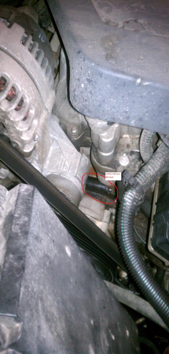

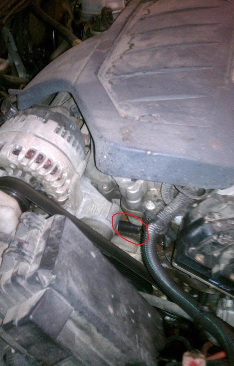

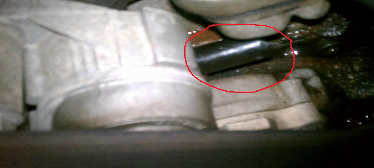

04PGPGT Posted April 1, 2011 Report Posted April 1, 2011 I own a 2004 Pontiac Grand Prix GT 3800 6 cylinder engine. I noticed after exiting my car one day that there was a sudden soft burst/ poof sound that came from beneath my hood associated with steam followed by red orange in color fluid non-oily flowing from beneath my car. I was not sure what had happen or even where the fluid came from even after looking under my hood for hours so I decided to poor water into my radiator and that same water that I poured exited from the hose that burst which is located sort of attached to my alternator. where the alternator sits there is a small block right under it and then another block under there with the hose coming out of it (attached not loose). My problem is that I do not know what the name of the hose is are where the other end attaches. I have not driven my car since so I am unsure if it'll run hot if I tried. My air cools as normal but I am not so sure about my heat unless I did not sit in my car long enough with the heat on; it seems as if the heat blows cool air as well. What is the name of the hose and how can I replace it? The hose is small no way near as large as the radiator hose. PLEASE HELP! Quote
AL Posted April 1, 2011 Report Posted April 1, 2011 Its a coolant elbow and they are known for breaking... You will have to pull your lower intake to replace it... The part is cheap since you can buy it at any parts store in the HELP section... However since you just lost your coolant, I would not drive it far Quote
Andrew Posted April 1, 2011 Report Posted April 1, 2011 looks like a coolant elbow. You can find it in the HELP! section of the auto parts store. http://www.zzperformance.com/grand_prix/products1.php?id=370&catid=103 Quote
