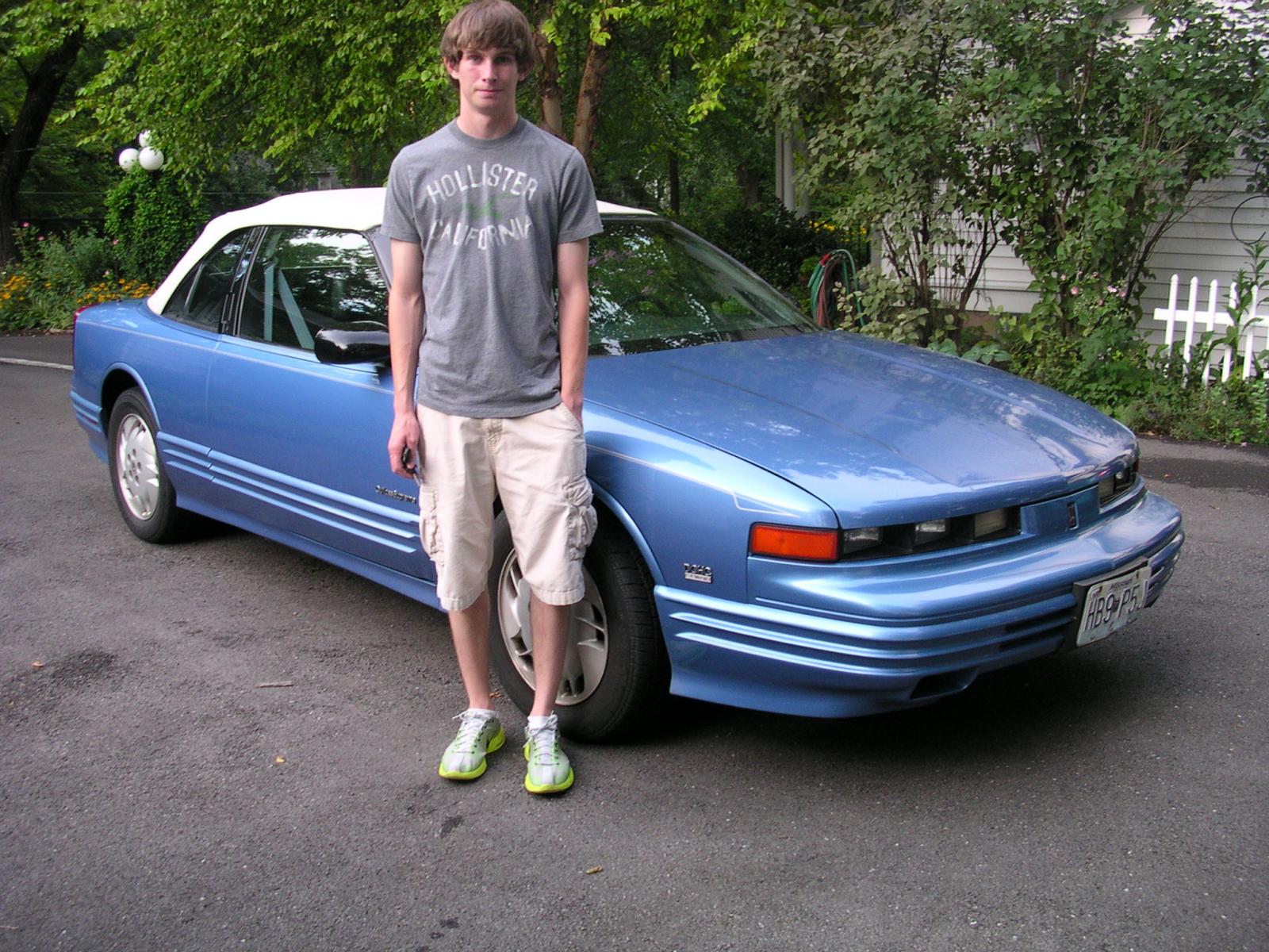

M U Tiger Posted February 4, 2011 Report Posted February 4, 2011 (edited) My son and I bought a '94 Cutty convertible that is slightly lighter blue than yours, see photo. It is a great car, in spite of all the horror stories about the 3.4L DOHC Engine. We have 113,XXX on it and it runs fine. We may tackle the timing belt replacement this summer. (Unfortunately, a vandal whacked his passenger side mirror today, so it's hanging by the wires, but otherwie she's in very good shape.) My son loves his first car. Edited February 4, 2011 by M U Tiger Quote

Afubar Posted February 6, 2011 Author Report Posted February 6, 2011 Hey there Crazy K, I remember you. M U tiger - what a great looking car and kid. 95whitevert - no problems I just installed a new electric antenna in the vert yesterday. Have an appointment with a GM shop this coming Friday to check the PS leak and do an overall check. Because I plan on keeping this car for a long, long time I want to keep it stock as close as possible and keep the car's engine working great. Oh, and to all the owners of the great verts here, I am glad I'm not the only one that loves the vert. I drool each time I see the Reds though. I like the color I have now, but my heart does truly belong to the Red. Quote
