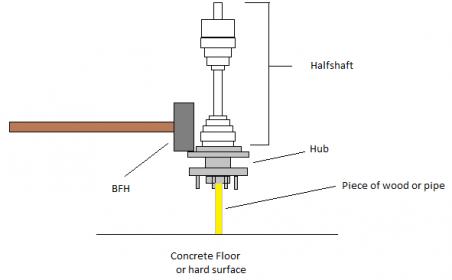

GnatGoSplat Posted July 26, 2010 Report Posted July 26, 2010 Thread gap, yeah, I got a 96 hub once and the stud ends were smooth which is different from the older W-bodies which were threaded all the way to the very end of the stud. I don't know why they did that, doesn't really make sense. Maybe it made installing the wheel easier or something. BFH? BIG Freaking Hammer? I seriously considering taking down to the shop and either having them charge me labor to take new bearings (I bought), and replace the old. I sure would love to see how they are going to get them out. The other thought I had was to take it in and ask for them to loosen the half shaft, and put it back into the old bearing and I would take it home and replace the new bearing. That was just a thought though. I think you should be okay since others have used the BFH. Just thread the axle nut back halfway on and wail on it. It should work. If you're really paranoid about hurting the halfshaft (though it doesn't seem anyone has hurt theirs that way), I've made a little illustration of what I was describing earlier that you could do if you pull the halfshaft out with the hub. MS Paint FTW! Yeah, I was really bored. Quote
dodgethis Posted July 27, 2010 Author Report Posted July 27, 2010 Gnatgosplat, thanks for the diagram. I hate to say it bit due to the hub, and not having much time to tackle it again, think I'm gonna get shop to help me out. I was quoted 80 dollars for each side. I don't think that's a bad deal, course i'd love to do it myself but didn't think I would have the spindle cease, hind site being 20/20 Quote
