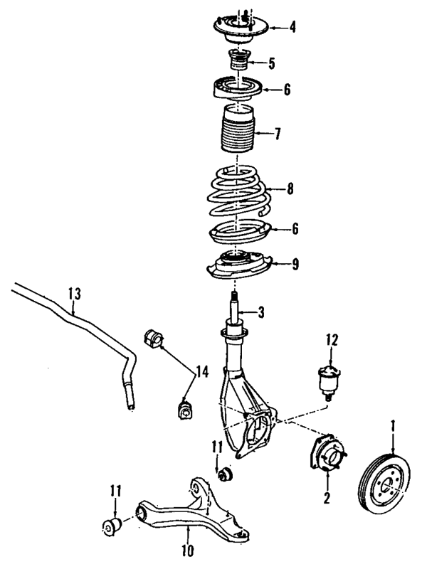

Scottster Posted March 24, 2009 Author Report Posted March 24, 2009 So just to be sure of what I'm thinking... 5 is the rubber I could see through the top, and it compressed when the weight of the car was let down. 6 is made of steel or rubber? They call it an insolator, but it looks like where the spring sits, so I would think it would be steel? Quote
BXX Posted March 24, 2009 Report Posted March 24, 2009 So just to be sure of what I'm thinking... 5 is the rubber I could see through the top, and it compressed when the weight of the car was let down. 6 is made of steel or rubber? They call it an insolator, but it looks like where the spring sits, so I would think it would be steel? Ok... 4- The upper mount plate, steel, above 4 would be the rubber strut mount! 5- A urathane foam bumper, wont cause any noises 6- Upper spring seat, its rubber, wont cause a clunk, can squeak and bind, and maybe the spring to shift 7- Strut boot 6- Lower spring seat, same as 6 and can cause the same noises when its bad 9- Lower spring seat bearing plate, can cause binding (causes memory steer) and can cause a clunk!! When it goes bad, they can get loose and make a clunk noise Quote
Scottster Posted March 24, 2009 Author Report Posted March 24, 2009 Hum, so it's not even in the diagram...nice. Thanks for clarifying. Like I said, the lower spring seat bearings are golden...replaced when I initally did the struts and they are still pivoting freely. Quote
BXX Posted March 25, 2009 Report Posted March 25, 2009 Hum, so it's not even in the diagram...nice. Thanks for clarifying. Like I said, the lower spring seat bearings are golden...replaced when I initally did the struts and they are still pivoting freely. Ok, I know spring seats do that as mine do. They shift over and contact the strut body causing the clunk. I also get some wicken memory steer (like a perminant pull) from it binding. I have a better idea for you to look at.. You did one of a few things when installing the struts. 1- The nut retaining the cartridge in has come loose (it happens more than you think) they are designed to have quite a bit or torque applied 2- When installing the new cartridge, you should have poured in some motor oil, 10-30 works. You should then install the cartridge slowly (some will leak out, make sure to clean up your mess!! ) This is done to keep noise down as the cartridge can contact the sides!! It does happen. Quote
