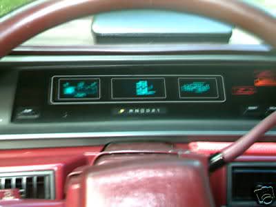

    That's pretty crazy awesome cool right there! If that's a factory set up, that HAS TO BE A UNICORN!!! Base digital cluster with column shift but HUD, WOW!!!

    Thank you! That would make sense then. I was like, hmm, never seen a 90 Cutlass sedan with HUD, that's interesting!

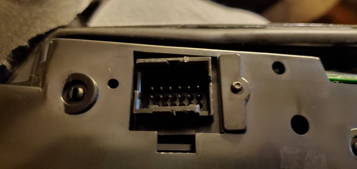

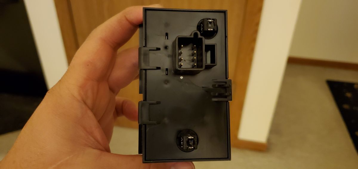

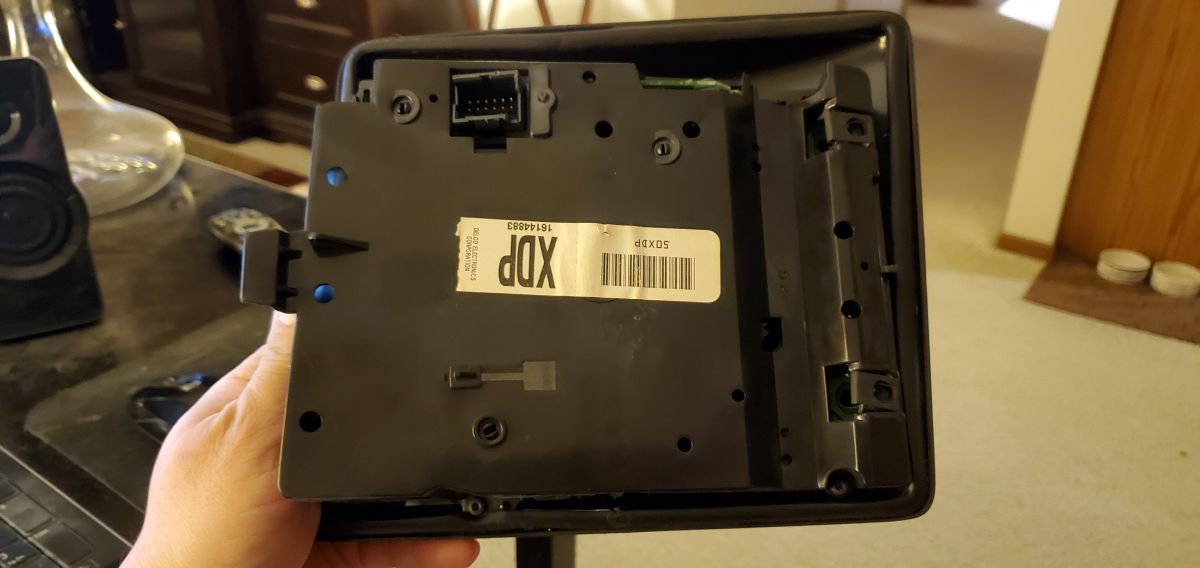

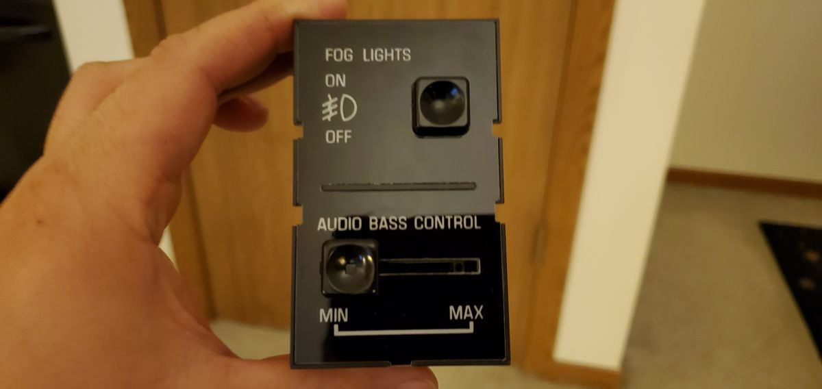

    I would strongly say no on the possibility of the fog light/audio bass control and HUD connector options. I have all these items and if you look at the female connector on the back of them, they take a large number of pin/block shaped male connectors. The HUD male connector/wiring will also be high up in the middle of the dash more in center with the digital dash because of the HUD location as well. K&R, if you look at the block shaped blue pin connector wrapped in white tape in your pic at the bottom, that would be the connector I bet for the fog light/audio base control switch. It has 8 pins and a single blade locater that matches up. I will look on the parts car tomorrow and see if I can help you figure out what that more slender connector is for.

    Thinking that might be the connecting wire for the heads up display
