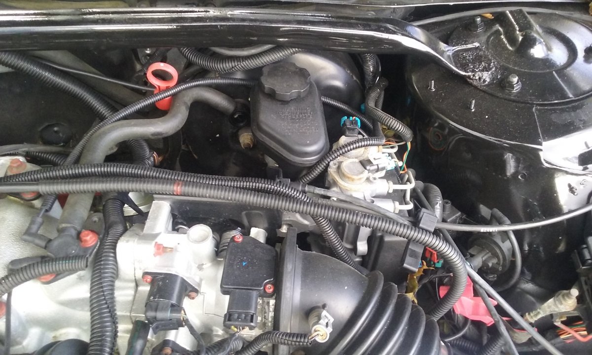

    ABS is certainly something one would see at a glance. This is my 96 and that masterpiece of crap hanging off the MC is the ABS pump and valve assembly.
