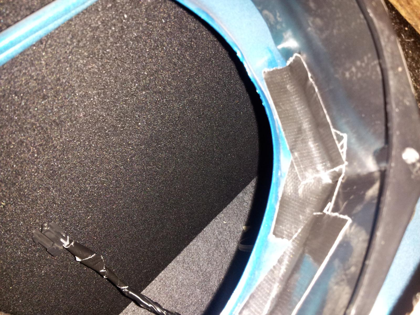

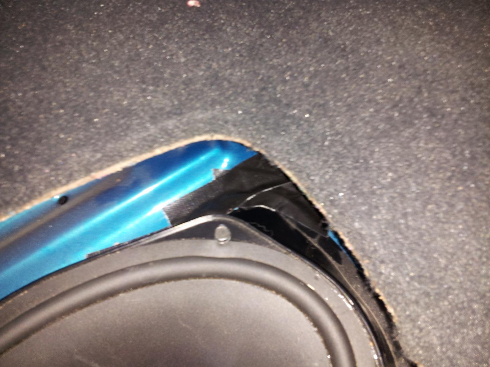

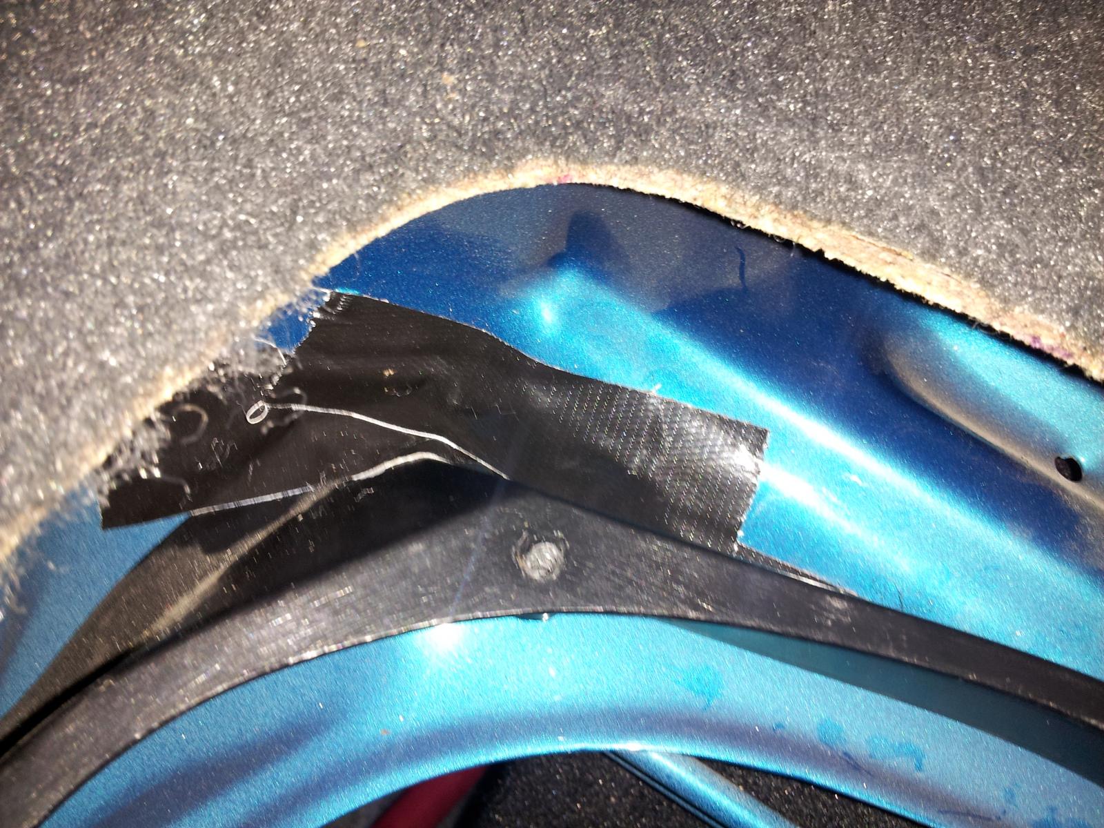

will_s95 Posted August 21, 2013 Report Posted August 21, 2013 Well, here's my finished up interior deadening job performed with a $2.50 roll of mini gorilla tape. This stuff is seriously sticky. I moved the 6x9 housings up and down and put tape where they moved. Now they don't move/rattle anymore. Who knows how long it will hold, but its worked for about 3 weeks. My bass actually sounds like bass again. Speaker in Speaker out Quote
