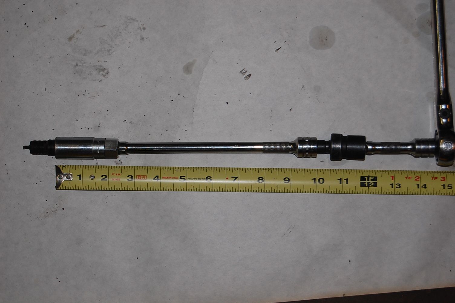

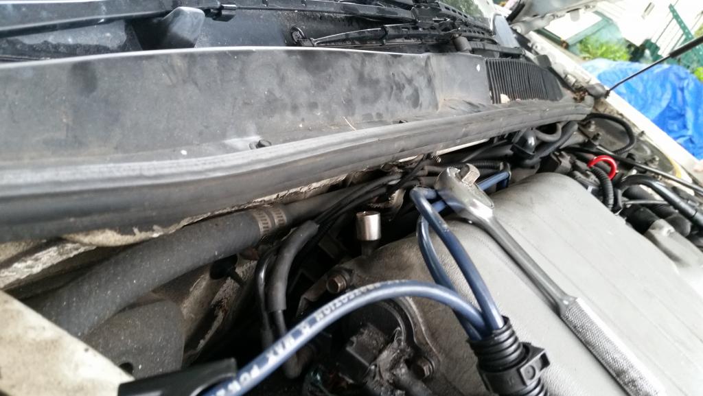

TpottsThe1 Posted September 13, 2017 Report Posted September 13, 2017 Since the above photos are photo bucket aka gone here is how I did it today one long extension one short with a swivel plug socket. Pull the wires off I just helped guide them with my end came right up except the middle one. Then pit my extension and swivel socket in without the ratchet then put on the ratchet. Got them loose. Removed the ratchet again turned them out by hand and reverse for re installation I use my hand to guide the wires back in. Super easy took about 10 minutes to change all the plugs. jiggity76 1 Quote

digitaloutsider Posted September 14, 2017 Report Posted September 14, 2017 I couldn't cut the car to change some plugs lol and I dint see a need to it was easy to change them with the swivel Cutting a hole was maybe the wrong term to use, you just bend/notch the lip underneath the weatherstripping to allow the extension to clear it. 94 olds vert and Psych0matt 2 Quote
Psych0matt Posted September 14, 2017 Author Report Posted September 14, 2017 I guess I never thought cutting that lip was easier, but that's just me TpottsThe1 1 Quote
94 olds vert Posted September 14, 2017 Report Posted September 14, 2017 After its cut, dropping an extension straight down is pretty nice. Psych0matt 1 Quote
Psych0matt Posted September 14, 2017 Author Report Posted September 14, 2017 After its cut, dropping an extension straight down is pretty nice. well right, i understand the concept, but I just never had an issue with it to feel the need to do it. 94 olds vert and TpottsThe1 2 Quote
Schurkey Posted September 14, 2017 Report Posted September 14, 2017 (edited) '92--'93 Lumina Euro 3.4. I drop this combination down the plug holes after removing the weatherstrip by the firewall. DIdn't grind clearance into the metal lip, just removed the rubber seal. I used to rock the engine. No more. No need. Edited May 20, 2025 by Schurkey jiggity76 and Psych0matt 2 Quote
