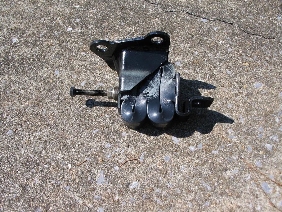

    Already a big difference and I can see why that step is crucial. 3/8 is apparently what fits in mine (possibly these were replaced in the past?) for anyone reading this in the future if you’re having difficulties. It’s also a good thing I picked up a second longer bolt as the shorter one only catches on one side, at least after being partially taken apart. One question I have is whether there’s an ideal height to compress them to in order to bang the lower fasteners. Hopefully will have them out before anyone sees this. I guess this piece of junk wasn’t seized, just stuck in place by the now compressed springs.

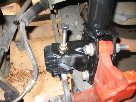

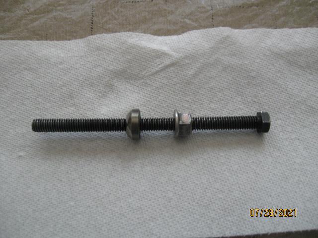

    Yep just a plain 4 door 96 Regal with no rear sway bar. Here is a picture of the bolt that I used to compress that rubber damper thing. I used a Chevy rocker arm ball instead of washers. The 10 x 1.5 mm fits so tight you can save yourself a lot of trouble and use the 3/8 x 16 threads per inch bolt.

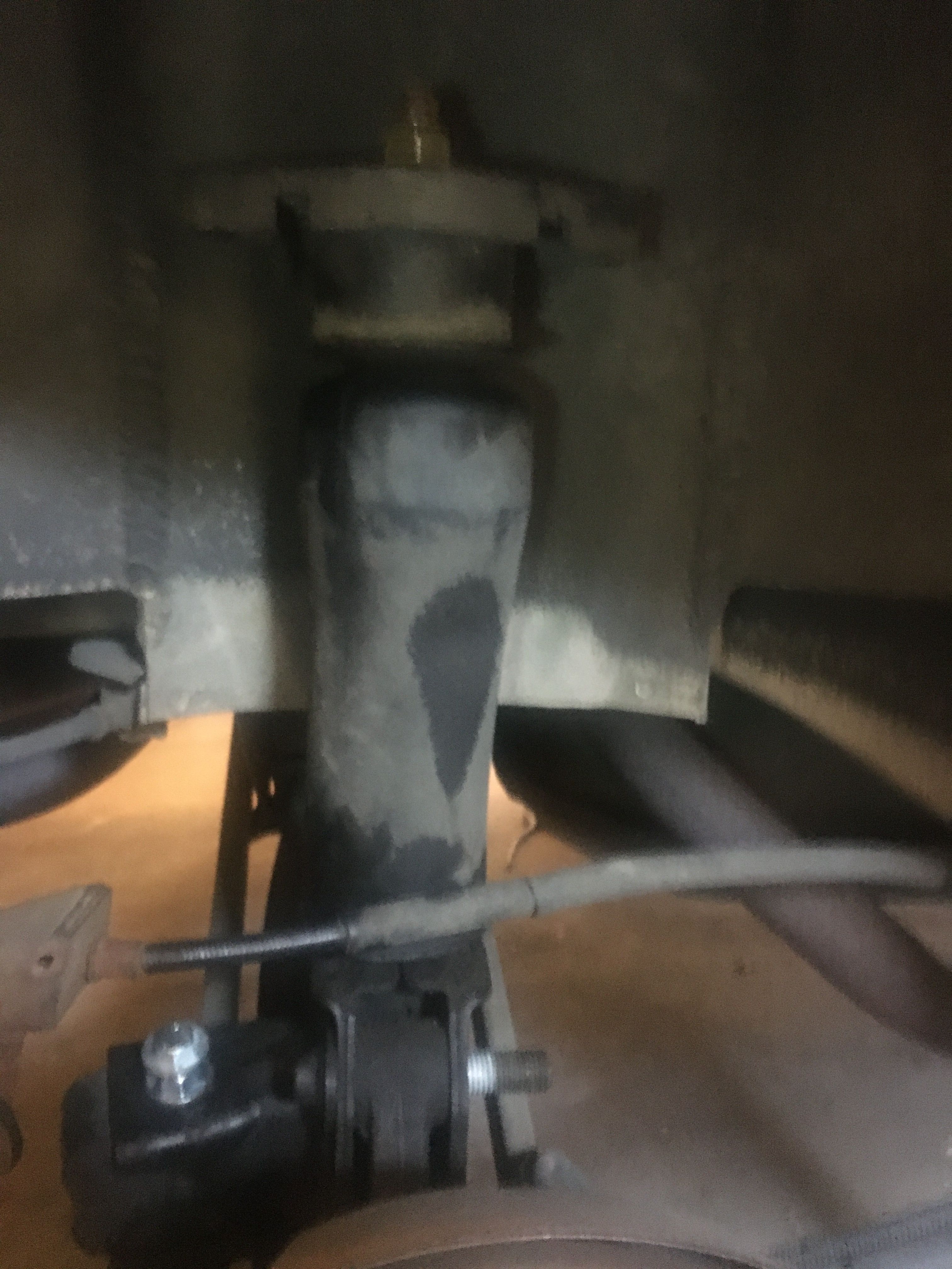

    I take it that your Regal has the FE1 suspension & does not have installed a rear stabilizer bar? As far as I remember those auxiliary dampeners were a poor mans anti-roll bar. They were there to add some anti roll capabilities to the rear suspension. When cornering the load on the outboard side of the car will cause the car to lean down & the opposite side would raise up, the dampener load increases when the rear inboard (body connection end) lateral link pivots upwards, and the reverse happens when the inboard lateral link end pivots downwards. They had nothing to do with maintaining the motionless ride height at all. In your photo I do not see the stabilizer bar, nor the end link that is mounted to the front side of the rear knuckle.

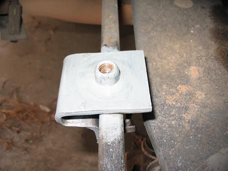

    The correct bolt should be a 10 x 1.5 mm (about) 6 inch long all thread bolt. Years ago when I did my rear struts I could only fins a 3/8 x 16 sae 6 inch bolt and it worked just fine. The bolt does not thread all the way through, see first picture. That arm does NOT have a hole in it under the bracket.
