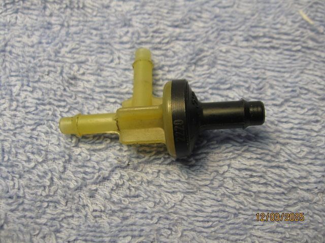

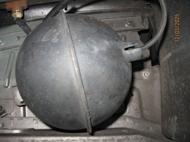

Have you checked the vacuum line that supplys vacuum to the HVAC vacuum switch behind the glove box? On my 96 Regal acid from the battery ate the plastic vacuum line that runs under the battery tray to the vacuum ball. The vacuum ball is under the battery tray up inside the fender. The plastic line that connects the vacuum ball to the vacuum "T" breaks and this causes all HVAC air to blow out of the defrost vents. When this happened to me I replaced the brittle plastic vacuum line under the battery tray with rubber vacuum hose.
