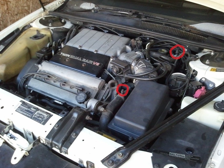

MemphisMan Posted May 19, 2019 Report Share Posted May 19, 2019 I was just thumbing thru these pics you uploaded when I noticed this.........the top of that bleeder valve is missing, it appears as tho it has been sheared off, there should be a hex head on the top of the brass valve one can open to bleed out the air. Great catch. Yeah, that thing is sheared for sure. Here is what it should look like:Sent from my iPhone using Tapatalk jiggity76 1 Quote Link to comment Share on other sites More sharing options...
jiggity76 Posted May 20, 2019 Author Report Share Posted May 20, 2019 14 hours ago, 55trucker said: I was just thumbing thru these pics you uploaded when I noticed this.........the top of that bleeder valve is missing, it appears as tho it has been sheared off, there should be a hex head on the top of the brass valve one can open to bleed out the air. 6 hours ago, MemphisMan said: Great catch. Yeah, that thing is sheared for sure. Here is what it should look like: Sent from my iPhone using Tapatalk Oh wow, thank you my friends! Are these specific for the LQ1's or will my parts car with the 3.1 work? Guess I can look tomorrow or maybe you guys know where I can get one. Are they readily available at parts stores? It's amazing how I'm sweating the little stuff like this to make this car correct and complete, lots of miscellaneous things either missing or wrong. Quote Link to comment Share on other sites More sharing options...
55trucker Posted May 20, 2019 Report Share Posted May 20, 2019 It's a general bleeder screw, you can find them on many GM vehicles where the rad filler spout is not the highest point of the cooling system. They are needed to bleed the air out of the system. jiggity76 1 Quote Link to comment Share on other sites More sharing options...
jiggity76 Posted May 20, 2019 Author Report Share Posted May 20, 2019 23 minutes ago, 55trucker said: It's a general bleeder screw, you can find them on many GM vehicles where the rad filler spout is not the highest point of the cooling system. They are needed to bleed the air out of the system. Ok, thank you. Hopefully the parts car will have it. Thanks for bringing it to my attention too. Quote Link to comment Share on other sites More sharing options...
MemphisMan Posted May 20, 2019 Report Share Posted May 20, 2019 17 hours ago, jiggity76 said: Ok, thank you. Hopefully the parts car will have it. Thanks for bringing it to my attention too. Your car has two of these bleeders. Both are circled below. It looks like the heater inlet hose one is good (the one closest to the firewall). jiggity76 1 Quote Link to comment Share on other sites More sharing options...
jiggity76 Posted May 20, 2019 Author Report Share Posted May 20, 2019 44 minutes ago, MemphisMan said: Your car has two of these bleeders. Both are circled below. It looks like the heater inlet hose one is good (the one closest to the firewall). Ok, thank you. It's cool that you can circle things in pics, very magically! I'm going to get it fixed soon, need to look at the parts car and if not there, then parts stores or junkyard. I'm glad I got rid of those grey wires in front. Red ones are so much better. Quote Link to comment Share on other sites More sharing options...

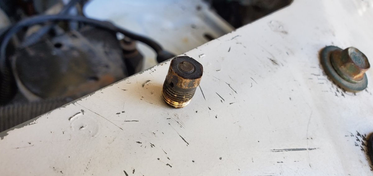

jiggity76 Posted May 26, 2019 Author Report Share Posted May 26, 2019 Bad one. It was definitely rounded off and missing the vent top piece entirely. Quote Link to comment Share on other sites More sharing options...

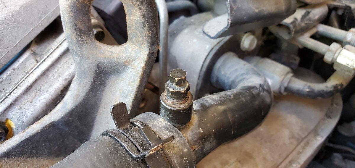

jiggity76 Posted May 26, 2019 Author Report Share Posted May 26, 2019 All fixed. Thank you 55 and Memphis! ManicMechanic and MemphisMan 2 Quote Link to comment Share on other sites More sharing options...
