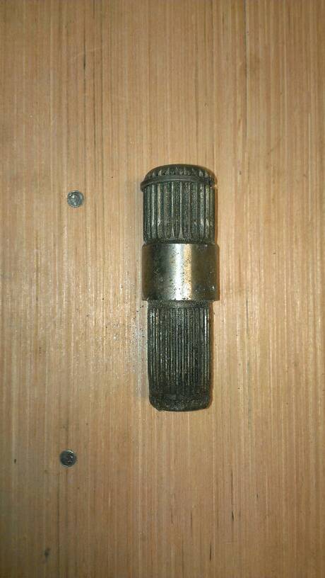

Bake82 158 Posted March 20, 2018 Report Share Posted March 20, 2018 Trans axles & Stub shaft(SUPER important) trans mounts intermediate shaft & bracket(doubles as rear engine mount) clutch master cylinder & Slave cylinder & line clutch & bolts flywheel & bolts shifter shifter bracket, bolts & clips into the floor(year they're different) Cables, and cable firewall gromnets clutch pedal & bolt & switches with pigtails clutch safety switch & pigtail console top & shifter boot PCM & Eprom(I'd just take the hole thing) There are so many little things but I think I covered all of them. according to Nunzi there is also a switch in the dash somewhere "Clutch anticipation" switch I think, but I don't know where it is. Quote Link to post Share on other sites

GTP091 89 Posted March 21, 2018 Author Report Share Posted March 21, 2018 thanks Chris, Im sure ill be asking you many questions on this in the future as the install gets underway. Really wish I could have done the tear out so i could see from the other side first.. the puller said there wasnt anything that seems like a 'stub shaft' on the car. it was just the cv axles themselves and the intermediate shaft. Am i missing something here? He's going back in tomorrow morning to get the pedals so i need to make sure he grabs the fire wall plate. If anyone has a picture of a stub shaft on its own that would be awesome. Quote Link to post Share on other sites
White93z34 1,489 Posted March 21, 2018 Report Share Posted March 21, 2018 The stub shaft is literally just a double ended job that goes into the differential on the 284 so you can snap an axle onto it, its drivers side only. Its about a 50/50 shot if it comes out with the axle or stays behind in the differential. I think I have one I can take a picture of. So basically on the driver side of the differential if you see a stub for the axle to slide onto you are good. and the Axles are the same part side to side so if one looks different it has the stub stuck in it still. As for the clutch switch (NOT the ignition lockout clutch switch). I had to look into that when I did a 282 swap on a TGP. From what I found the clutch switch was added for the 1992 model year to help drivability. It will keep the revs slightly up when the clutch pedal is pressed. I've driven enough with and without it to say its not the end of the world to not have it, its nice to have but not the end of the world. Not having it greatly simplifies the amount of wiring you have to do. If you don't have it its just a simple 2 wire switch that interrupts the cruise control that you could modify/wire in with ease. Now if you don't have it and you are running a calibration for a 1992/3 it will throw code 39 from time to time. Its a real shame you don't have the car in front of you. There are a absolute TON of little stupid parts that you'll need to properly execute the swap that no one grabs so they are basically unobtanium. And as far as the AIR pump goes. Its a bunch of parts and 100% unnecessary unless you need to pass California-Tier emissions tests and/or are just that anal-retentive ( I fall into the latter one here). Its an electric pump and special exhaust manifolds that you can feel to completely ignore if you want. also - about 90%+ of the pumps are totally shot at this point in time. If you heaven't already search my username. I think I have 4 different threads of 5 speed swaps I've done now all with pictures. Quote Link to post Share on other sites
jimmyfloyd 246 Posted March 21, 2018 Report Share Posted March 21, 2018 http://www.60degreev6.com/vb5/filedata/fetch?id=377478 This is the stub shaft Quote Link to post Share on other sites
GTP091 89 Posted March 21, 2018 Author Report Share Posted March 21, 2018 Thanks for the info Jimmy and Chris. Very helpful. As far as the stub shaft goes if the puller has cut the axles off at the boot to protect the splines and both tulips are still inserted into the trans the stub shaft should be there then. Quote Link to post Share on other sites
