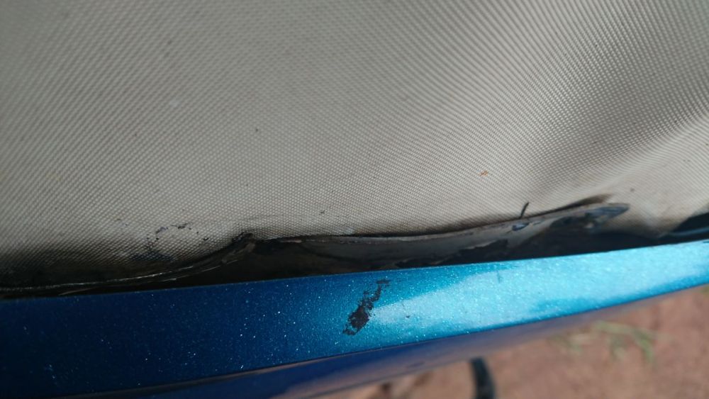

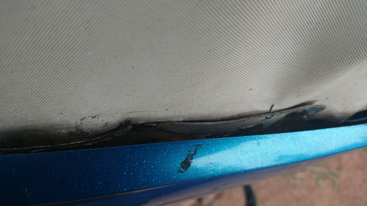

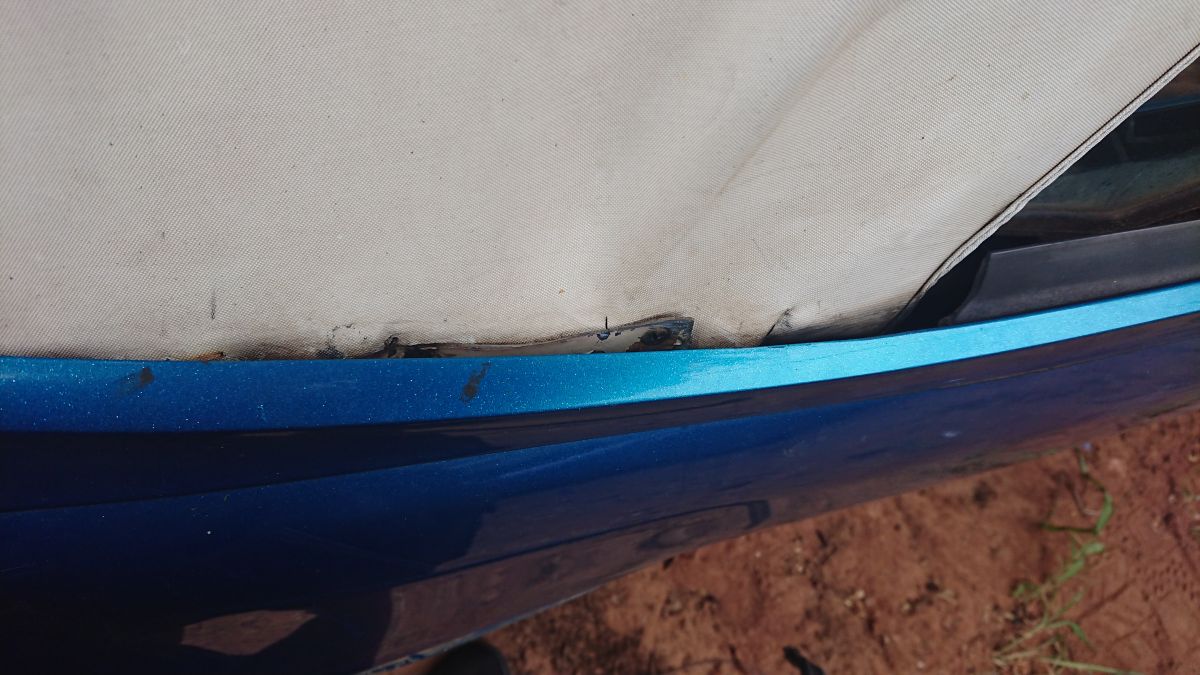

    My rear window is coming loose
    Hey guys. I apologize for not posting the pictures for the staples/tack strip reinforcement. I did travel to Botswana last December/January. Sad to say, I had an accident. But it wasn't a write off. I'll discuss it in my own thread. I took a couple of pictures to show the reinforcement, but I was so down, I didn't have the will to remove the plastic piece to expose the tack strip. It's an involved process that requires reaching inside behind the back seat to undo 3 screws. I just didn't have it in me. So, the pictures are not very clear, but I hope you can make out the metal strip under the plastic, enough to understand the concept. I have a strip at both c-pillars, and another by the 3rd brake light. Make sure the metal is filed/sanded smooth so it doesn't cut the top. Guys, I apologize for the delay, and for not removing the plastic covers to expose the tack strip. I didn't use stainless staples, and so they did rust. And I didn't apply the butyl sealant over top of the seam like I should have. So, reinforce the seam with metal strip, then add the butyl sealant, or whatever you choose to use to make the seam water tight. I hope this helps guys. Mabuza.
