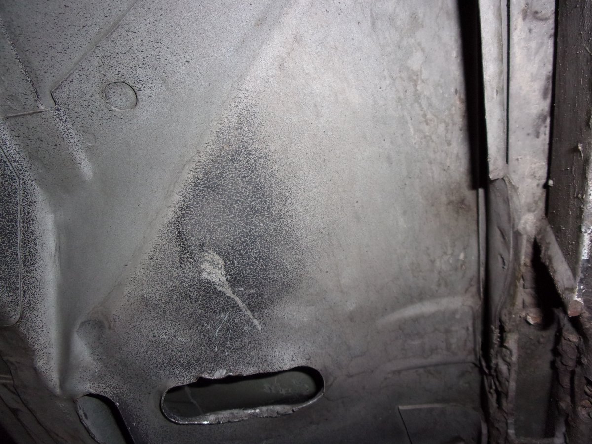

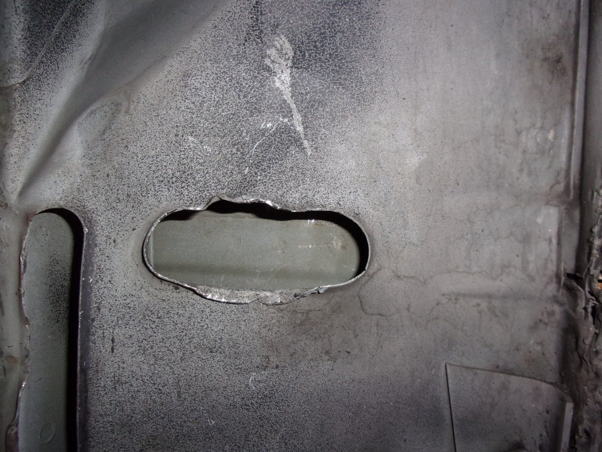

    'A' pillar supports
    When inspecting the underside of my 'vert', I've found that some incompetents' lifted the car incorrectly, and crushed the frame gussets under the floor pan. I straightened them out, as well as I can, and find that the car is much more stable, with less scuttle shake. If you have a convertible, I suggest you look into yours.
