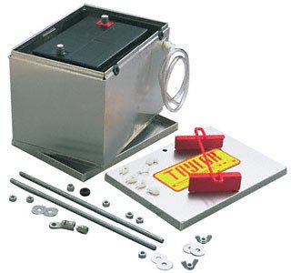

Imp558 Posted May 13, 2014 Report Share Posted May 13, 2014 So my datalog shows an IAT temp of 80 F on a 55 F day so I got a little pissed and decided it's time for my CAI! Got to have the battery out of the way so I broke down and ordered my relocation kit, I'll be sealing the top corners with silicone and putting weatherstripping on the top to seal it if it's not equipped. http://www.amazon.com/Taylor-Cable-48101-Aluminum-Battery/dp/B000CQ24AQ/ref=sr_1_8?ie=UTF8&qid=1399944502&sr=8-8&keywords=trunk+mount+battery Quote Link to comment Share on other sites More sharing options...

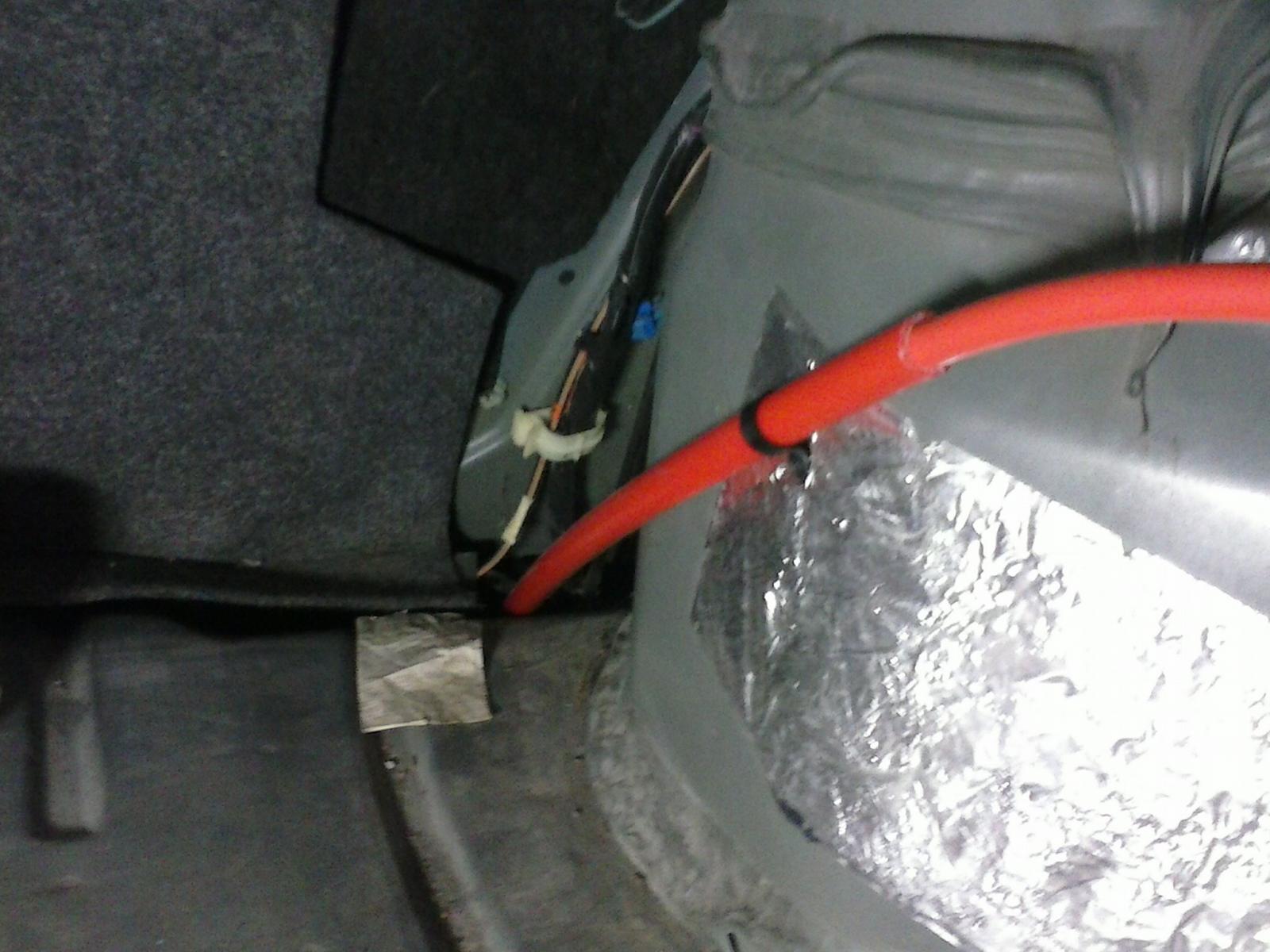

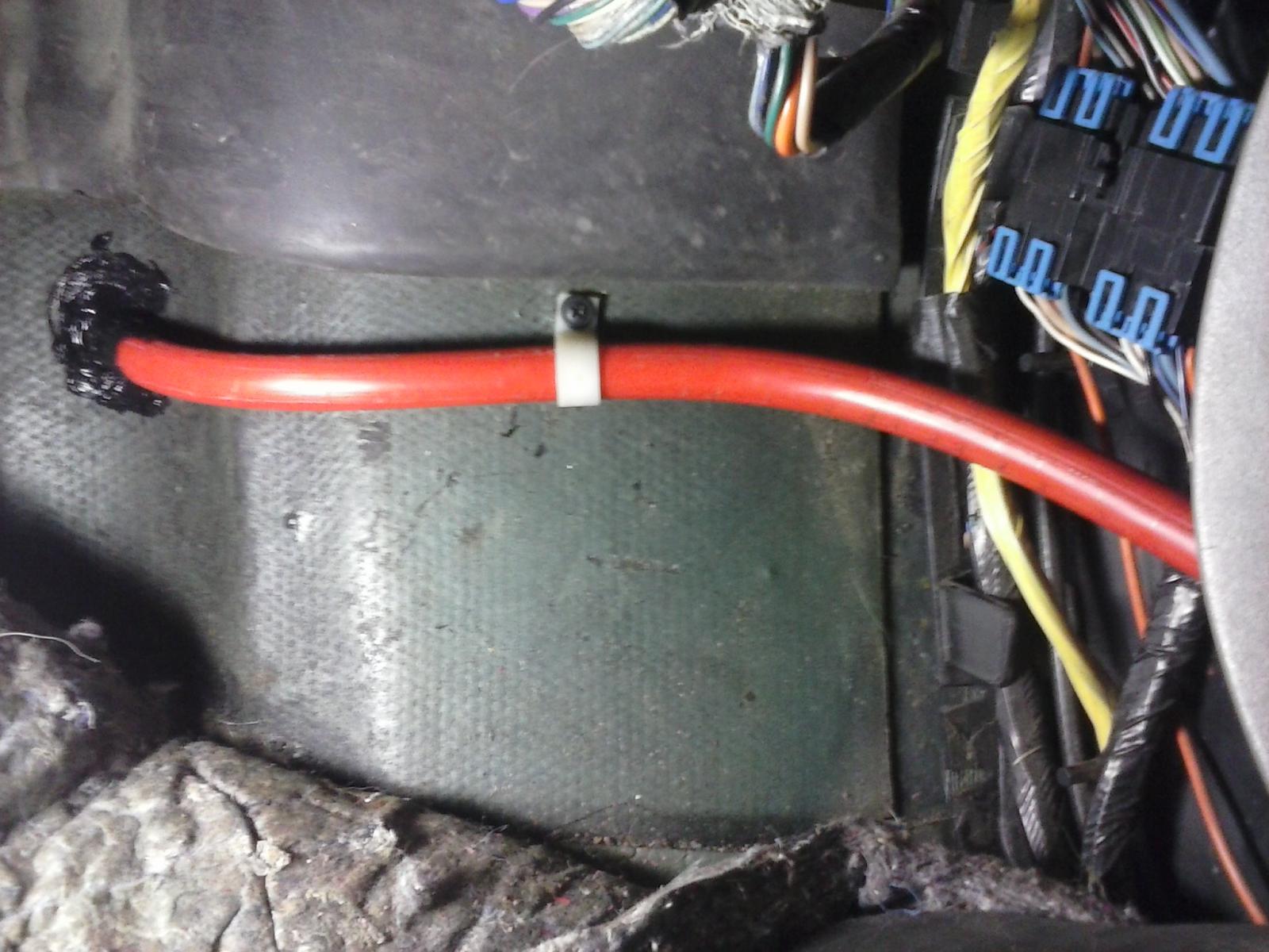

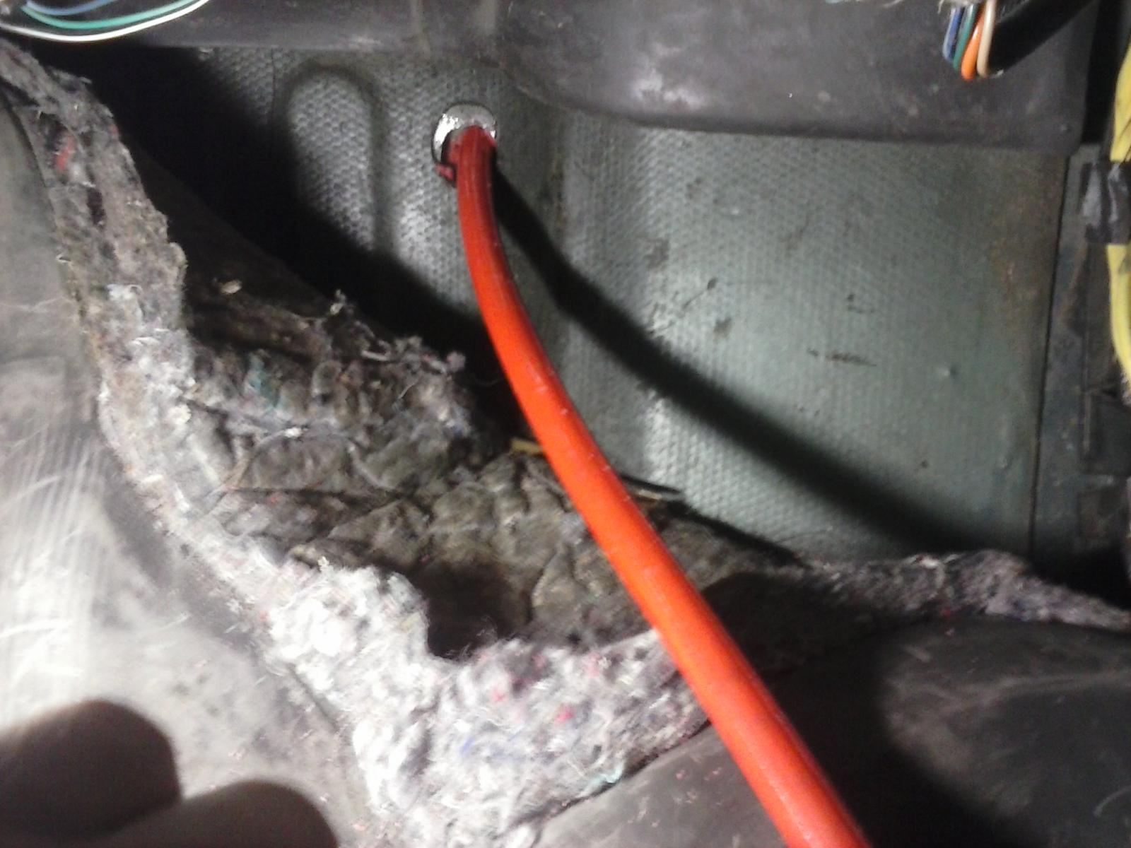

Imp558 Posted June 4, 2014 Report Share Posted June 4, 2014 So my relocation kit came and I've finally had a little time to work on it. I found that PEX tubing is a slip fit for the Taylor wire so I made a hole (not a pretty hole but the best I could do with the tools I had) through the floor in the front passenger side into the front box-like frame to run the tubing through up to the front of the car. I hit something and it beat me but a piece of 10 ga wire goes right through so I'll be trying again. This should turn out pretty cool, the box is HUGE though, almost big enough to fit 2 of our little batteries in. All in all the kit was a good price looking at the quality and all. There will be some silicone involved in sealing the corners of the box and likely a piece of weatherstripping inside the lid. Sorry no pics, I'll get some when it's done. Quote Link to comment Share on other sites More sharing options...
George Posted June 4, 2014 Report Share Posted June 4, 2014 (edited) What about using an AGM (Absorbed Glass Mat) battery such as an Optima, no leakage, no venting required and can be mounted in any position. Although the battery may be more expensive, the mounting should be cheaper. A better battery is always good, right? We use the Optima dual purpose starting/ deep cycle batteries as the battery back-up system for the tornado sirens in town. If you have made friends at an Autoparts store you should be able to get one for $180 or so. Edited June 5, 2014 by George Quote Link to comment Share on other sites More sharing options...

skitchin Posted June 5, 2014 Report Share Posted June 5, 2014 Yeah keep us posted! I'm curious what's different with my Camaro battery as they get a trunk mounted battery and aside from being under the spare wheel cover and a layer of carpet it's not really sealed off. Quote Link to comment Share on other sites More sharing options...
Imp558 Posted June 5, 2014 Report Share Posted June 5, 2014 I have friends with B-Series Honda engines who mount little Gel Cells and lawn tractor batteries in the trunk. That's crazy they put the Camero batteries in like that, there must be adequate ventelation somewhere. Quote Link to comment Share on other sites More sharing options...
runt Posted June 5, 2014 Report Share Posted June 5, 2014 The battery in my 2003 Bonneville was mounted under the rear seat and as far as I could tell there wasn't anything special about that battery. Quote Link to comment Share on other sites More sharing options...
Nas Escobar Posted June 5, 2014 Author Report Share Posted June 5, 2014 I have friends with B-Series Honda engines who mount little Gel Cells and lawn tractor batteries in the trunk.That's crazy they put the Camero batteries in like that, there must be adequate ventelation somewhere. It's actually pretty common to see this. Dodge Charger Dodge Magnum BMW Z4 Quote Link to comment Share on other sites More sharing options...
skitchin Posted June 5, 2014 Report Share Posted June 5, 2014 I guess the concern with ventilation is that the gasses are flammable if they are sealed in. Some people are saying that the trunk isn't air tight enough for that to be a major concern, but I got curious and started poking around the NHRA rules to get an idea on safety. All batteries must be securely mounted; must be of sufficientcapacity to start vehicle at any time. Batteries may not be relocated into the driver or passenger compartments. Rear firewall of .024-inch steel or .032-inch aluminum (including package tray) required when battery is relocated in trunk. In lieu of rear firewall, battery may be located in a sealed .024-inch steel, .032-in ch aluminum, or NHRA-accepted poly box. If sealed box is used in li eu of rear firewall, box may not be used to secure battery and must be vented outside of body. Relocated battery(s) must be fast ened to frame or frame structure with a minimum of two 3/8-inch-diam eter bolts. OEM located batteries without complete OEM hold-dow n hardware must be secured to OEM battery box/tray using the sa me 3/8-inch-diameter bolt hold-down method described in previou s sentence. (“J” hooks prohibited or must have open end welded shut.) Metal battery hold-down straps mandatory. Strapping tape prohibited. A maximum of two automobile batteries, or 150 pounds combined maximum weight (unless otherwise specified in Class Requirements), is permitted. Maximums may vary according to Class Requirements. Also worth mention MASTER CUTOFFMandatory on any car with a battery running 9.99 (*6.39) or quicker, any car exceeding 135 mph, or on any car where the battery is relocated into the trunk area. I guess the camaro passes that rule on the technicality of the word "relocated", since that is the stock battery location. But I still wonder about the lack of venting or being sealed from the driver's compartment. Quote Link to comment Share on other sites More sharing options...

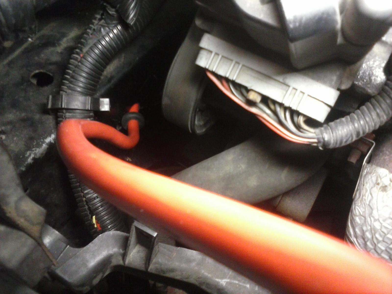

Imp558 Posted June 9, 2014 Report Share Posted June 9, 2014 It was a glorious day for the Empire! Running the PEX tubing went well once I cut it at a very sharp angle and worked it through. I made it all the way to the front past where the hole was and had to pull it back, then I cut the tubing inside the car since it was too fat to live nicely under the trim along the side. Once I got to the back there was a plastic conduit for existing wiring that took it under the rear seat and then more PEX into the trunk. I don't have words to describe what a BITCH it was getting the wire from inside the box portion of the frame and out that little hole, but it's really nice looking, almost factory. I'd guess you guys would be some of the few to spot it. I've got to get a battery tray for inside the box to hold the battery since I want to keep my nearly new side post, does anybody remember if our trays are bolted in or welded? Quote Link to comment Share on other sites More sharing options...

Imp558 Posted June 20, 2014 Report Share Posted June 20, 2014 Finished last night finally. It's worth saying that if you want to remove the factory battery cables from under the hood you'll need about 5' of 6GA wire. Some will feed an underhood electrical center from the post on the starter and the other will ground the engine to the frame. Quote Link to comment Share on other sites More sharing options...
skitchin Posted June 23, 2014 Report Share Posted June 23, 2014 Finished last night finally. It's worth saying that if you want to remove the factory battery cables from under the hood you'll need about 5' of 6GA wire. Some will feed an underhood electrical center from the post on the starter and the other will ground the engine to the frame. Battery relocate looked good! Forgot to ask, what gauge wire did you run from the battery to up front? Quote Link to comment Share on other sites More sharing options...
Imp558 Posted June 23, 2014 Report Share Posted June 23, 2014 Battery relocate looked good! Forgot to ask, what gauge wire did you run from the battery to up front? Thank you! I believe it is 2 gauge,It's just the stuff that comes in the kit but it was really nice wire to work with it's plenty of current for the starter. Quote Link to comment Share on other sites More sharing options...
