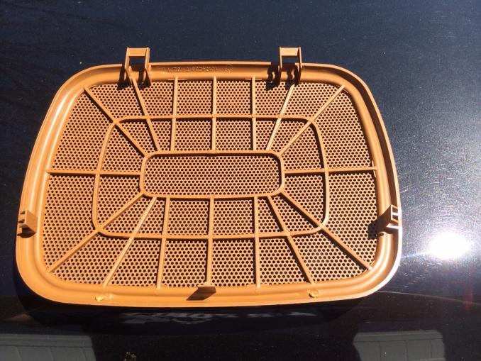

Heartbeat1991 Posted April 10, 2014 Report Posted April 10, 2014 I've done it through the grilles. Just be careful not to break the tabs off the grilles. I will post a couple pics in a few minutes so you can see how to get them out without breaking them. Quote

spiderw31 Posted April 11, 2014 Author Report Posted April 11, 2014 I think you could be able to pop the top part of the speaker cover out of the lower lip or surround plastic that is (semi)-permanently set into the cardboard parcel/speaker deck. Those GP rear decks of that generation look very similar to the one in my Cutlass. Also if you are not wanting to mess with the car seat take both to a baby store or to a local fire dept and have them install it. There should be a certified person at each to do that and they can show you how to do it as well. I used to be a supervisor at a Babies R Us and had to take a certification course to install them per DOT safety specs. If its the kind of seat with a base that remains in the car you might be able to leave it in as you only need to lift the back rest out of they way after you unbolt it. I'll give it a go to try and separate the grille halves. Hopefully that will make it a bit easier. As for the car seat, its not a matter of knowing how to do it, it's just a royal pain. It's a one piece front facing seat, and the dimensions are such that everything is just in the wrong place when you're trying to get the buckle latched into the car. A third arm that is attached backwards would make it easy! If it comes to it, it is still easier for me to do it than go drive someplace and wait for someone else to do it! Thanks for the pic Heartbeat! Knowing where the clips are will be helpful for sure. Quote
