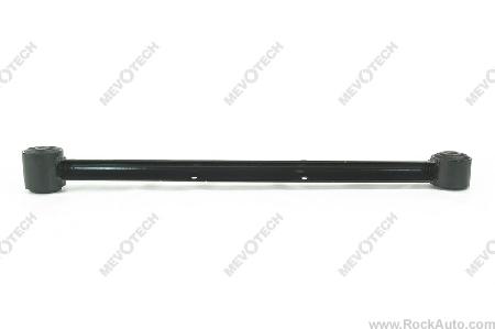

mikedunbar Posted October 16, 2012 Report Share Posted October 16, 2012 (edited) Any luck on the measurements? I'll be removing my rear subframe in the next couple of days, and would love to replace the rusty stamped laterals with tubular ones, too. You're keeping the transverse leaf spring too, right? Do you think these could be the right ones? Rock auto, twenty bucks each. And there's a cheaper one without a picture. They call them track arms, isn't that the same thing? Mevotech track bar mk6402 Here's the picture of the trailing arms:, part number dorman 90551. They don't look different to you? I'm probably wrong, but my car has those two holes in about the same place on the top pictures. I'll call and make sure I'm wrong tomorrow. Edited October 16, 2012 by mikedunbar Quote Link to comment Share on other sites More sharing options...
intern8tion9l Posted October 16, 2012 Report Share Posted October 16, 2012 those are the trailing arms; front to back, 1 on each side. the lateral links go from the subframe in the center of the car to the outsides, and there are 4 Quote Link to comment Share on other sites More sharing options...
mikedunbar Posted October 16, 2012 Report Share Posted October 16, 2012 Yeah, you're right. Darn. Quote Link to comment Share on other sites More sharing options...
