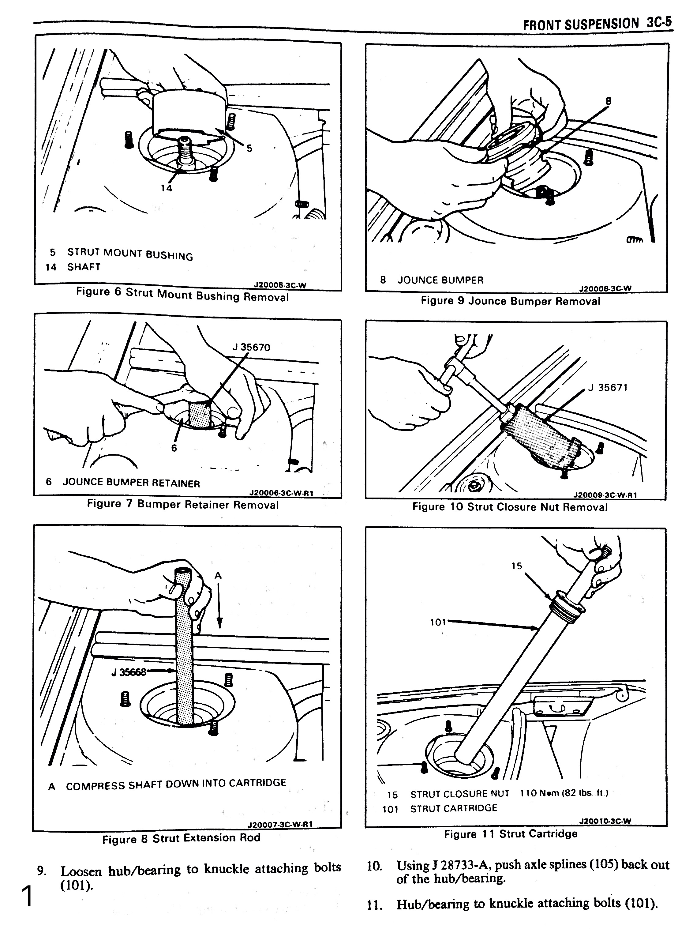

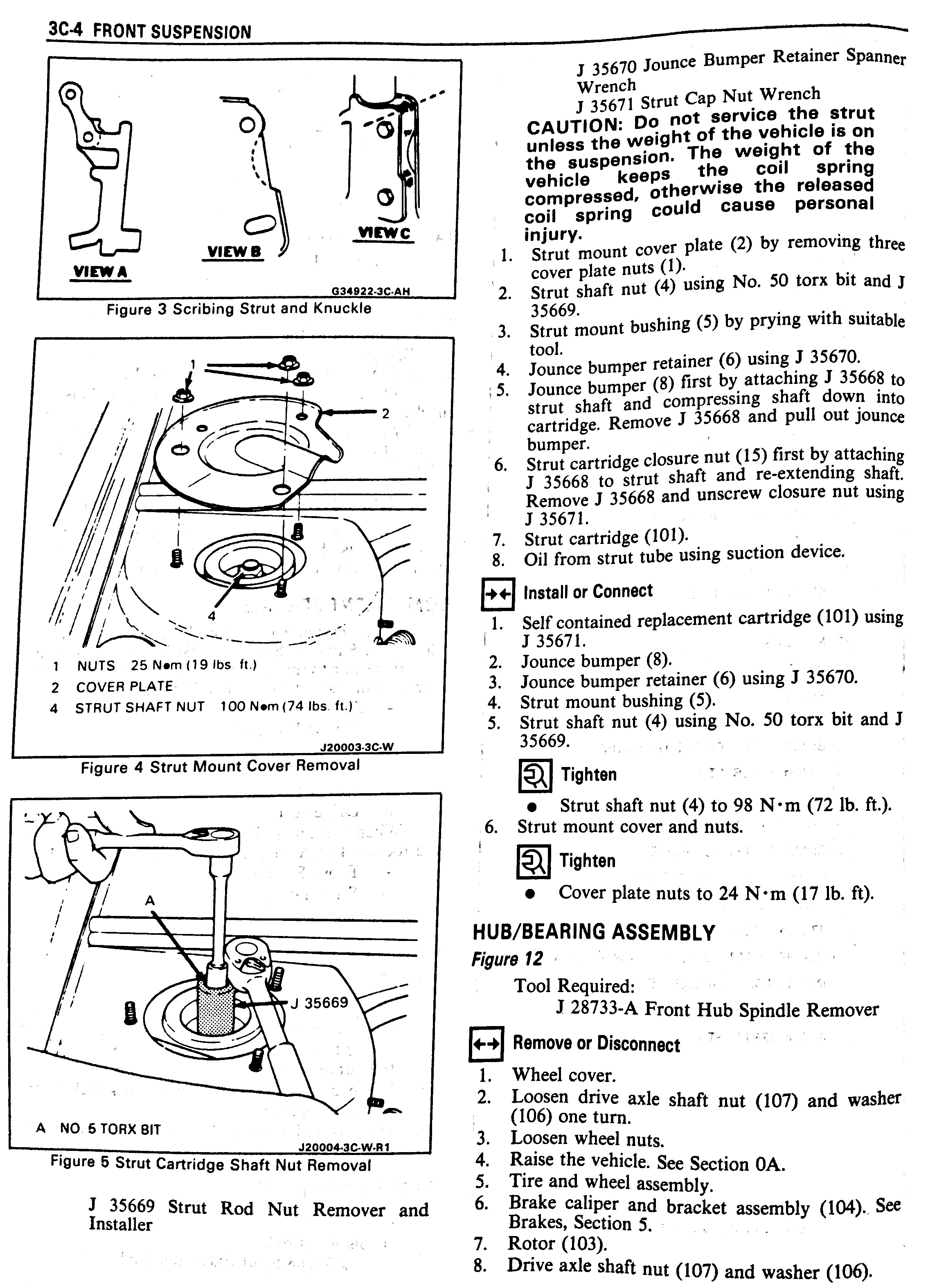

I have a 1989 Buick Regal Custom 2.8L V-6. This is my first time replacing the front strut cartridge myself. I just bought the tools on eBay. I need to know, when you remove the strut cartridge, the dealer shop manual says, oil from strut tube using suction device.
If the oil has to be removed how much oil has to be removed? Do you ever need to drain the oil with fresh oil? What type of oil do you use? Not motor oil? Sorry for the stupid questions, that’s my only issue I have replacing these. I want to know how much to keep in there and how much to remove. Here is the factory info from my Buick shop manual.

The OEM strut has loose oil inside.  You'd remove ALL of it to the best of your ability.
The replacement cartridge is a different design, that doesn't need oil inside the housing.
Remove the oil, drop the new cartridge into the housing, put it together just like the manual says.

Procedure #8 says - oil from strut tube using suction device.
 The service manual just forgot to put REMOVE OR DISCONECT at the top of that list.

Step #8 says remove the oil so i removed the oil when I replaced my cartridges.
 Do whatever you want I don't think it really matters.
  • Like 1
There ARE strut cartridges that when replaced, need some oil-bath.
Apparently, the W-body ones don't.  OR the service manual is wrong.  Can you get access to a later-model-year manual?

Ok well I found out from another post from 2019 this is what strut I have. The seat is fastened to the top of the knuckle assembly. That is why I can’t install the tool inside down into the strut tower to remove the strut closure nut that is supposed to remove the cartridge because the seat is covering any access to fit the cartridge tool down into the strut tower. Do I need to remove the whole strut assembly?
*The manual says do not service the strut unless the weight of the vehicle is on the suspension. But some shops have the wall mount spring compressors for that*
Seat on top of the knuckle.
actual knuckle that the cartridge fits into.
