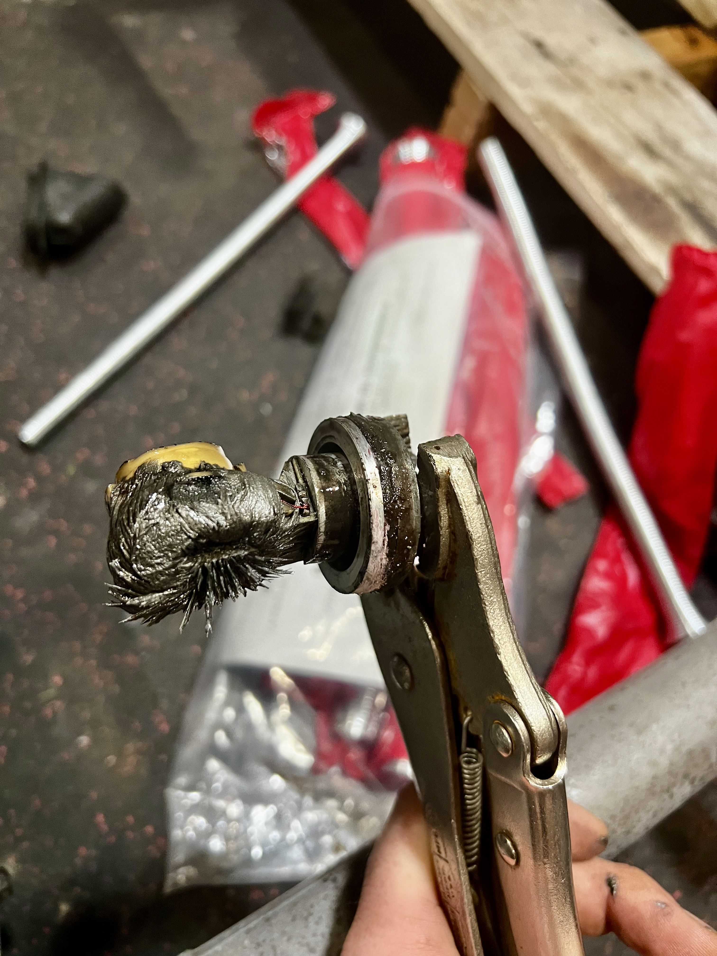

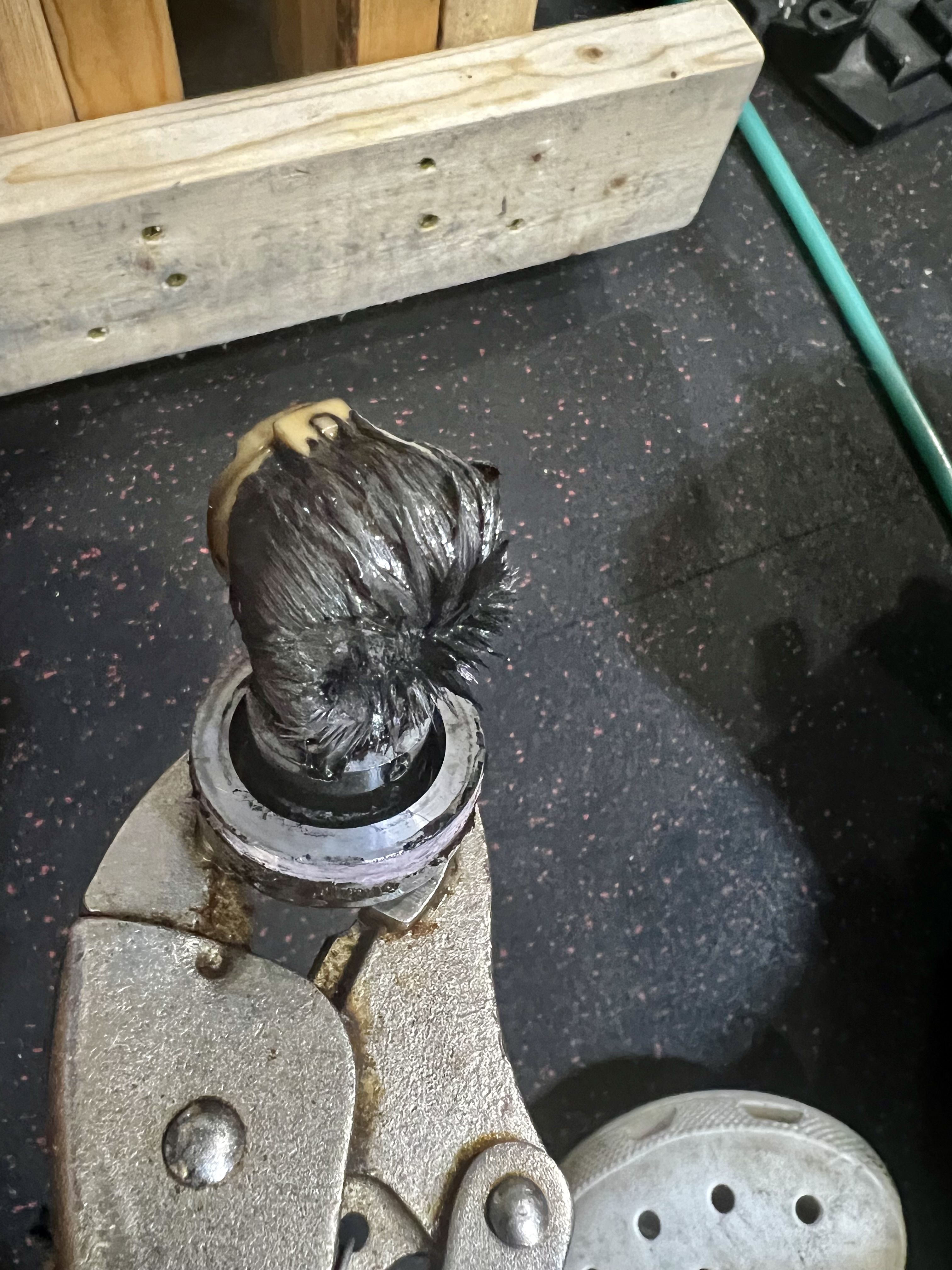

SuperBuick Posted September 29, 2024 Report Posted September 29, 2024 Posting here as this thread seems to have the best alignment to the info I have/am looking for. Pulled the speed sensor on my 284 today, and it looks like this. Is that a fatal sign or just normal wear and tear (it has 120k-ish miles). Given the speed sensor is a big magnet I’d expect it to collect errant metal shavings - the magnet on the drain plug for the transmission barely had any metal at all on it. Quote

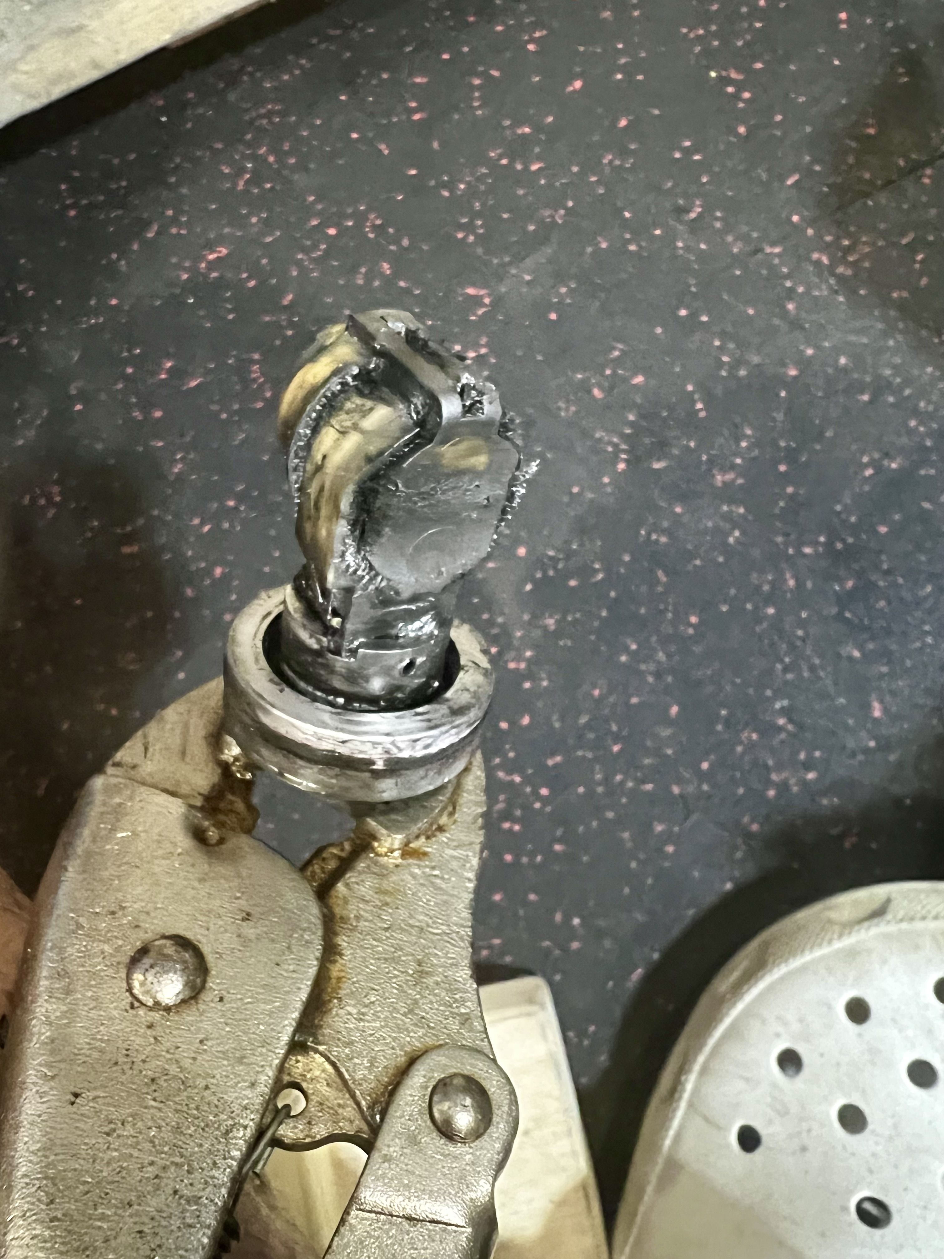

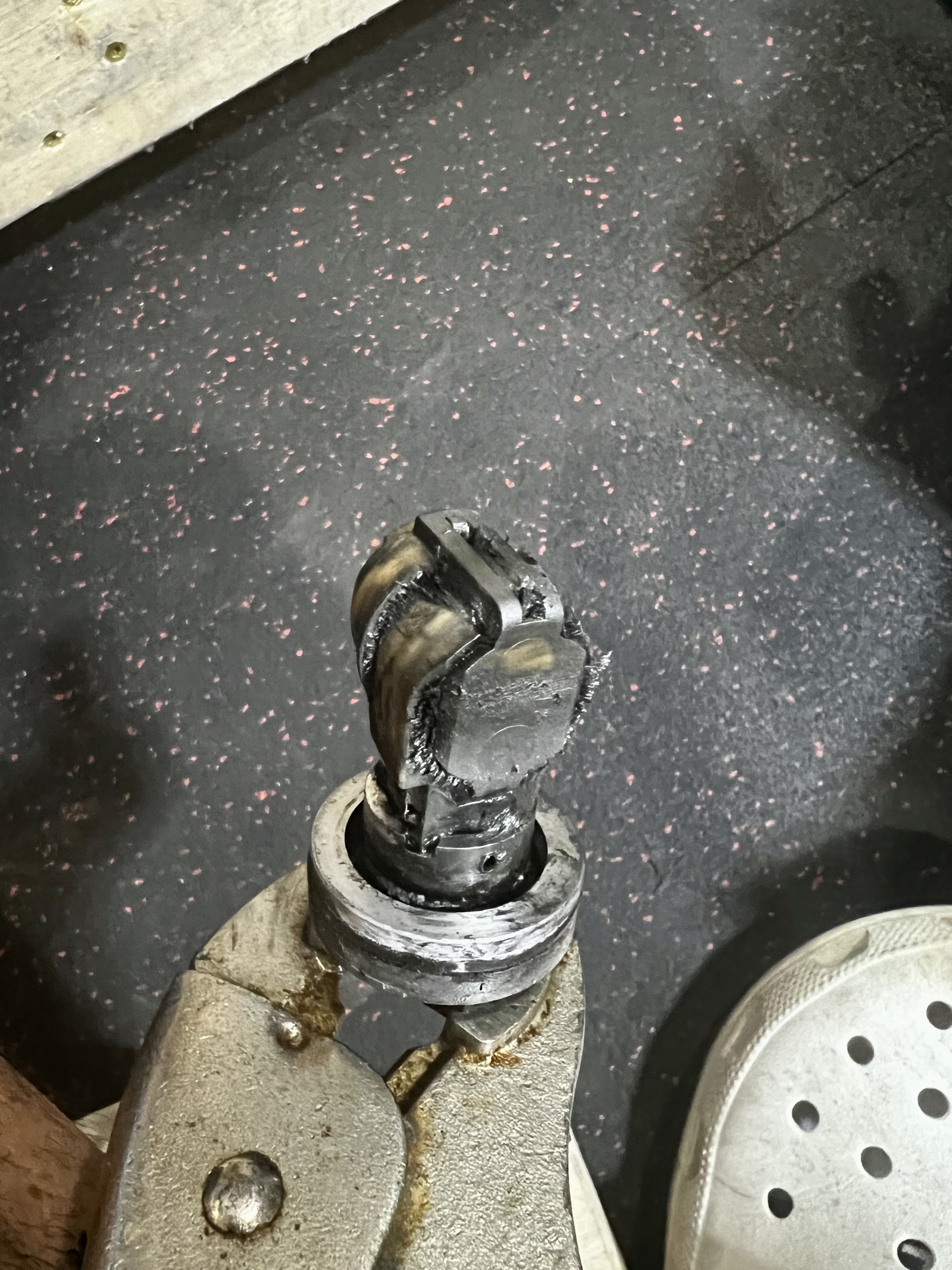

SuperBuick Posted September 29, 2024 Report Posted September 29, 2024 This is what the speed sensor looks like after I wiped it off: Quote
White93z34 Posted September 29, 2024 Report Posted September 29, 2024 Wow, that seems excessive. I would say thats probably "not normal" If it were me i'd stick a strong neodymium magnet on the drainplug. Amanita 1 Quote
