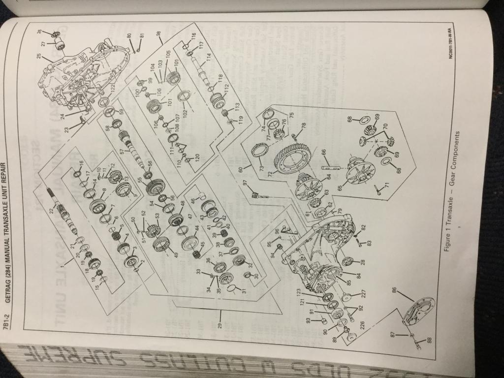

ss427 Posted April 15, 2018 Report Posted April 15, 2018 Here are some pictures out of the 92 Olds manual. Sorry about them being sideways. The manual has complete disassembly and reassembly instructions. All the J tools should be obtainable, with the exception of that assembly pallet, which I’ve never found or even seen in 10 years of looking. Not sure how crucial that is to doing the actual assembly. It looks like it holds all the gear clusters in position for installation into the case half. Mach 5 1 Quote
