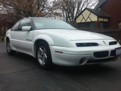

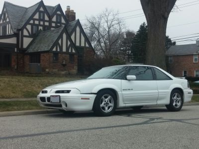

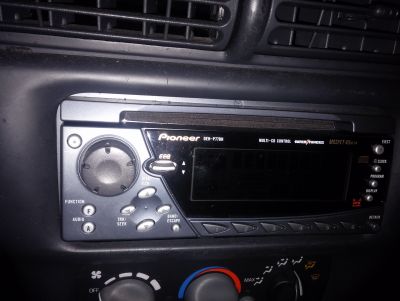

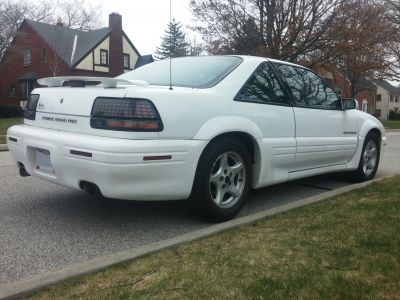

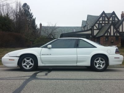

Calvinator Posted March 13, 2017 Report Posted March 13, 2017 Hello all -- New to me 1996 Grand Prix SE. I will fix this car up and my son will use for college. An experiment for me, too. How many miles can I get out of this car. Goal=200k. 3.1 motor. Auto trans. 102k miles. I live in Ohio. Florida car. Minimal rust. I see clean rockers, pinch welds, subframe, rear trailer arm connection! Clean, Dark gray cloth interior. Salvage title from hail storm. Good: Clean car. 1 year old rotors, pads, struts, front hub, 2 tires, New fuel pump and serpentine belt. AC works. Pioneer head unit. Looks to have nice specs and fitment. Bad: Hood hail damaged. 3 hail dings in front fenders. PO used duplicolor spray paint in a few spots. ABS light on. Windows and regulators kinda work. Needs inspection. I bought car and further inspected. Repairs so far: Transmission cooler lines rusted and leaking. Replaced. Changed transmission filter and fluid. Cooling system flushed (remove thermostat, fill and drain with distilled water 4 times), refilled with DEX 50/50, new thermostat, hoses, cap. Checked fans and they are working. Oil change to synthetic. Car is now running and driving. I plugged my Autoscan tool in and went for 2 hrs spirited driving. No codes and temp stayed between 170-190. Hot heat and cold A/C. No leaks I am experiencing "piston slap" when car is cold. Seems a common issue on 3.1 motors. I guess I keep the car maintained and live with it. Repairs in the next 2 weeks: Bad rear hub. Leaking gas filler. Windows and regulator. Interior light bulbs, some are out. Underside, door seams, inner fenders, and every nook and cranny will be oil sprayed with Fluid Film. Repairs in the next 2 months: I found and bought a NOS hood for $160! Body work on the front fender dings. Paint work on rear quarter. Front fascia needs to be attached. Replaced front door speakers with Kicker 41KSC54. Replace rear deck speakers with Kicker 41KSC6934. Trunk subwoofer. Kicker, not sure which one yet. Some vinyl graphics. I'm thinking a swoop on front fenders, or a rear quarter panel stripe. I saw a Gran Prix with Firebird on the hood, that was cool looking! I am thinking about a Firebird on the hood!!! Law says I needs a front license plate. I hate the offset look. Will related to center of front fascia. Not sure how that will look. The driver's door catch is annoying. It has 4 loud metal clunks sounds when opening and closing door. I can see the hinge is wore out, and lubing doesn't help. It will need to be replaced, but I am finding this part is NLA. Any suggestions? I scored some perfect Centerline Nitro 2 wheels on craigslist. They were on a 2002 Monte Carlo. 17x7. 5x115. 42MM offset. Polished Aluminum. WOW, are they light. Tire size calculators say 235/55R17 or 245/50R17 would be stock tire diameters and work with the 7" rim. I'm just starting research. Any thoughts or PICS on these sized tires for this style of car? Quote

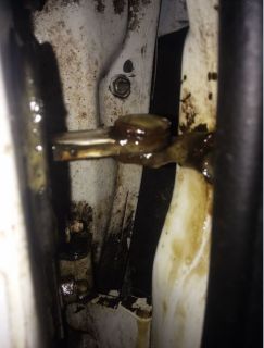

94 olds vert Posted March 13, 2017 Report Posted March 13, 2017 Welcome!Clean looking car. For the door hinge: remove the rubber grommit mounted into the door and see if the bolts holding the mechanism within the door are tight. MODIFICATION: get some 3/16th inch 1 inch diameter fender washers (Lowes and TSC have them) and place them between the bolt heads and the door to strengthen the door metal which can fatigue and break. Quote

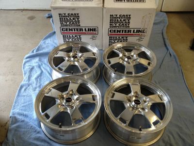

55trucker Posted March 13, 2017 Report Posted March 13, 2017 Doesn't seem to look bad from the phone pics you've supplied, how deep are the hail dings? You've found a hood so that would take care of those particular areas, like everything it's 20 yr old car, if you're going to use it a 365 day a year car consider protecting the bottomside, about those new wheels......they are a gen 2 design wheel? if so they may not fit the Gen 1 car, the hub/rim offset is not the issue, pull one of the oem wheels off & flip it over on it's back and compare the hub area of both wheels, Gen 1 wheels have a deep/thick hub flange and noticeable surrounding clearance so as to allow the backside of the spokes to clear the caliper that Gen 2 wheels will not. Quote
GOT2B GM Posted March 13, 2017 Report Posted March 13, 2017 Car looks good, welcome to the site. Those wheels may need spacers to clear the front caliper brackets. If you get a door check link from an earlier 1st gen W, they are less apt to make noise than the later ones. I want to say 88-90 model years. Car looks good, welcome to the site. Quote

Calvinator Posted March 14, 2017 Author Report Posted March 14, 2017 Thanks for the welcome and suggestions. a) I looked at that door check again, pulling off the rubber boot. Loose bolts. I cleaned up the half-pound of grease PO used to lube up the assembly. As suggested, I added a washer to both bolts, a drop of locktite, and tightened it all up. Coated the moving parts with Fluid Film and the door doesn't creak anymore! Thanks for that suggestion! The wheels I bought were from 2001 monte carlo, so I'll assume I will have a clearance issue. When I start the test fit next month, I'll plan on adding a spacer. The price was right on the wheels, if it doesn't work out I can sell them off. c) The fender hail dings are minor. My father in law owns a body shop and said no biggie to the fenders. But the hood had 20 dings in it. He said it would take a whole day to fix the hood hail damage. Alot of block sanding so the hood wasn't wavy looking. Luckily, we have a new hood awaiting in the garage. Styling update. I am going to paint the hood and trunk spolier Rat Rod satin black. Stealing that look from the Challengers and Chargers out there. I'll add a rear quarter panel strobe graphic too... Quote
