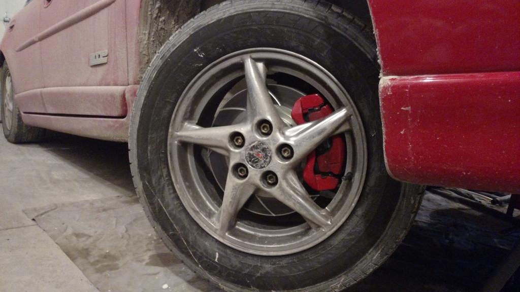

94 olds vert Posted April 1, 2017 Report Posted April 1, 2017 (edited) Here is my car. These brakes stop great. I was surprised at how well they bite. Edited April 1, 2017 by 94 olds vert Quote
Grandprix1 Posted April 1, 2017 Author Report Posted April 1, 2017 Those look like single piston. I'm glad to hear they stop great though. When the stock brakes are wet they suck. But when dry they aren't terrible as long as they don't get to hot or to cold Sent from my iPhone using Tapatalk Quote
94 olds vert Posted April 1, 2017 Report Posted April 1, 2017 Single piston with 12 inch rotors. I have dual pistons brakes ready to go. Just need to paint them, and bolt them on. Imp558 1 Quote
Grandprix1 Posted April 1, 2017 Author Report Posted April 1, 2017 Ah ok. Do you think the rotors look better then the 10" ones inside the wheel? Sent from my iPhone using Tapatalk Quote
94 olds vert Posted April 1, 2017 Report Posted April 1, 2017 The 12 inch rotors really fill out the rim. I don't really have a good comparison picture. Quote
Grandprix1 Posted April 1, 2017 Author Report Posted April 1, 2017 The 12 inch rotors really fill out the rim. I don't really have a good comparison picture.Nice that's kinda what I was hoping for. I bought the kit so it's got powder coated calipers. I'm only getting the rears just so everything matches Sent from my iPhone using Tapatalk 94 olds vert 1 Quote
