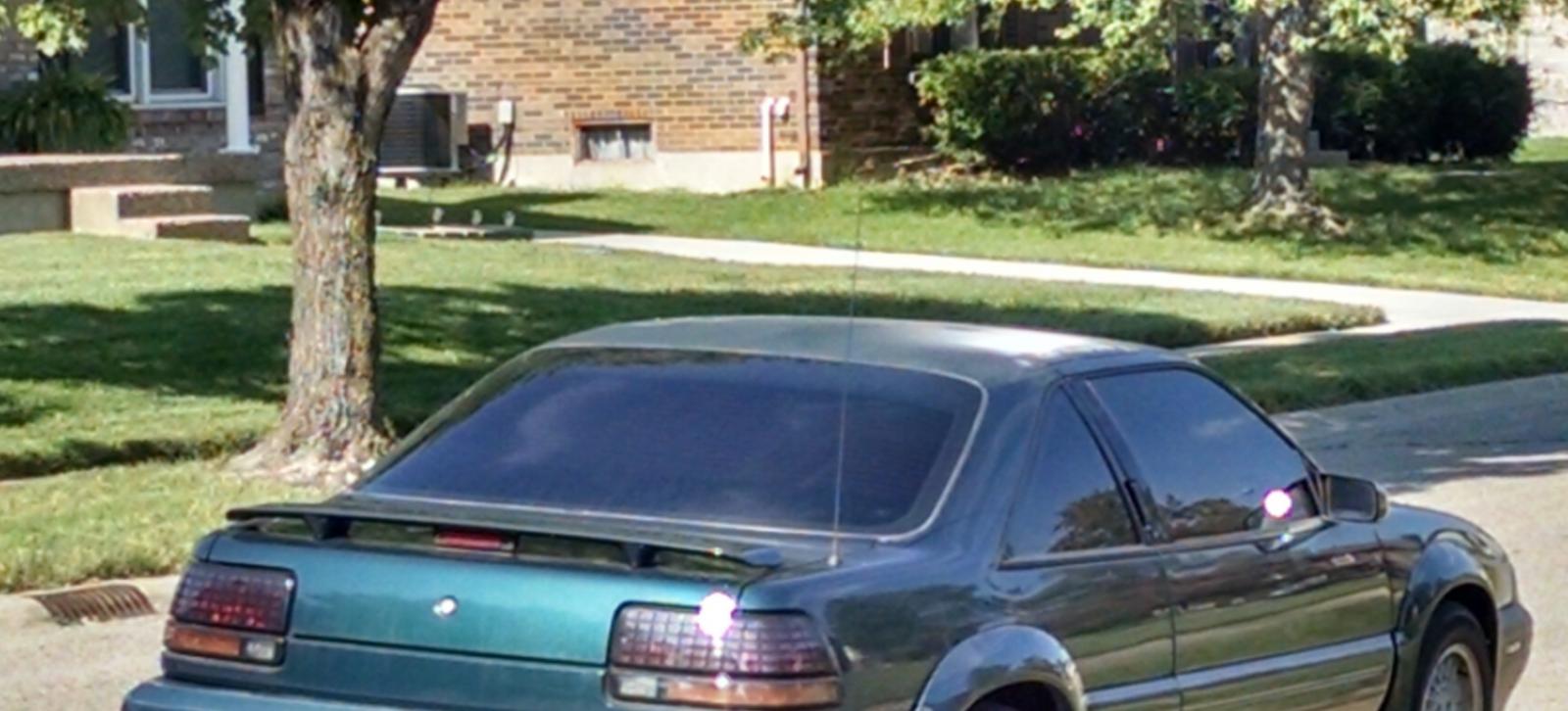

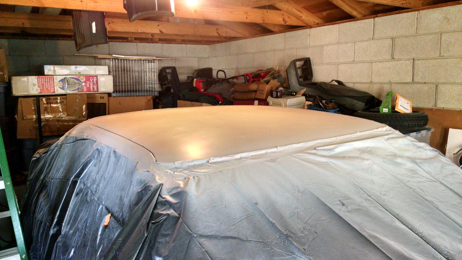

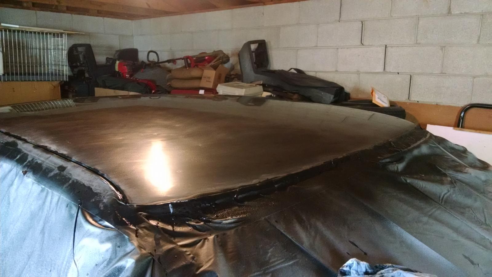

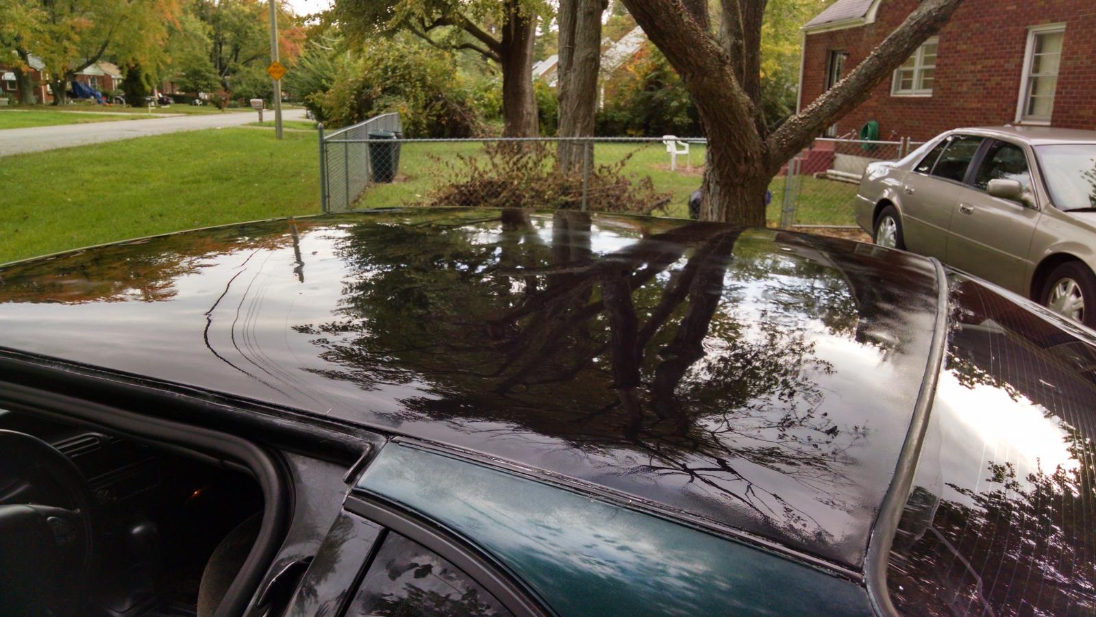

GaPrix Posted October 13, 2014 Report Posted October 13, 2014 So this is my third time spray painting something on a vehicle. My last project was the hood of my Jeep which came out decent and now the GP. I used rustoleum clean metal primer, flat black color and clear. I must have done something wrong in a couple spots I have some small cracks in the color that developed after sanding it...I couldn't reach the center of the roof very well, sanding there became difficult. Which left speckle/orange peel towards the center roof area and along the edge line (I got tired/lazy). Everything was done by hand which is very tiring. I also made a rather big mistake as I did not mask off the weatherstripping along the door/roof...whoops. Two flakes of old stripped paint flew up from in the weatherstripping, couldn't sand it out without burning through primer, so I decided to leave it. Turned out decent for a rattle can job took about 2hrs a day start week. I'm going to repaint the hood/louvers in a few weeks which should be easier as I don't have to tape off as much, though I don't know how to go about painting the louvers, yet. I'm guessing plastic paint? Quote
94 olds vert Posted October 13, 2014 Report Posted October 13, 2014 Looks good enough. As for the louvers paint with plastic paint. They are just held on with screws from the inside of the hood. Would be a lot easier to paint with them off the vehicle. Quote
carkhz316 Posted October 13, 2014 Report Posted October 13, 2014 The last pic makes it all look pretty decent. Also, you don't need to sand the color, and really shouldn't ever. You're only and always going to end up with any and all orange peel in the last coats of clear. Its a waste of time to do any type of color sanding. Quote
