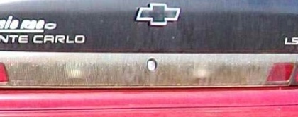

Michael Savage Posted August 25, 2014 Report Posted August 25, 2014 I replaced every bulb in and on my car the other day. I noticed the 2 white bulbs 3067s I believe on the Plastic Piece on the trunk between the Tail Lights aren't lighting up ever. I was wondering if they're supposed to light up or what to check to find out why they aren't working. Sent from my iPhone using Tapatalk Quote
RobertISaar Posted August 25, 2014 Report Posted August 25, 2014 http://upload.wikimedia.org/wikipedia/commons/b/b8/95-99_Monte_Carlo_LS.jpg i'd need to look again to be certain, but i'm almost 100% that there are no brake lamps in the center section, those are just reflectors. the only bulbs in the center should be the reverse lamps. Quote
LuminaPower92 Posted August 25, 2014 Report Posted August 25, 2014 Rob I'm 99.99% sure your right and agree with you. I was thinking the same thing but questioned myself. I think lumina panels are the same as well. Quote
Michael Savage Posted August 25, 2014 Author Report Posted August 25, 2014 Autozone said brake lights lol I'll see if they come on in reverse! Didn't think about that. Thanks. Sent from my iPhone using Tapatalk Quote
carkhz316 Posted August 25, 2014 Report Posted August 25, 2014 There is nothing on the trunk lid besides the reverse lights. The small squares are most certainly just reflectors Quote
Nas Escobar Posted August 26, 2014 Report Posted August 26, 2014 The Luminas had marker lights on the trunk but not brake lights. Monte Carlos were just reverse lights. Sent from my HTC Sensation using Tapatalk Quote
carkhz316 Posted August 26, 2014 Report Posted August 26, 2014 The Luminas had marker lights on the trunk but not brake lights. Monte Carlos were just reverse lights. Sent from my HTC Sensation using Tapatalk I don't know enough about the 1.5 gen Lumina's to refute this, but I have never seen them illuminated. If you can, I'd like to see a pic, but none around where I live have ever been working, if they are indeed markers. Quote
Nas Escobar Posted August 26, 2014 Report Posted August 26, 2014 I don't know enough about the 1.5 gen Lumina's to refute this, but I have never seen them illuminated. If you can, I'd like to see a pic, but none around where I live have ever been working, if they are indeed markers. My bad they weren't. They're just big reflectors. I thought I saw one with lights but I may be thinking another car. Sent from my HTC Sensation using Tapatalk Quote
carkhz316 Posted August 26, 2014 Report Posted August 26, 2014 My bad they weren't. They're just big reflectors. I thought I saw one with lights but I may be thinking another car. Sent from my HTC Sensation using Tapatalk I've actually wanted for some time to install a light behind the trunk reflectors on the Monte to function as a turn and/ or brake light. So far, nothing has happened Quote
Michael Savage Posted August 26, 2014 Author Report Posted August 26, 2014 The red reflectors don't illuminate, they're just normal reflectors unlike the side markers. There as 2 white light casings on both sides of the Lock. Those have lights, but Autozone misinformed me that they we're brake lights and not reverse lights. I have the 95 model and there is no socket for the reflectors. Sent from my iPhone using Tapatalk Quote
