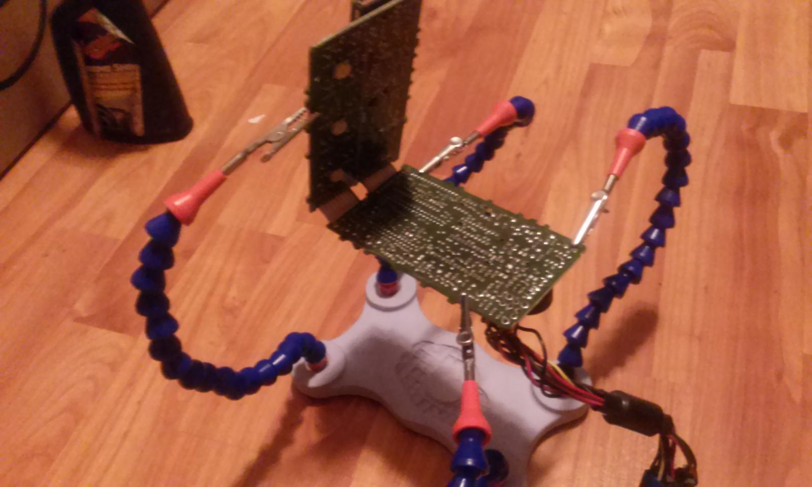

Drummer Posted April 25, 2014 Author Report Posted April 25, 2014 So getting the most current prom version would require me unsoldering the current prom and soldering in an updated one? Quote
RobertISaar Posted April 25, 2014 Report Posted April 25, 2014 that is how i would do it..... i would actually pull the existing one, read off the BIN, solder down a dual-wipe socket in place of the PROM, then either erase/program the existing unit(if you had the equipment to do so) or get a compatible EEPROM and load whatever BIN onto it. Quote

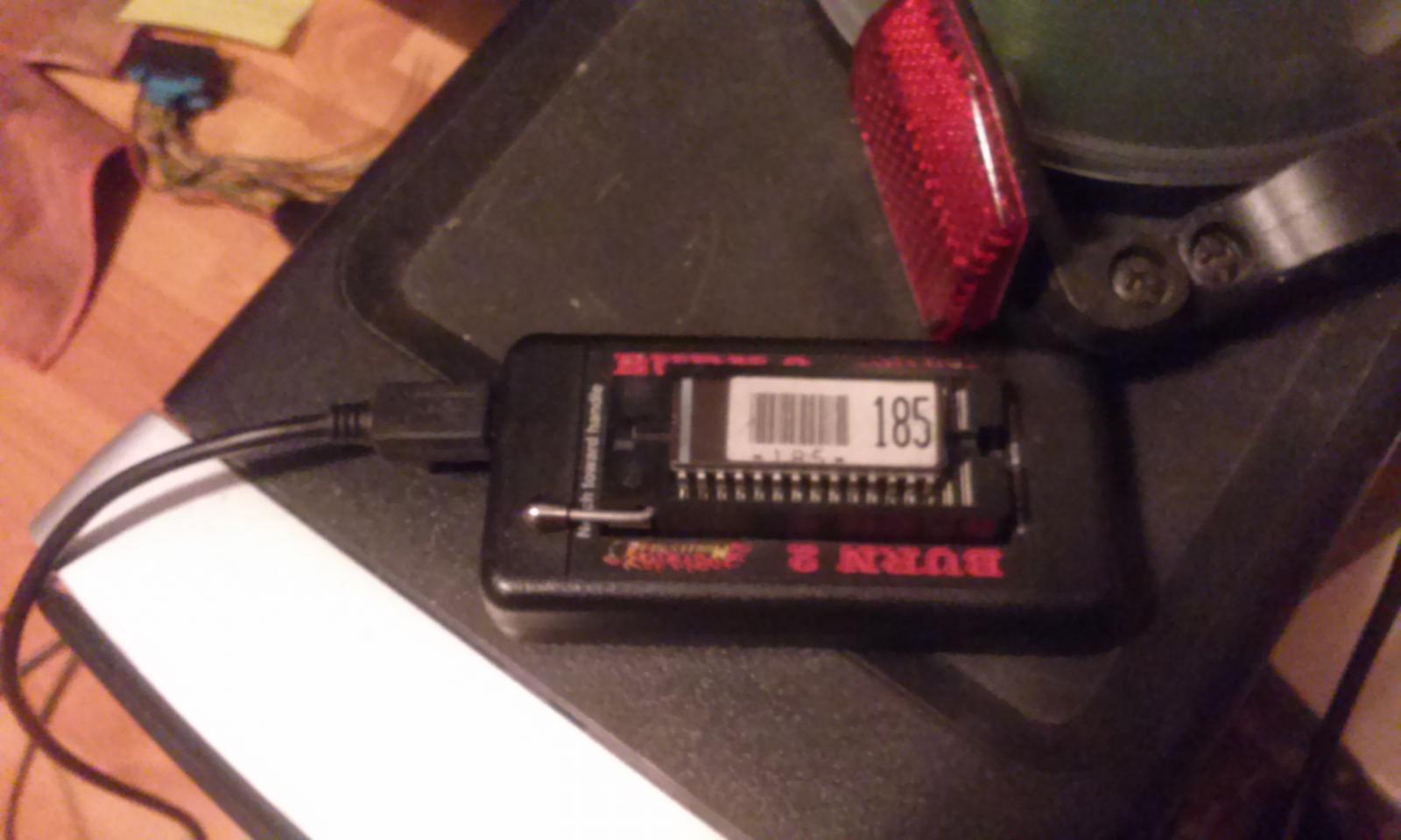

Drummer Posted August 20, 2014 Author Report Posted August 20, 2014 A little update:... I was able to pull the current chip off the board with a little help and read the bin file. Saar how exactly do I send it to you? Quote
RobertISaar Posted August 20, 2014 Report Posted August 20, 2014 ....you didn't read it like that, did you? i seem to remember needing the PROM to be as far down(right in that picture) as possible for the BURN2 to read it correctly. email would work great, just @yahoo.com to my username. Quote
