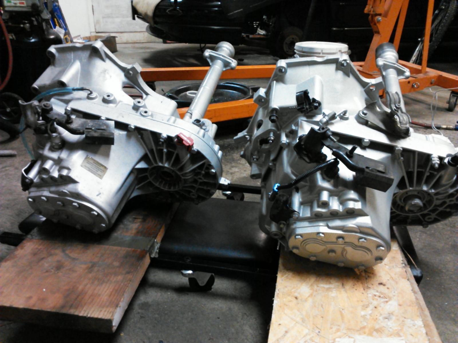

Well, I ripped the monster out of the car this weekend to swap the trans and attend to a coolant leak. Firstly, I'm pretty sure the input bearing on the first trans has been bad from the start as it growls/ grinds while idling and instantly goes away when I push the clutch in. The fluid also turns gray in no time, and the 4th synchro is bad as it grinds under moderate and more throttle. Number 1 is on the left. Number 2 (100K miles as per the JY) on the right. Ya, I obsessively scrubbed it clean and rattled canned it with the high-temp cast aluminum color paint. Also, "new" trans is a reman from Getrag as indicated on the tag on the bottom, so one would infer that the trans has less than 100K miles actual on it.

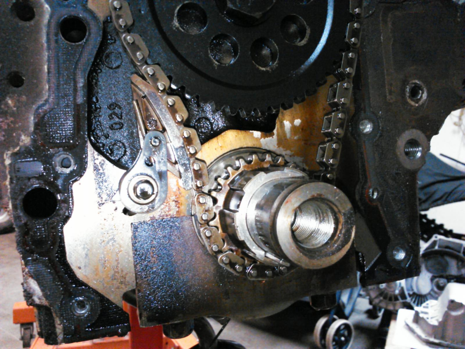

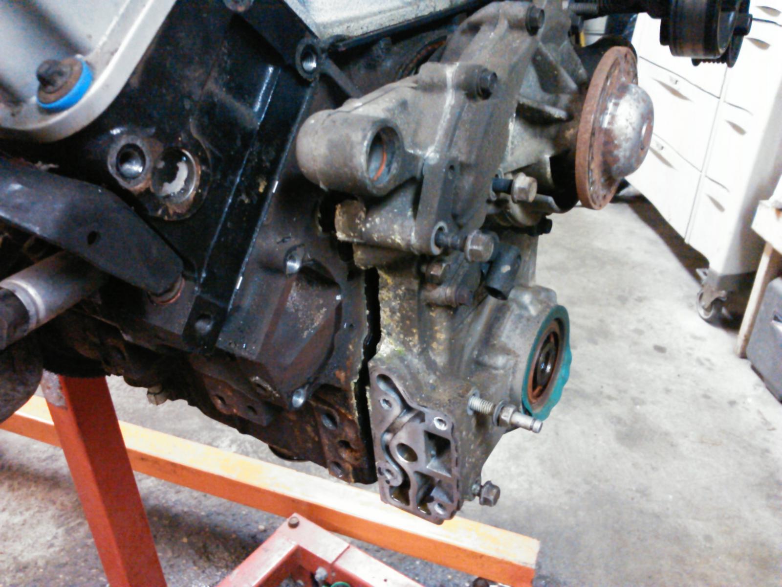

Secondly, I have had coolant mixing in the oil. While not a milkshake, it has been clouding the oil and my coolant has dropped. I thought that I messed up something on the rear timing cover when I serviced it last summer, but that side was dry. Only upon pulling the oil pan did I discover the front side was really cleaner than normal. As you can see in the second pic and third pic, It has been washed down with coolant somewhat. The weird thing is that the gasket was intact by all appearances, so I'm not sure what the deal is. The inside of the front timing cover has been washed clean from the oil pan to about the cam area. I'm thinking it has to be one of the main cooling jackets. It's just that it wasn't very evident from the gasket. The only thing I could see is that the orange anaerobic sealing bead on the gasket doesn't make a complete loop around the cooling ports. Oh well, I'm just glad I caught it in time. I also ordered a new timing chain dampener as it had a nice wear groove worn in it. The chain and gears look fine though. There is minimal tooth wear, so I'm going to leave them for now.
