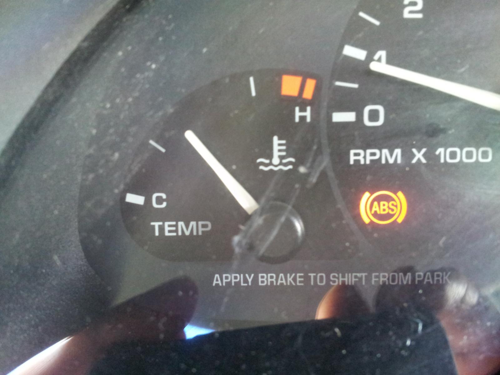

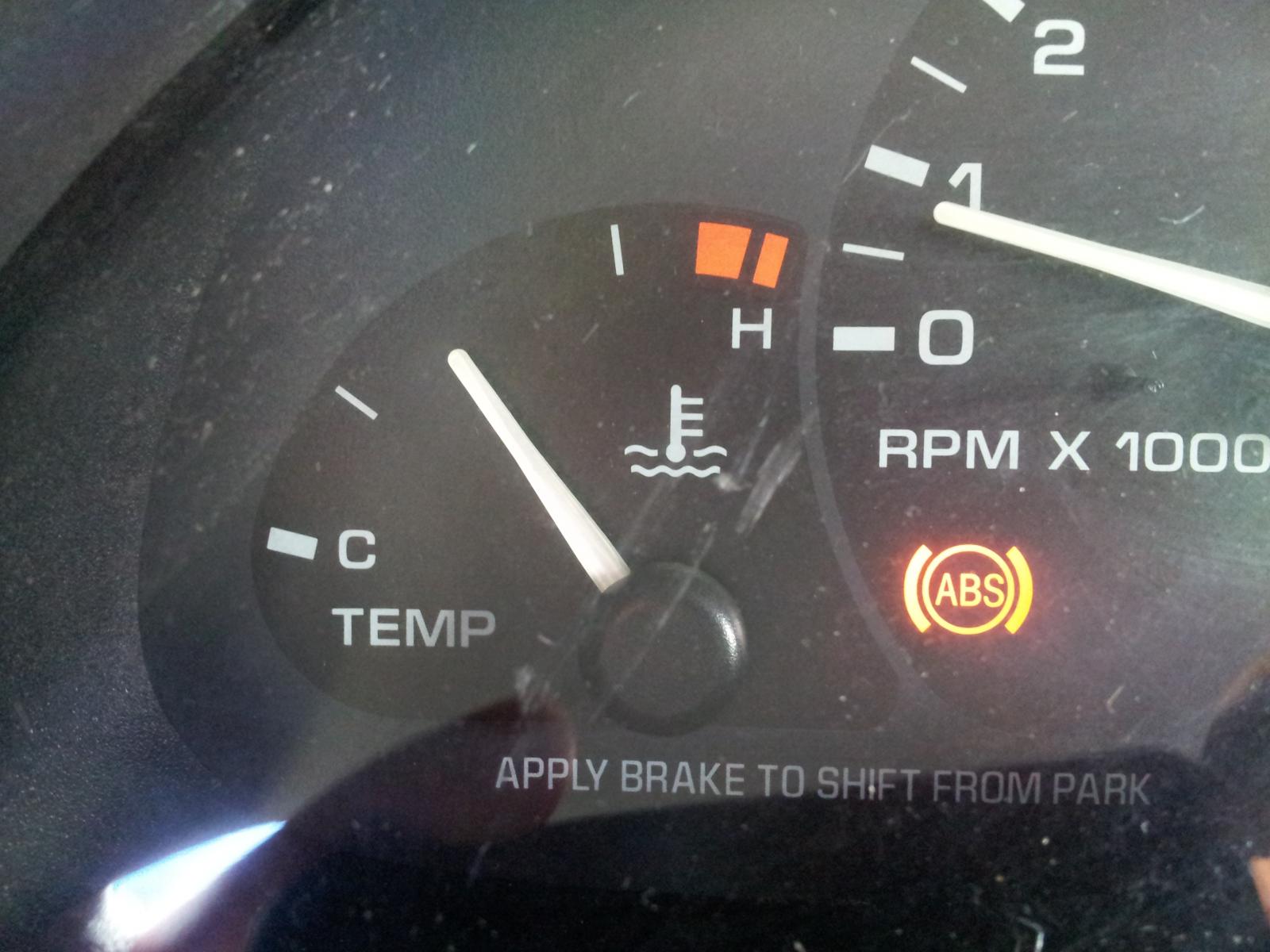

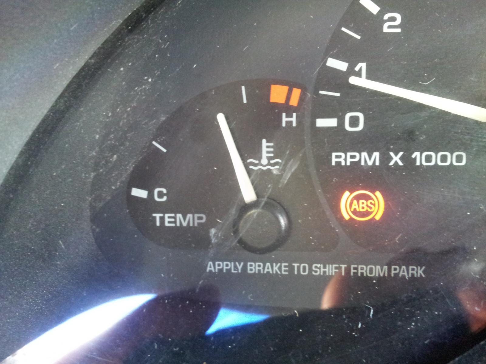

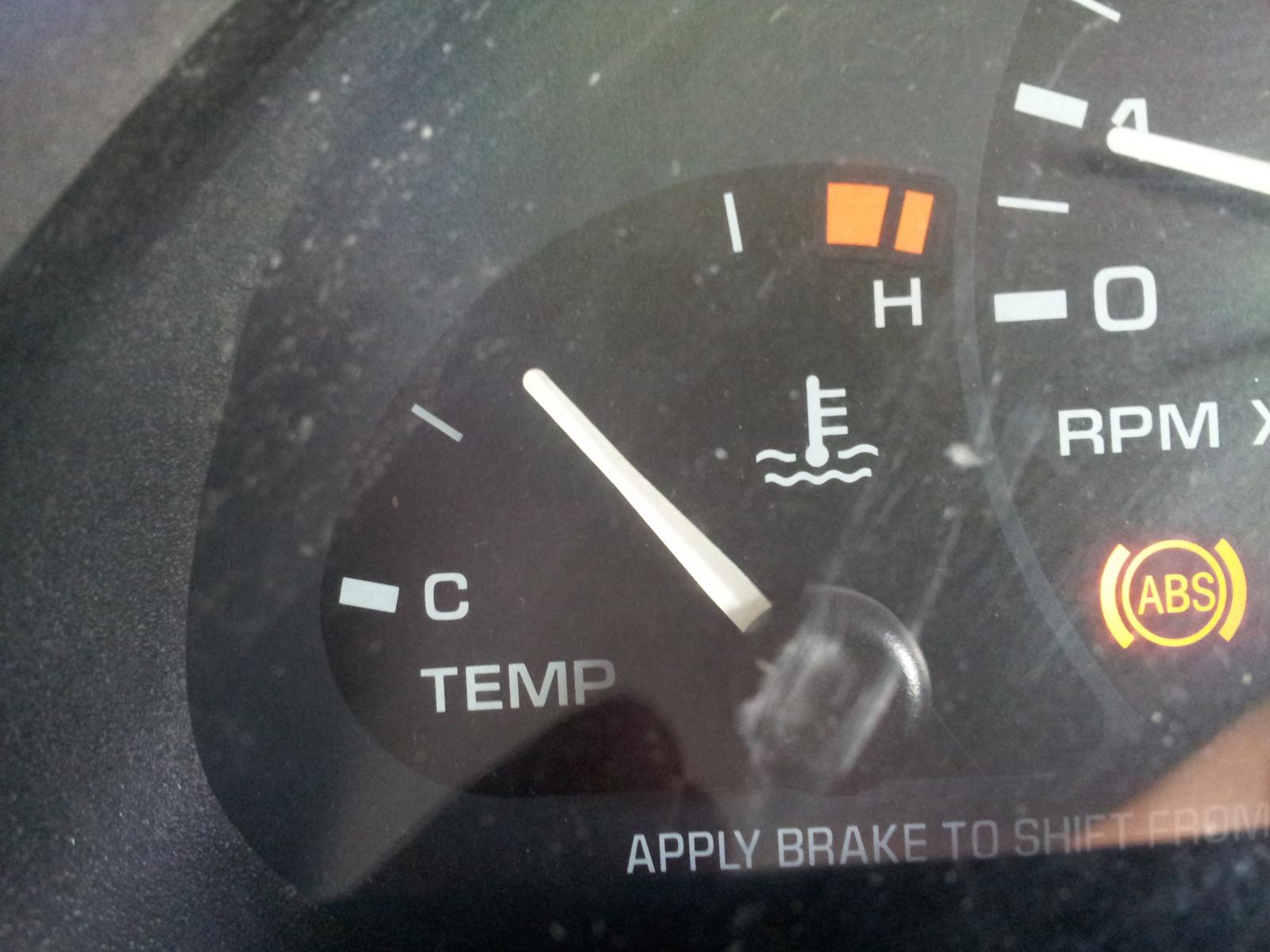

97oldscutlas Posted April 2, 2012 Author Report Posted April 2, 2012 posted the symptom pics RobertISaar, I don't think this is normal. radiator/t-stat should keep it at 195. something is causing it to get hot, but isn't major as the fan or air movment gets it back down. Another reason why i think it could be the restricted exhaust. i guess i will need to do a vacuum check to know.. AL, I'm not sure about the lower intake gaskets. wouldn't there be fluid exchange or get too much pressure or continual air in the coolant if my gaskets were bad? i guess i could have some plugged passages. is that a common on the 3.1? I have yet to do a compression check, but i don't think that would point me the direction of extra heat. Quote

tornado_735 Posted April 2, 2012 Report Posted April 2, 2012 Yeah, just looking at your pictures, your temps are running just fine. If you were creeping up anywhere above about the 2nd white tick mark, up towards the red, then you might want to start worrying a little bit. And like I said, you would know if you had a clogged cat because you would have more drivability issues. The car just wouldn't run right at all if there was a restriction in the exhaust. Quote
