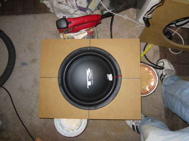

If you put the sub face down on the screwed up piece, you can measure it to make it equidistant from all sides. Then, just take a pencil and trace around the sub. Done deal. You'll need to cut 1/8 larger to fit the carpeting, but that should be easy.
Don't cut a square. The idea is to flush mount the sub and provide additional structural support. Give it another try and get it done right.

That wont damage the subwoofer? And as for now im not carpeting it, I dont have a carpet trunk liner in my trunk anyway so having it match wouldnt work anyway and when I thought about it being my car is a convertible sometimes condensations has built inside the trunk and it seemed the best to not use a material that would absorb water. I thought I might spray it with truck bed liner, i've heard from a few reputable websites that the duplicolor bedliner spray works very well, has a matte look and doesn't flake or peel, also gives me the option if I want to do a little customization with stencils should I desire. Shouldn't be any harder then when I sanded/painted my old computer tower and that held up for years.
So...use outside ring edge of subwoofer to draw circle for the larger outer sheet then redraw the 11.15" circle and cut that? Just making sure I heard you correctly, Thanks
Link to comment
Share on other sites
It won't damage the subwoofer. No need to worry about that.
Yep, you heard me correctly. If you measure it correctly before you trace, it should be centered well.

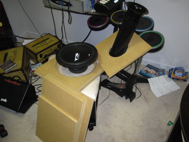

A few update pictures...
[ATTACH=CONFIG]7295[/ATTACH][ATTACH=CONFIG]7293[/ATTACH][ATTACH=CONFIG]7294[/ATTACH]

Pictures look great. Can't wait for you to finish this project. I think you'll really enjoy this sub.
