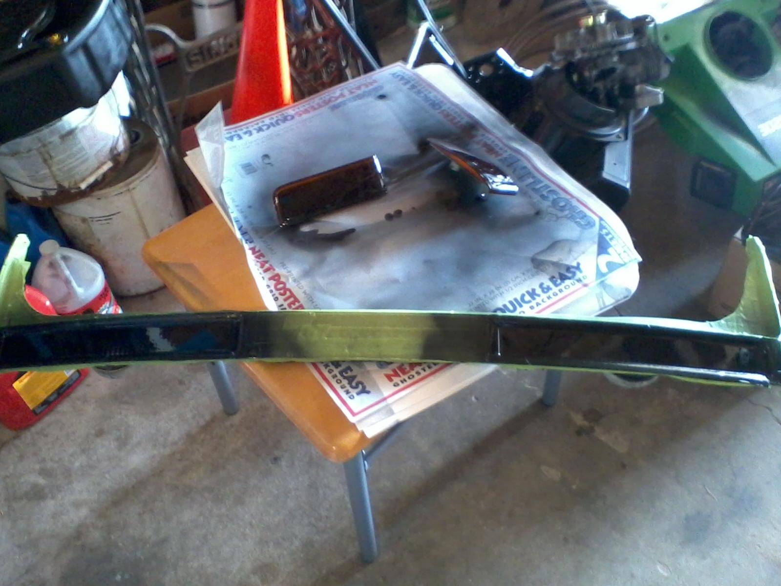

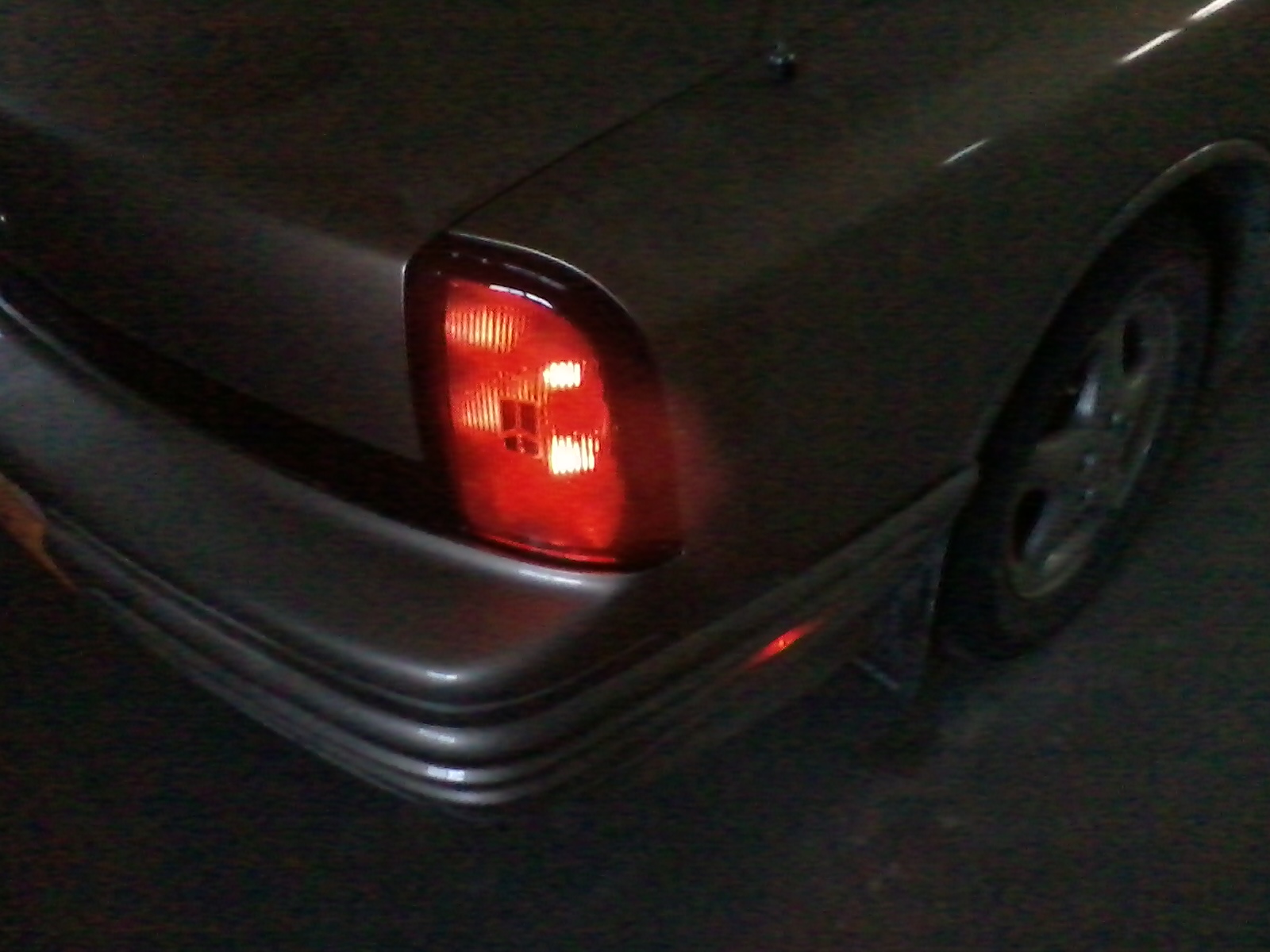

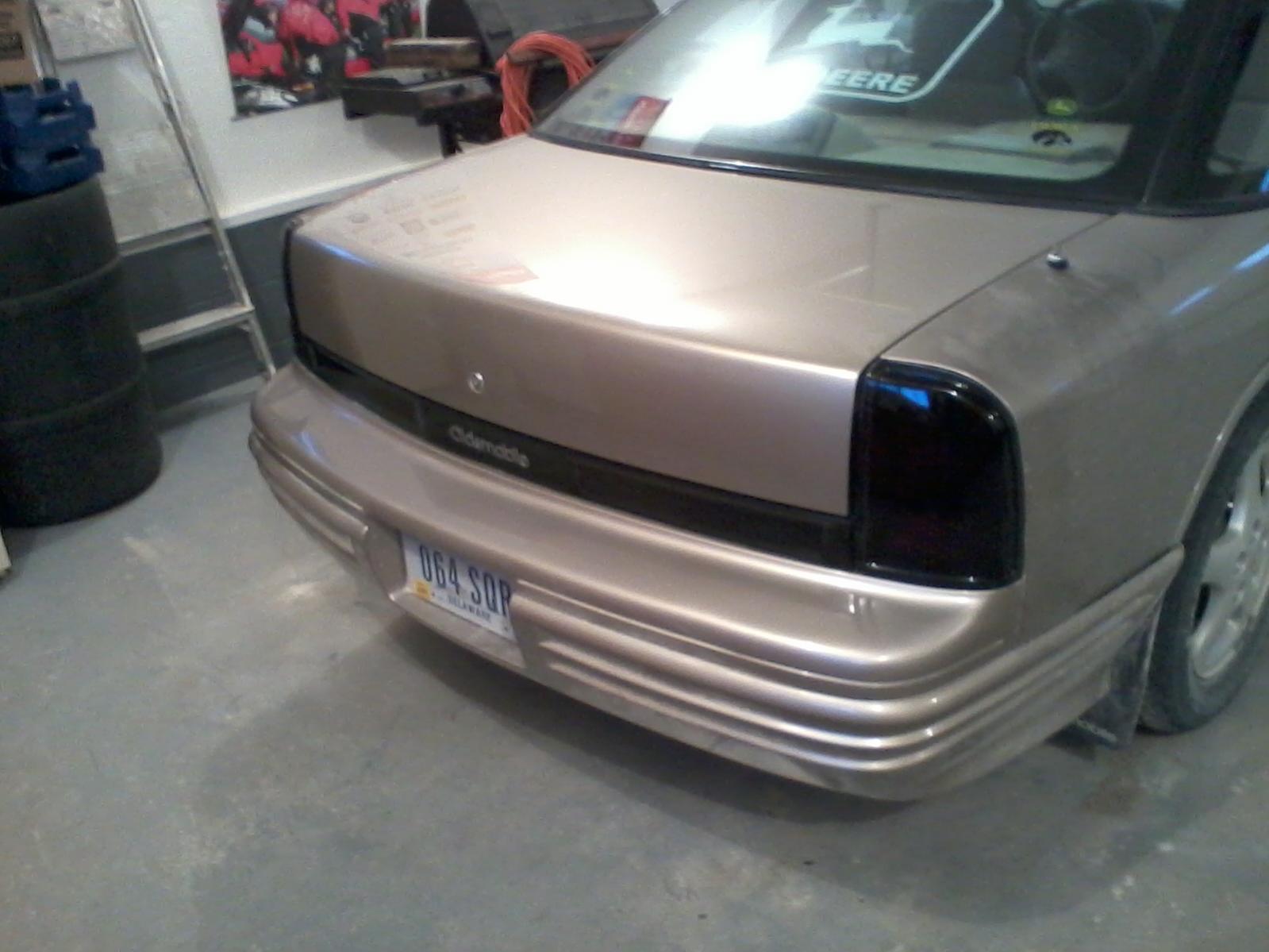

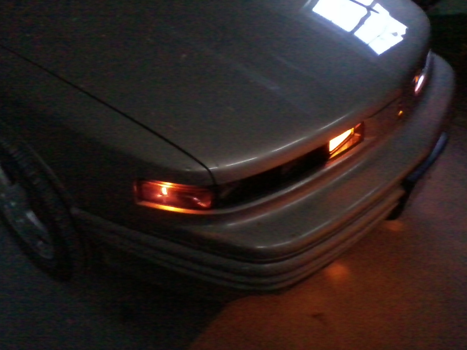

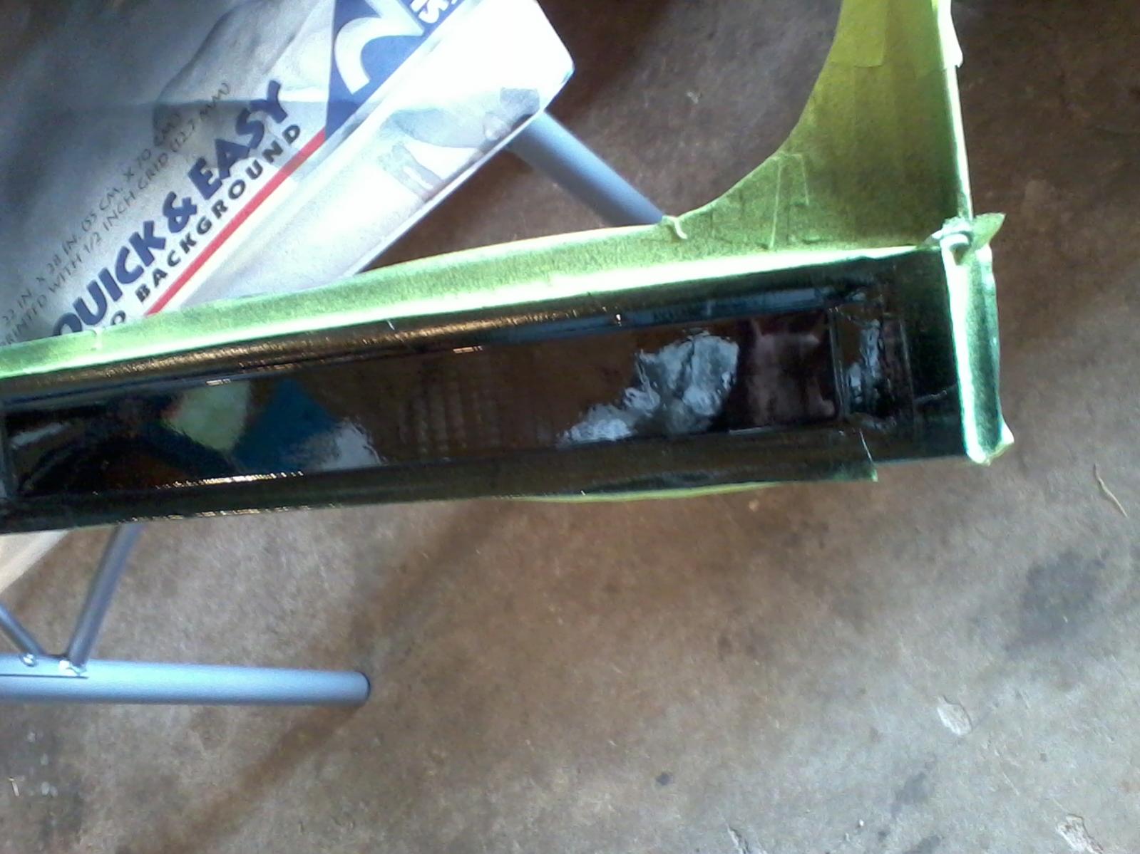

mhildebrand Posted March 24, 2011 Author Report Posted March 24, 2011 Heres the pics i have.. All taken with phone, i hadent tinted the inside front turn signal yet in these, so thats why its abit brighter. 3 coats of Niteshades and 6 coats of clear on everything. wet sanding inbetween Niteshades and clear. Quote

mhildebrand Posted March 26, 2011 Author Report Posted March 26, 2011 I agree... only have a few fish eyes that popped up in the first coats of clear on passenger tail light... Other then that i dont have any other paint flaws with them. Quote
