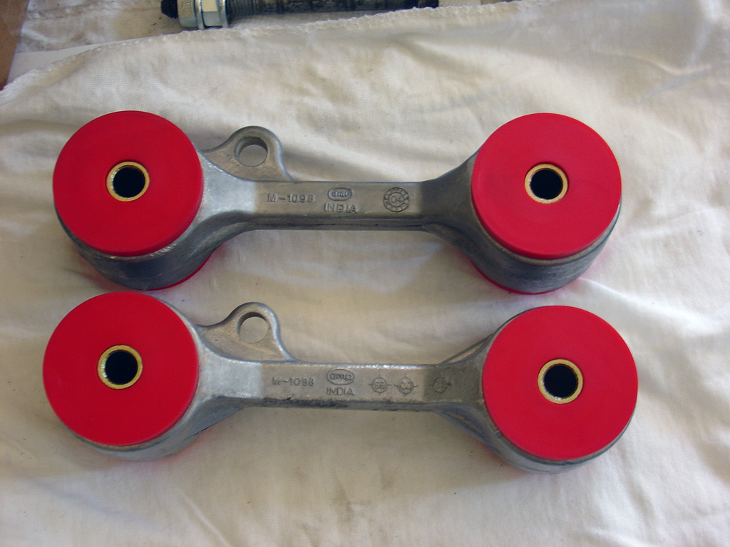

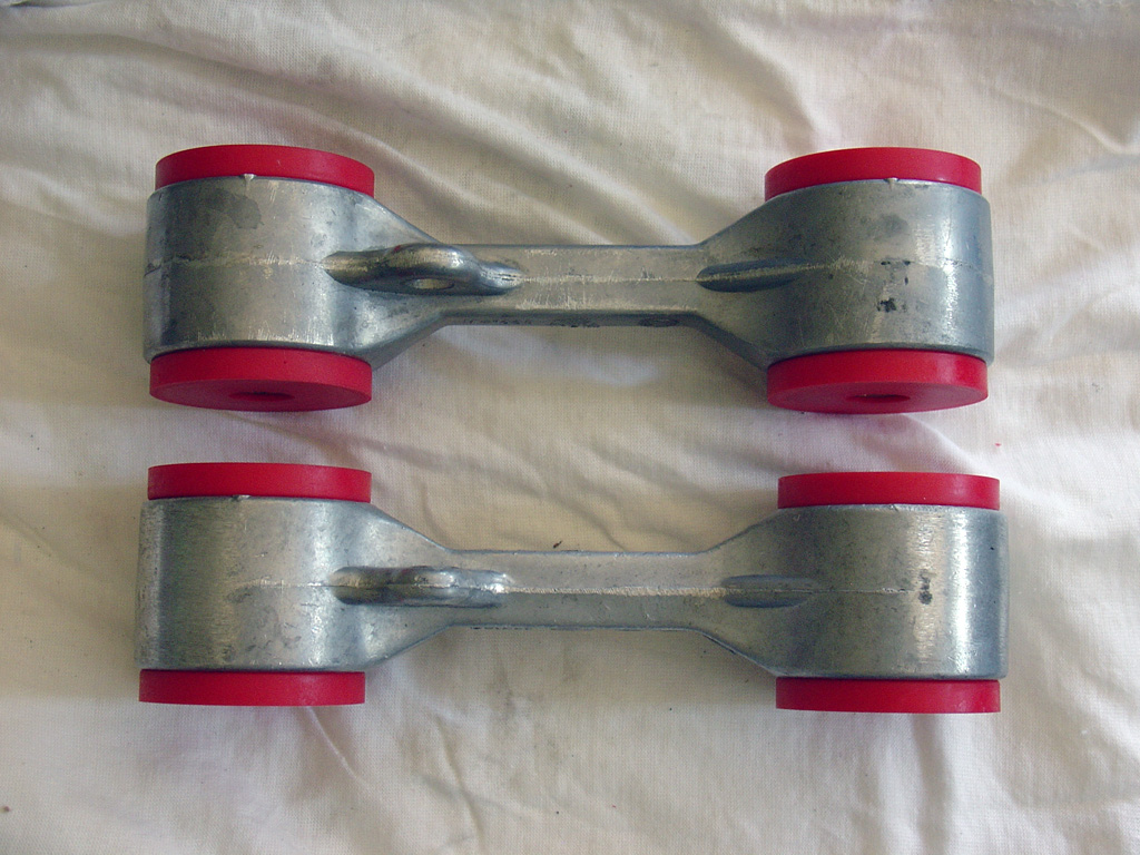

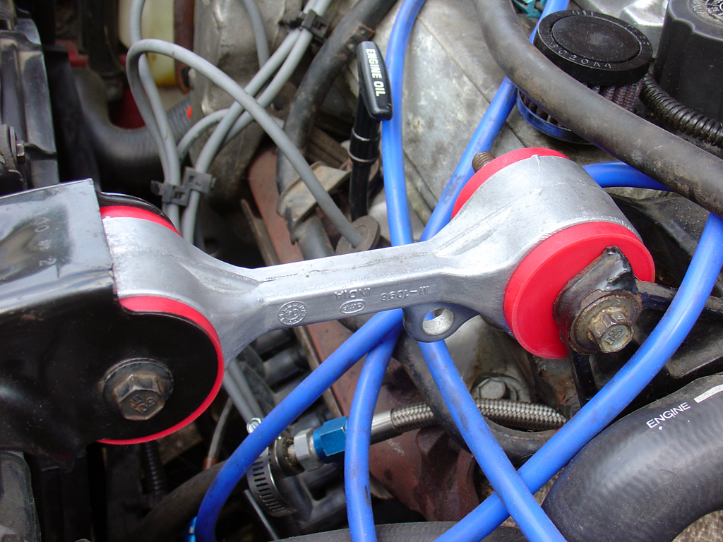

Just got 1.25 holes drilled out of my dogbones before my el cheapo cordless drill ran out of power... I wonder how long it takes to charge.
Also, the aluminum dogbones are super easy to drill!
I got acceptable results on the first hole just holding the piece freehand against a board on my garage floor. I love aluminum. LOL
This first hole is slightly uneven, a couple of small ridges... I was doing this freehand after all... but I think if I smooth it out slightly with sandpaper it will be good to go.
Do I need to lubricate the bushings when I push them in? The poly bushings did not come with any lube...

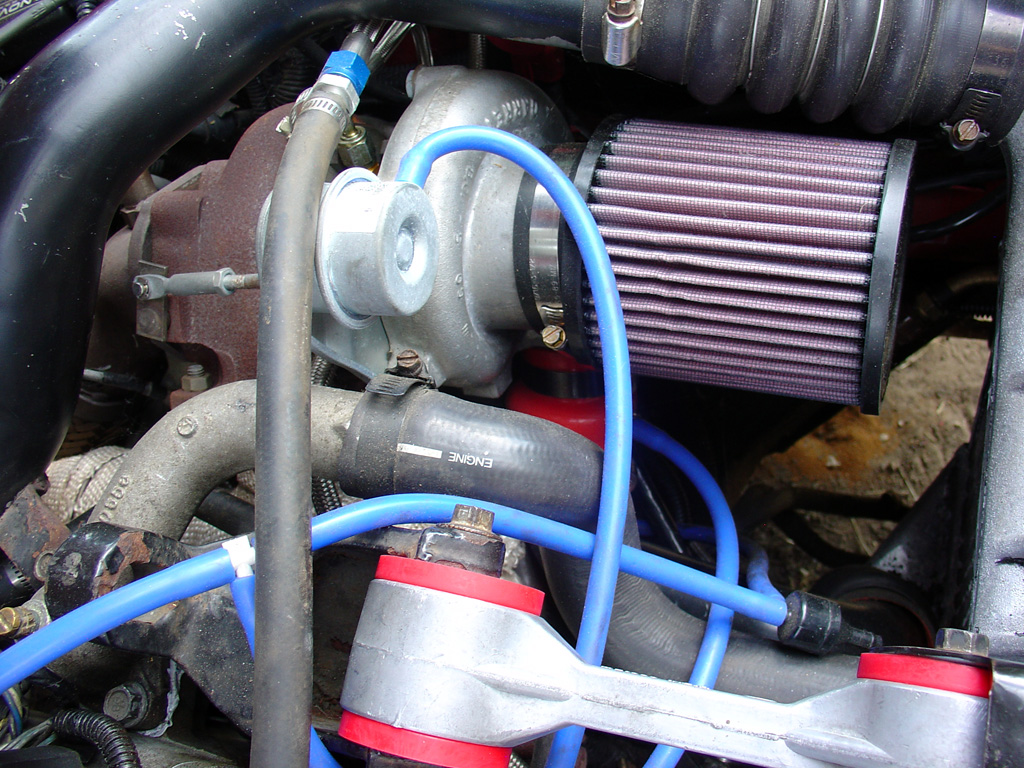

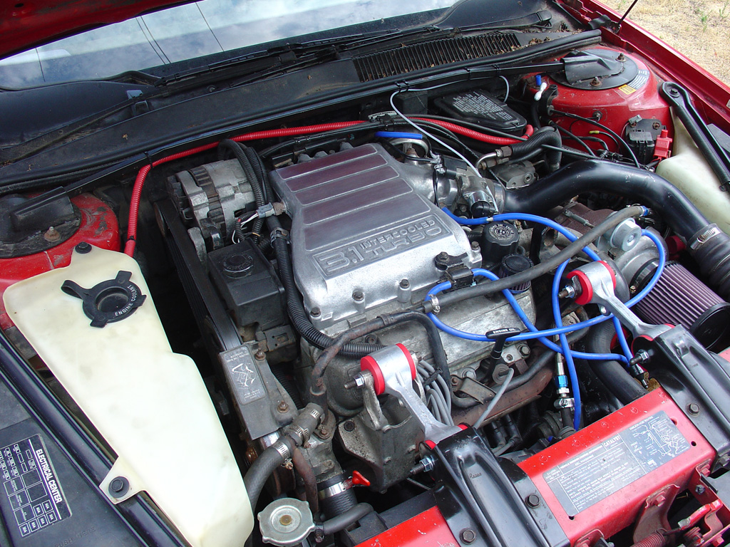

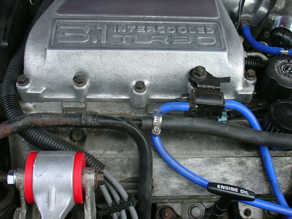

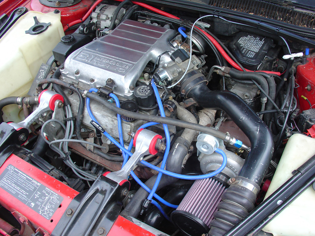

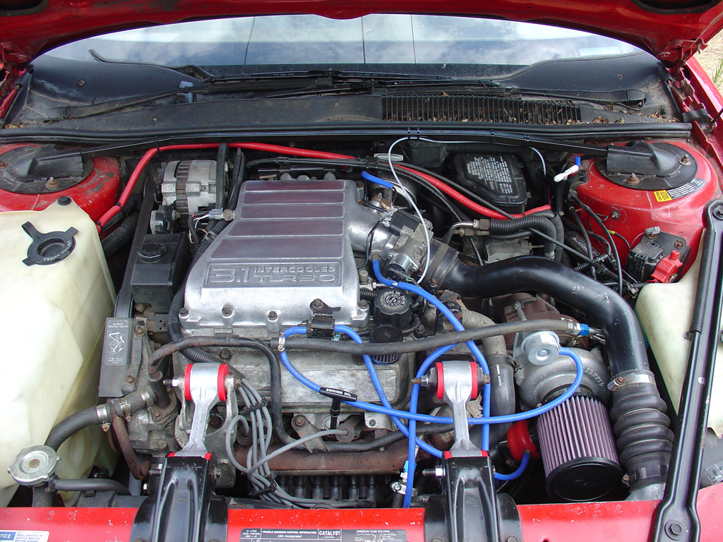

Poly dogbones are in! WOOT!
Here is a bunch of pics of the dogbones and of the engine bay...
Edited by Penglii
Link to comment
Share on other sites
How much vibrations do those poly bushings cause you?
Also do you have the part# for those bushings. I kinda of what to do this to my 3.1 since the dog bones are just laying on the garage floor.
Link to comment
I think the woof woof dog icon is awesome. :woof:
The aluminum oem style dogbones are super easy to drill through, would have been a snap if I was using a drill that at least pretended to have much torque or battery capacity. :lol:
I don't know that the aluminum oem dogbones can be bought new anymore, I have only seen the cast iron ones.
I was lucky to already have a set on the tgp when I bought it... I was also lucky that I did not hurt myself removing the old rubber bushings. Yikes.
Link to comment
I have no idea, I just put them in the car. I hope to bleed the brakes tomorrow and see how she drives.
I suppose I could find out how the vibrations at idle is increased... I may do that before I go to bed tonight.
I am expecting an increase in cabin vibration, but I have no problems with that.
Energy Suspension #3.7103R is the number for red bushings.

Cannot press a poly bushing into an undrilled dogbone unless you carve the poly bushings into a cone shape... and I think that would be worth avoiding.
It's not too bad to drill them out with a 1.75" Bi-Metal hole saw. Although if your T-bone mount is the cast iron variety I would highly reccomend a drill press.
You can totally press the poly bushings into the mount yourself, with just your palms, so there is no need to have a shop do it.

- OMG the poly dogbone bushings transfer a lot of vibration into the cabin. I like it, makes driving the TGP even more exciting!
