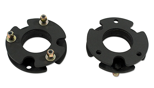

Chris 0 Posted November 2, 2010 Report Share Posted November 2, 2010 I wanted to change out the springs, but after having to reinstall one I'll never do that again. I'm now thinking about a spacer, like they have for "leveling kits" on trucks. Quote Link to post Share on other sites

Chris 0 Posted November 2, 2010 Report Share Posted November 2, 2010 OK, I don't think we're on the same page here... I'm looking for direct-replacement coils, just longer/heavier instead of shorter. There has to be some interchange with another (heavier) vehicle somewhere that would fit this purpose. I know w-coils are like 40 feet long after disassembling a strut over the weekend. Those links haven't worked in a while, but I think you're referring to something like these? http://www.westshorefabricators.com/WBody/Coilovers.htm I was thinking about building some custom ones like I did for the rear, but I want to be lazy. And I don't want to spend a ridiculous amount of money (again) on a shitty W-Body. Quote Link to post Share on other sites
CSI_MuNkY 0 Posted November 2, 2010 Report Share Posted November 2, 2010 My bad, I didn't realize that the link to my thread had gone bad with the new forum change. I have the Held kit, its a great starter kit, but for those that are serious, its crap. The upper spring mount is machined out of plastic. As for an interchange, that I have no idea, but highly doubt the same springs were used on none w's Quote Link to post Share on other sites
Chris 0 Posted November 2, 2010 Report Share Posted November 2, 2010 Yeah, forum changeover hosed a bunch of links. That always happens when changing from one flavor to another. I didn't realize that kit had plastic components, that's a joke. I don't like how the link I posted doesn't show prices, and I haven't heard back from them on pricing yet. I'm thinking a strut spacer will be my best option, but I'd like something to stiffen up the front also. It'll be easy enough to make a custom spacer like they have in leveling kits for trucks. Edit: just got an email back from Erik @ westchorefab - looks like he's writing me up a quote for a stage 1 kit... Quote Link to post Share on other sites
