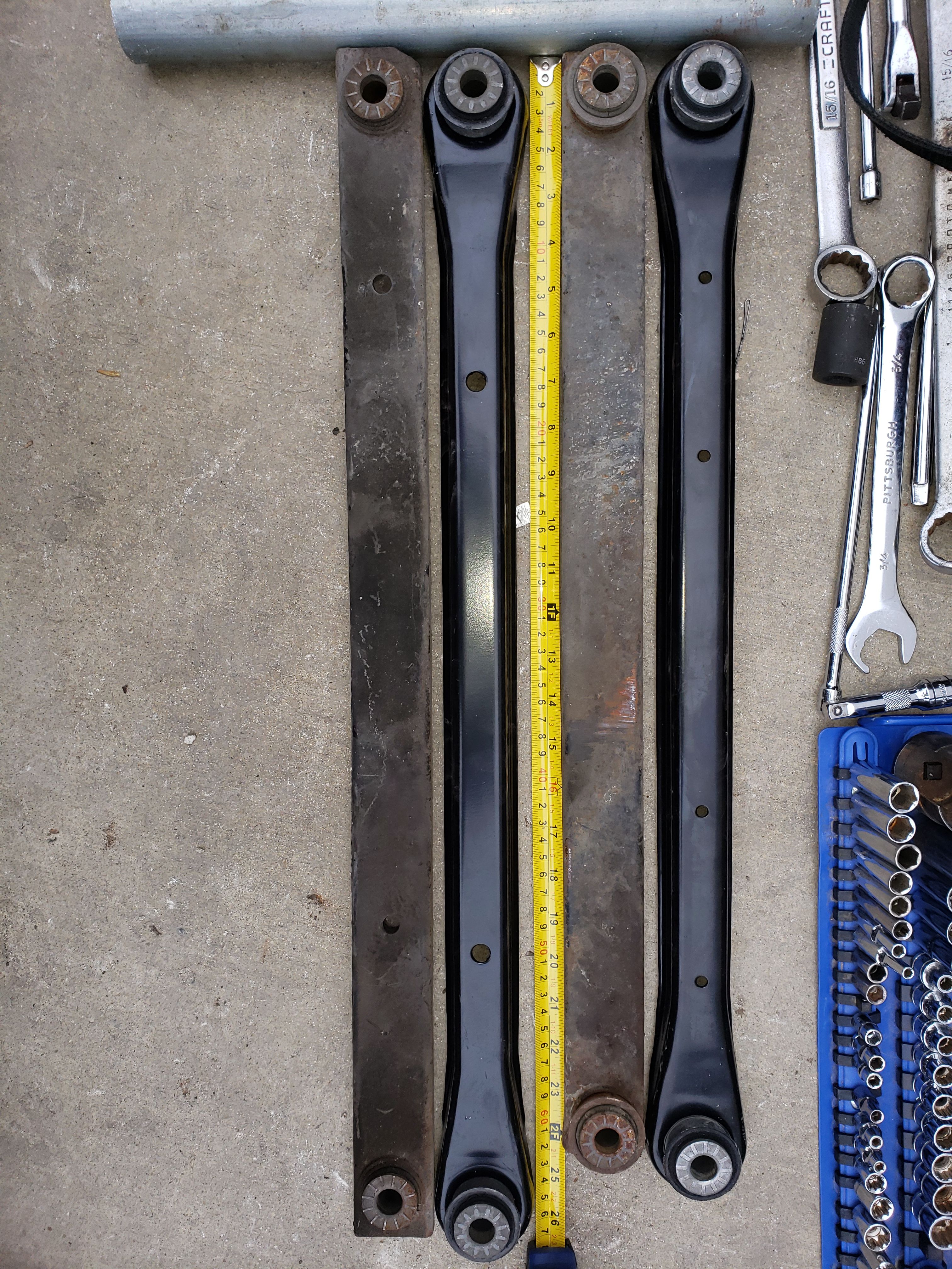

darklotus42 Posted November 18, 2023 Author Report Posted November 18, 2023 (edited) Okay so here's what's going on. I couldn't find the lateral arms for the Cutlass so I went ahead and ordered the ones for the Monte Carlo. they had moogs and mevotec. I ordered a set of each. I got the moogs today and I went ahead and took the old lateral arms off and here's a pic of the old ones next to the moogs. as you can see they're not the right length so now I'm just going to wait on the mevotecs and compare them as well. if there's anybody out there that has any further knowledge on which are the right ones to use please let me know. Thanks Edited November 18, 2023 by darklotus42 Add pic and comment Quote
55trucker Posted November 19, 2023 Report Posted November 19, 2023 Well those lengths are both disappointing & surprising, It's not easy to see accurately how much longer each new arm is with respect to the original..... It looks as tho each new arm is less than half the dia of the eye hole longer than the old ones. Using your tape measure what's that measurement? Quote
SuperBuick Posted June 21, 2024 Report Posted June 21, 2024 Hi all - im following up here vs starting a new thread. I too need 1st gen lateral links (all four), and there is lots of conflicting info out there - but @darklotus42 is the only info i have seen with pics showing that the "monte carlo" (2nd gen?) arms are actually too long. Is there a definitive answer to "I need all 4 lateral arms for a gen 1 W-body"? I'm not averse to putting bushings in my existing ones, but I cant find the info for those either! Thank you! Quote
Bake82 Posted June 21, 2024 Report Posted June 21, 2024 buy 4 rear lateral links for a 97+ grand prix. They are adjustable. The 97+ link will bolt in and work no issues to replace the 1st gen rear arm the 97+ link will not bolt in for the front of the 1st gen arm - but if you cut 1 inch out of the arm, and re-thread an extra inch (find a 55trucker post on this) they will fit no issues. My recommendation is to match the length of the new arms identical to the 1st gen arm and you will have no issues getting it aligned. ' I have 97+ adjustable arms on the rear of my cutlass. the only issues I've had with alignment is when i installed them and they were the wrong length side to side. Make them the same as the 1st gen and you'll be golden. rich_e777 and SuperBuick 2 Quote
