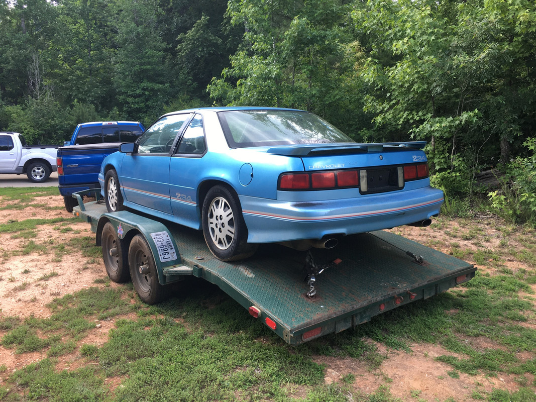

mechanic58 Posted June 27, 2021 Report Posted June 27, 2021 (edited) Just picked this up today, ‘93. Unmolested one owner Carolina car. Been parked a long time. Timing belt failure. Edited June 27, 2021 by mechanic58 Changed the picture links 89-W-Body-Regal, oldmangrimes, LuminaMan93 and 7 others 9 1 Quote
