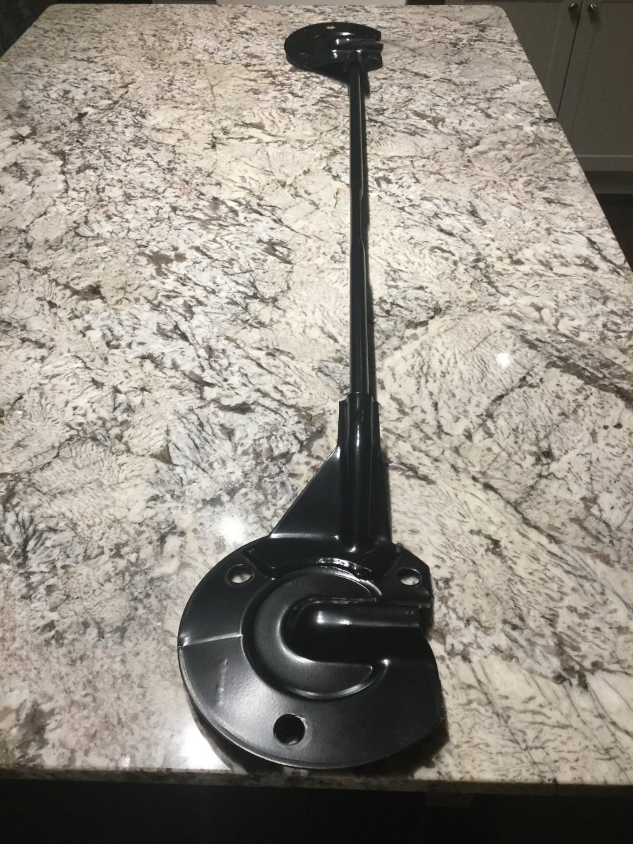

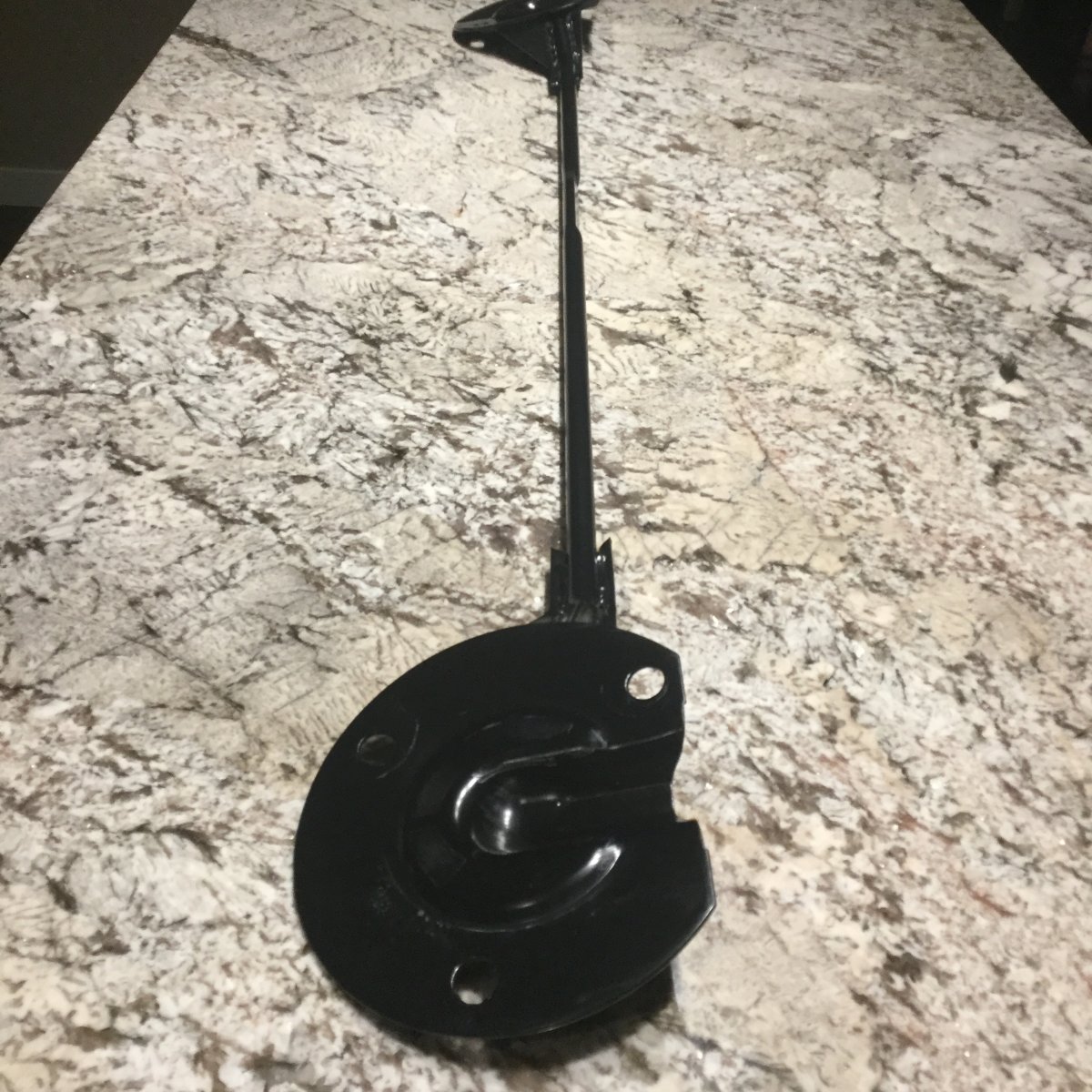

GTP091 Posted January 23, 2019 Report Posted January 23, 2019 Here’s the strut bar not easy to photo because it’s so long. I used rubber washers to secure it to the tower so the powder coating isn’t damaged at the bolt holes rich_e777, Imp558 and Amanita 3 Quote

Imp558 Posted January 26, 2019 Report Posted January 26, 2019 On 1/23/2019 at 12:06 AM, GTP091 said: Here’s the strut bar not easy to photo because it’s so long. I used rubber washers to secure it to the tower so the powder coating isn’t damaged at the bolt holes Dude, next time you fire up your time machine I need a center console lid. That FSTB is beautiful. Amanita 1 Quote

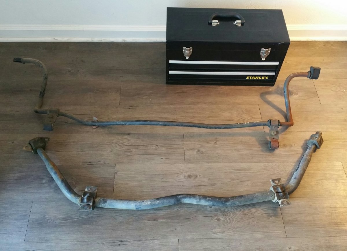

Amanita Posted January 26, 2019 Author Report Posted January 26, 2019 (edited) Just got back from the junkyard with these, they came out of a '96 Monte Carlo z34. Now I need to order some new end links/poly bushings and sand the rust off/repaint them. 17 hours ago, Imp558 said: FE3 springs? Yeah, it has FE3 springs, don't all '96 Grand Prix coupes since they were all sport packages that year? Edited January 26, 2019 by Amanita Quote
Imp558 Posted January 27, 2019 Report Posted January 27, 2019 Those are nice! If your spare tire cover is intact it'll have an rpo code sticker on it. Look for FE? and hopefully it's FE3. Amanita 1 Quote
Amanita Posted January 27, 2019 Author Report Posted January 27, 2019 (edited) 48 minutes ago, Imp558 said: Those are nice! If your spare tire cover is intact it'll have an rpo code sticker on it. Look for FE? and hopefully it's FE3. Thanks! I wet sanded the front one today, going to try and paint it tomorrow if its warm enough. Its FE3, I made sure to check that before I went to pick them up this morning. Edited January 27, 2019 by Amanita Imp558 1 Quote
