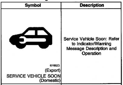

Hey guys. What is the light in the message center that looks like a car with a wrench through it? This is in the 2002 Impala. It started just after the drl's and interior lights went out. All fuses are good and the battery is fully charged and the alternator is charging fine.
That symbol comes up in my 04 DIC with the message "Service Variable Assist Power Steering" but it could be something else.....
That will come up when there's a problem with a BCM related item. Since your DRL's and interior lights went out when it happened, I'd suspect the BCM took a dump. Not uncommon. Needs to be replaced and coded by a GM dealer.
Cool, thanks for the pic Robert and thanks for the info alec_b.
