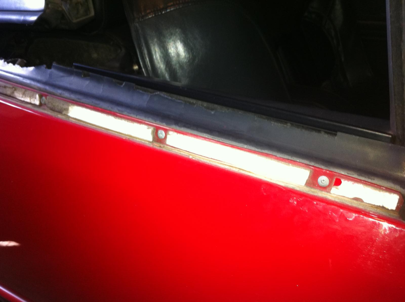

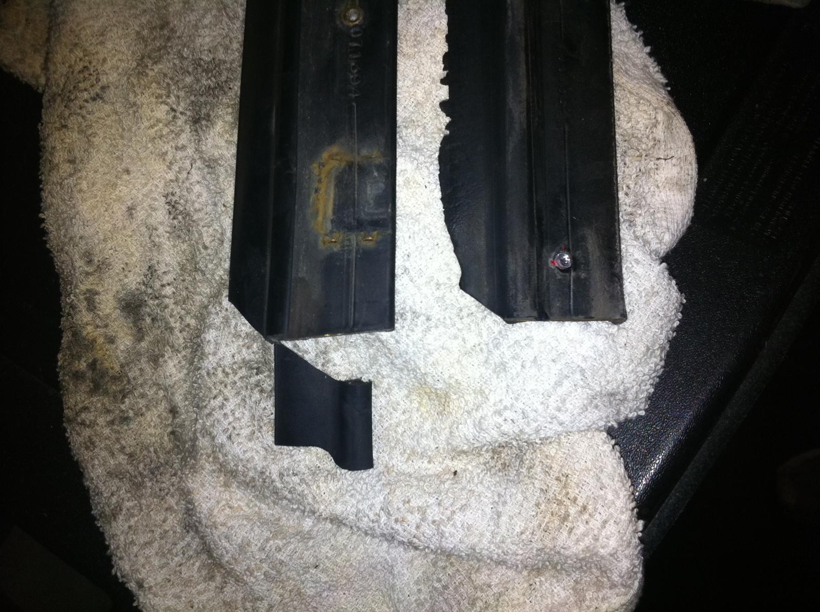

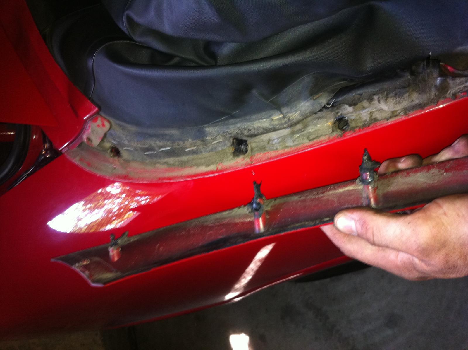

xennith Posted May 18, 2012 Report Posted May 18, 2012 (edited) I did this to my 93 vert. get the door window strips from the mid 90's camaro or trans am. you just take off your convertible trim that covers the seal (three screws in trunk and one under B pillar trim), drill out the rivets on your old seals and cut the replacement to match the shape and length and predrill the rivet holes. Then rivet it back on. I would recommend shaving off a bit of thick part of the new seal or it will push the trim piece out. Use new double sided tape on the trip and reinstall the screws. Edited May 18, 2012 by xennith Quote
