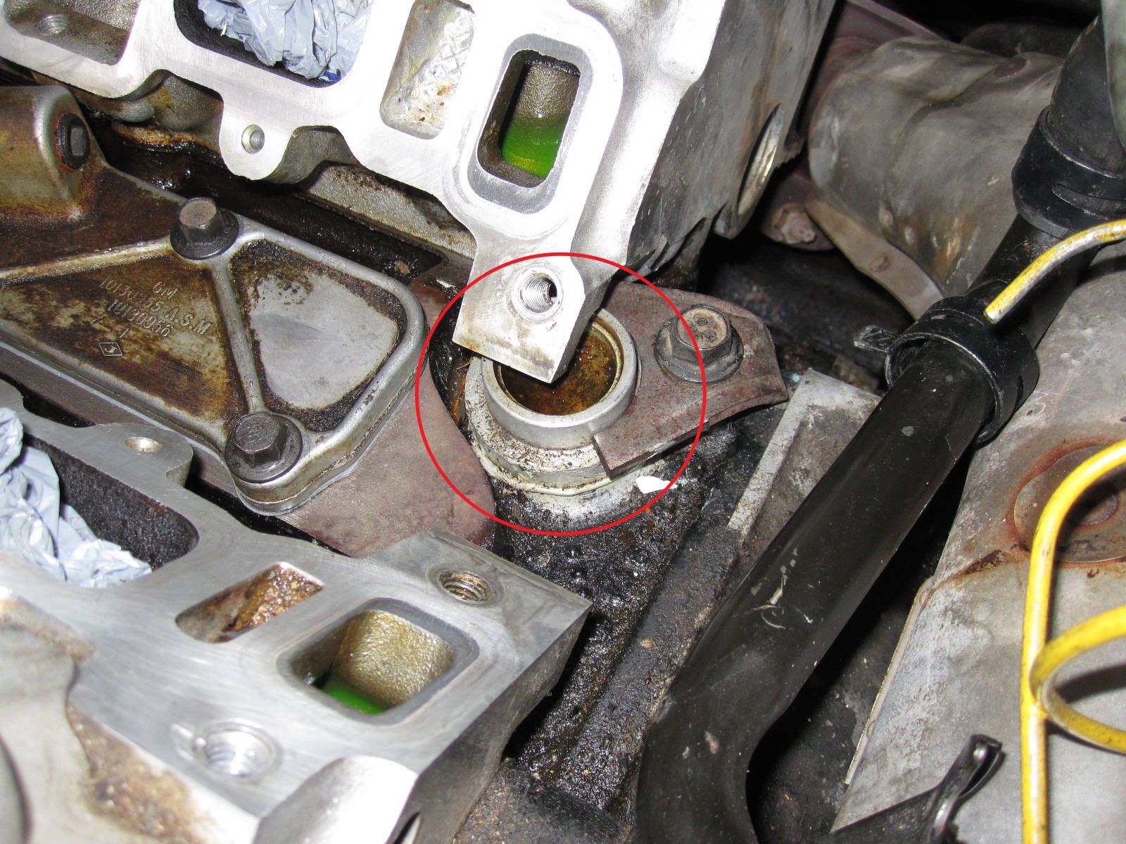

It's in the valley right by where the transmission and engine block are joined together. Oil will pool around the distributor plug (also called "oil pump drive") and run down the side right where the transmission mates to the block so where it drips on the ground looks very much like a rear main seal. An O-ring goes bad on it allowing it to leak. Shine a flashlight down there, and if there's oil pooled in that area, that's your culprit. Unfortunately, yes, it's blocked by the rear head. What most people do is lift it up as high as possible and clean it and the block as well as possible. Some sandwich a thin O-ring under it, others RTV it. My memory is hazy, but I think I may have done both. On my pic, high pressure oil-resistant RTV is the stuff kind of squishing out from under it. It's dirty because this was many years later, but it worked great. Official GM procedure is to pull the rear head, but that's way, way too much trouble.

This is an excellent point, can you pinpoint and/or provide a photo as to where this is? For the life of me I can't find it and/or provide the page on the 1994 W Book that may provide a diagram where it is located? I would really prefer not to pull the motor if that can be avoided. Thanks for this memo, much appreciated

You probably already checked, but make sure it's not the distributor plug seal before tearing into it. That can mimic a rear main seal leak.
