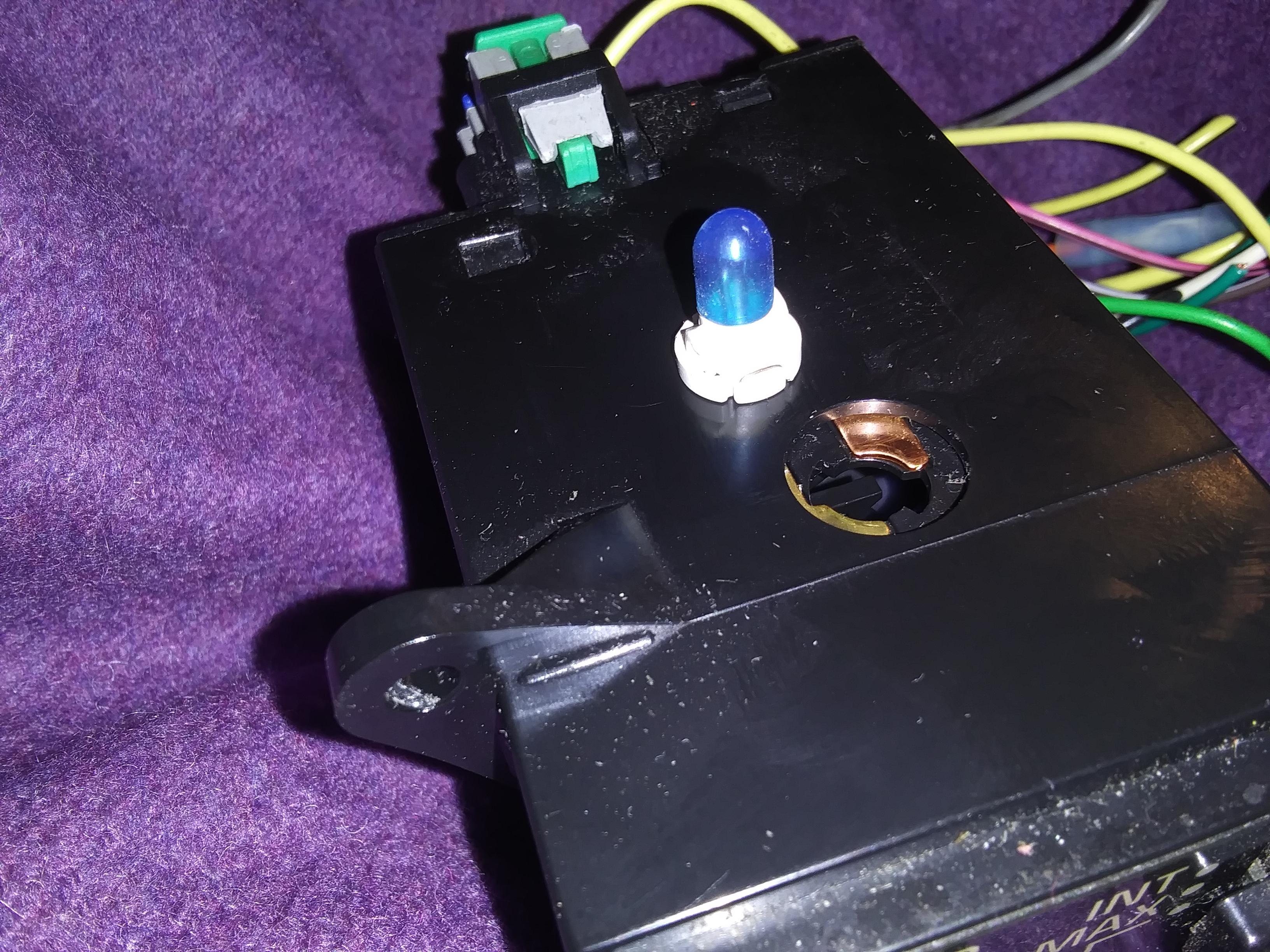

it's actually not too hard, you have to remove that switch module, then theres a round white piece of plastic on the top.  Just unscrew it and and it comes out.
The real problem is, what kind of bulb is it?   A 12v LED might work, looks like a christmas light with the bulb leads wrapped around the base.image.jpeg.b2851eec4e91724581b9dac42f5e7825.jpeg
