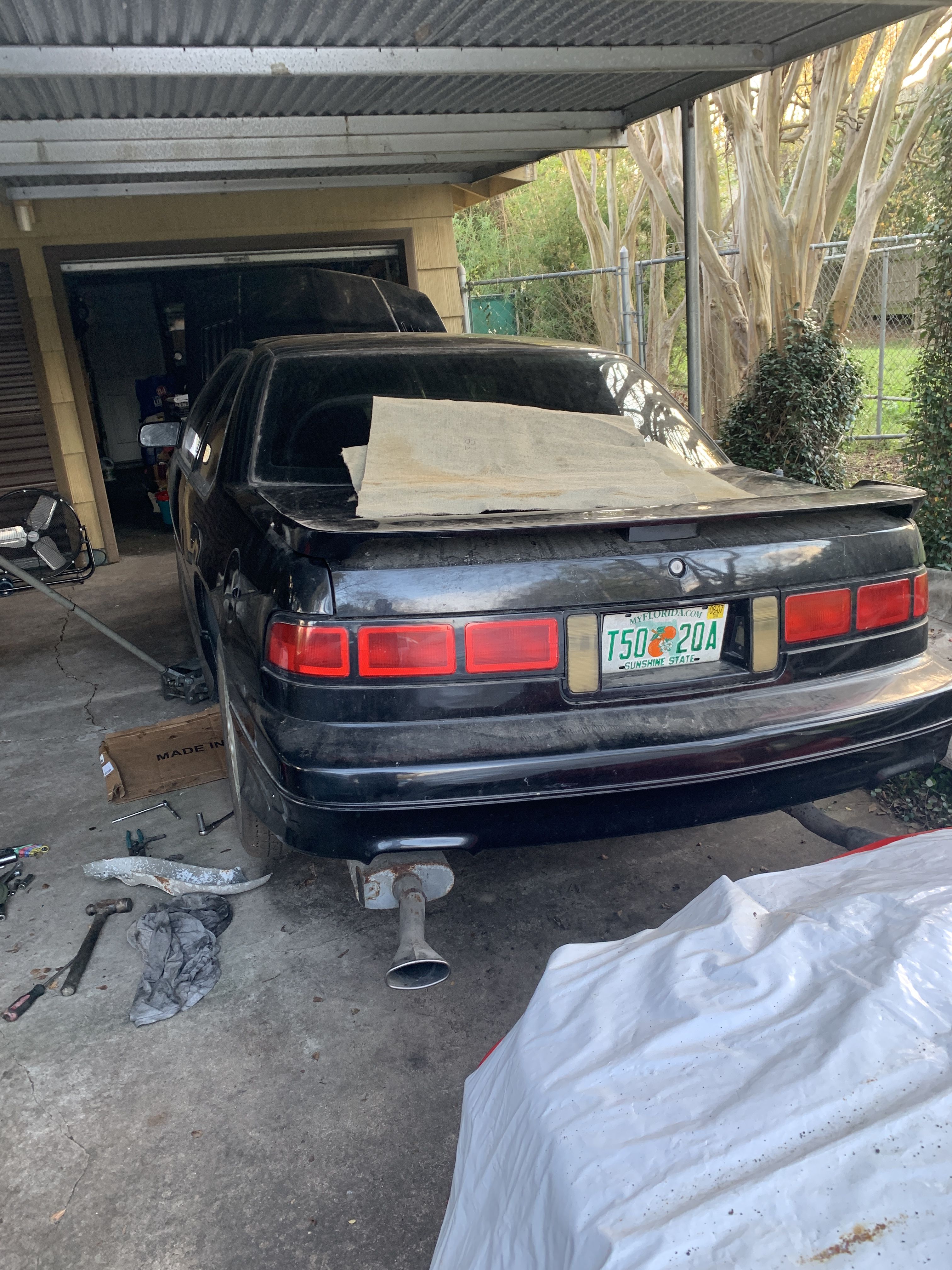

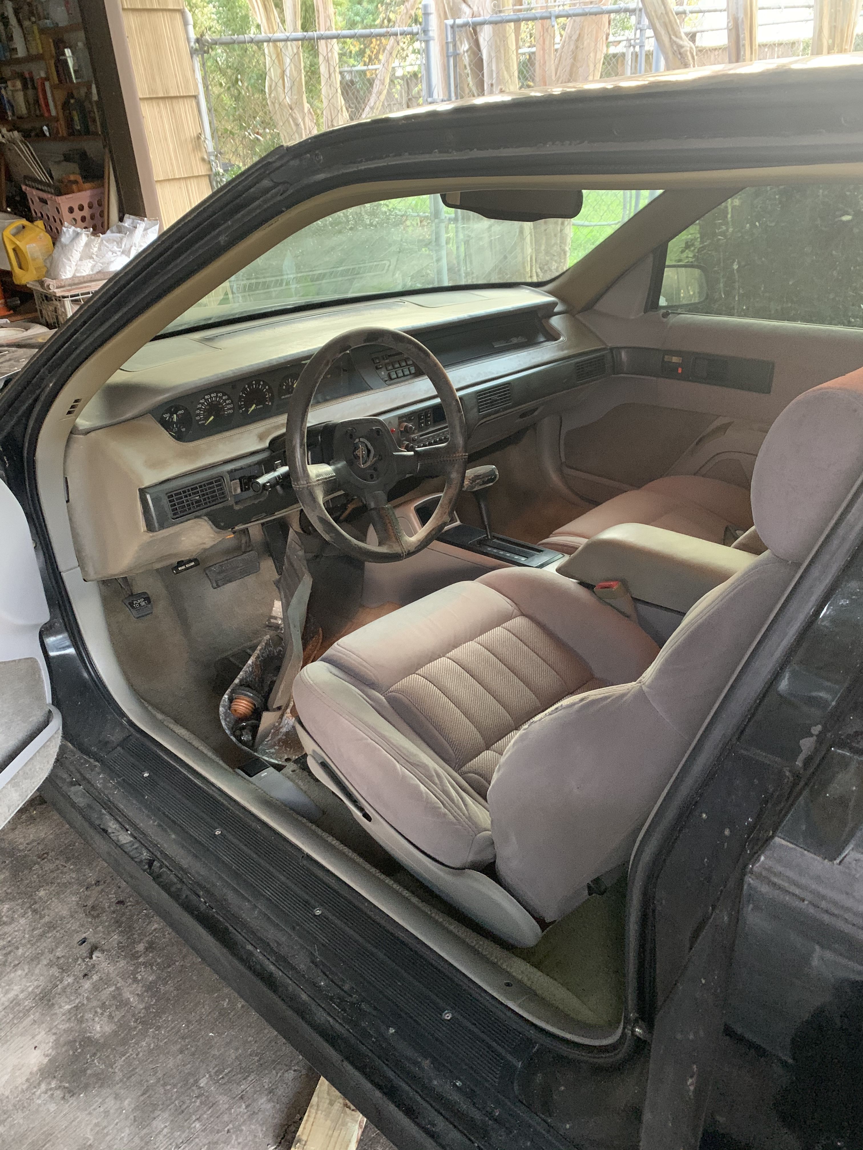

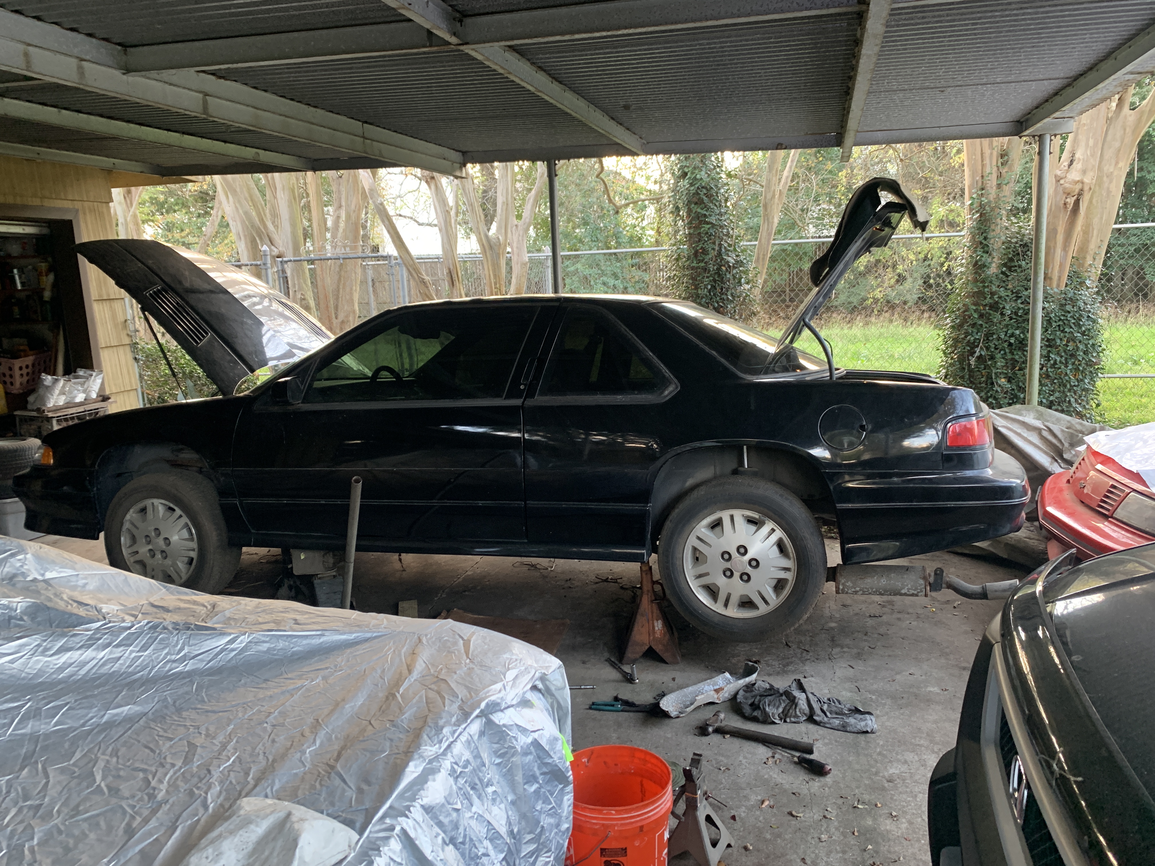

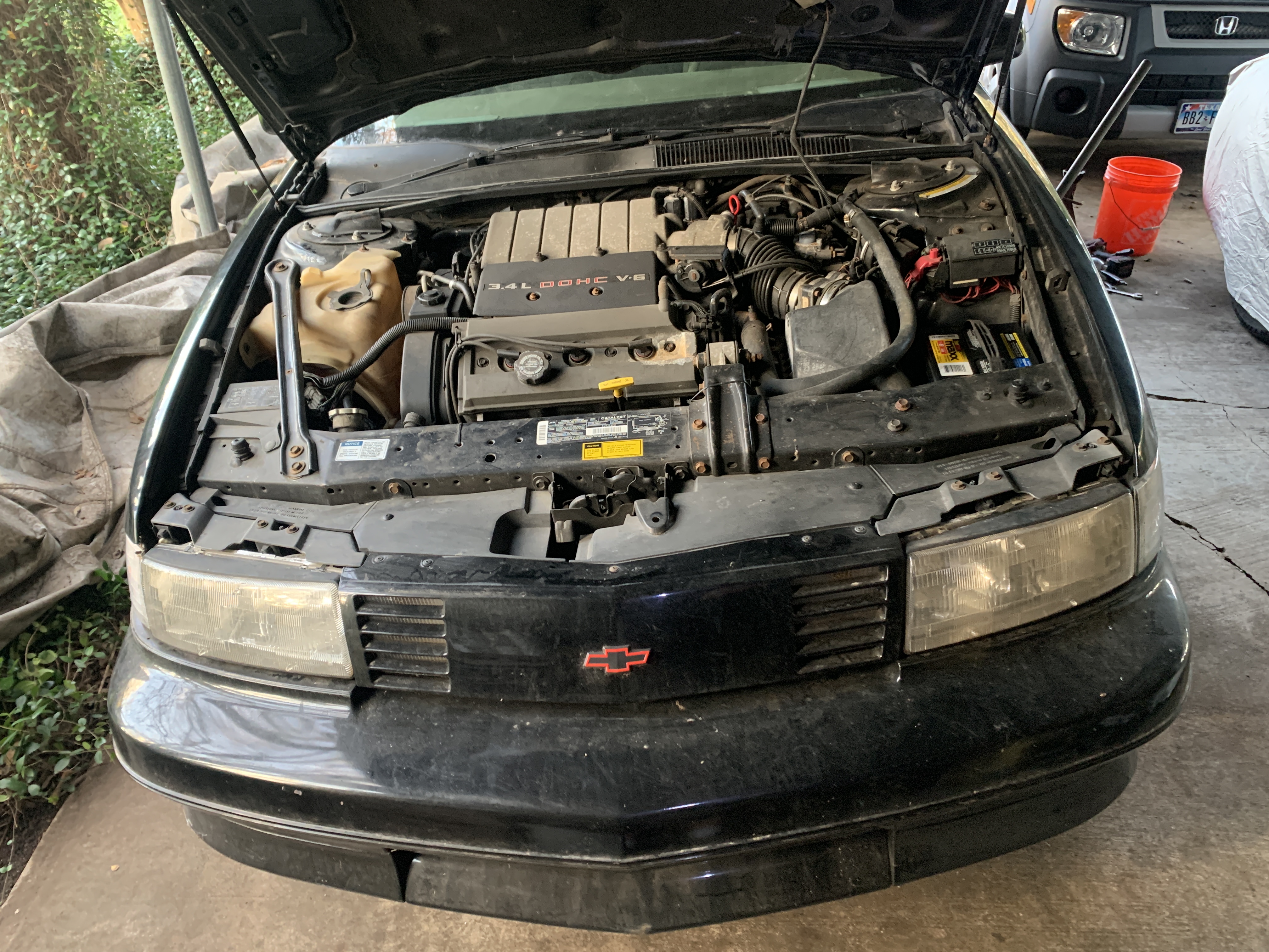

Raffaelli Posted December 24, 2022 Report Share Posted December 24, 2022 Hi, Just acquired a new to me 1994 z34 Lumina from some good friends of mine. Grey interior, auto, good black paint, been sitting 10 years up on blocks. I’ve always wanted an early 90s cavalier z24, But this Lumina fell into my lap. I plan on doing a build thread to keep track of the things I do to the car. First thing is a fuel pump and new tank. ill try to post pictures, that’s always fun on forums nowadays. pwmin, primergray, Eric and 1 other 1 3 Quote Link to comment Share on other sites More sharing options...

GTP091 Posted January 21 Report Share Posted January 21 (edited) Coolant drain, flush, fill… change the oil… take a hard look at the oil distributor plug if you see it’s leaking a lot of oil. clean clean clean. Idle relearn procedure is key on-off 3X. That always gets new wbody owners that disconnect the battery and wonder why it starts and dies immediately after when it was running fine before. how’s it run? if you need rear callipers look in the for sale section I have a set. Edited January 21 by GTP091 Quote Link to comment Share on other sites More sharing options...
Raffaelli Posted January 22 Author Report Share Posted January 22 17 hours ago, GTP091 said: Coolant drain, flush, fill… change the oil… take a hard look at the oil distributor plug if you see it’s leaking a lot of oil. clean clean clean. Idle relearn procedure is key on-off 3X. That always gets new wbody owners that disconnect the battery and wonder why it starts and dies immediately after when it was running fine before. how’s it run? if you need rear callipers look in the for sale section I have a set. I have a build thread going in member's rides. I got it running, haven’t driven it yet. Waiting on tires and other things. Quote Link to comment Share on other sites More sharing options...
