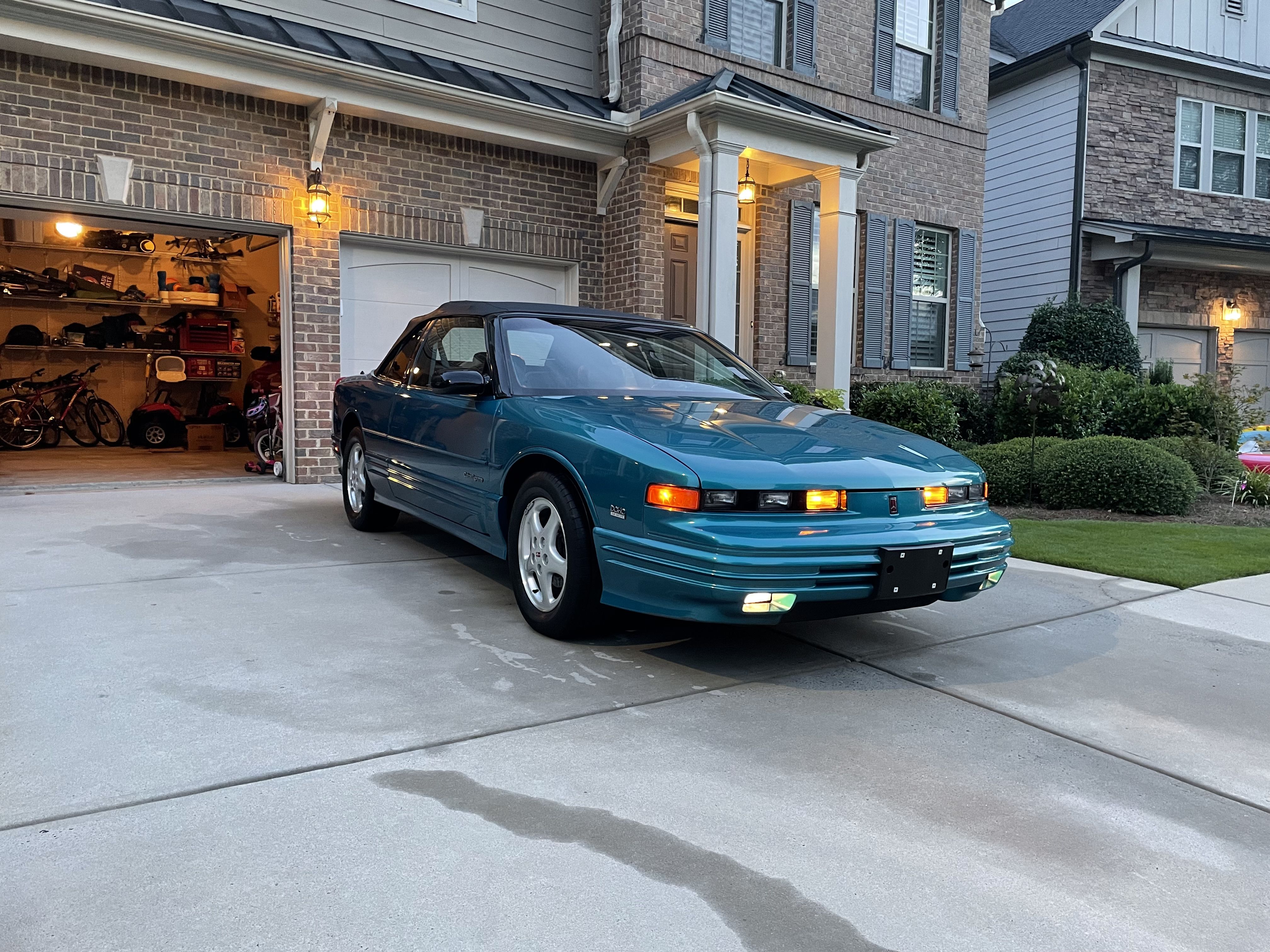

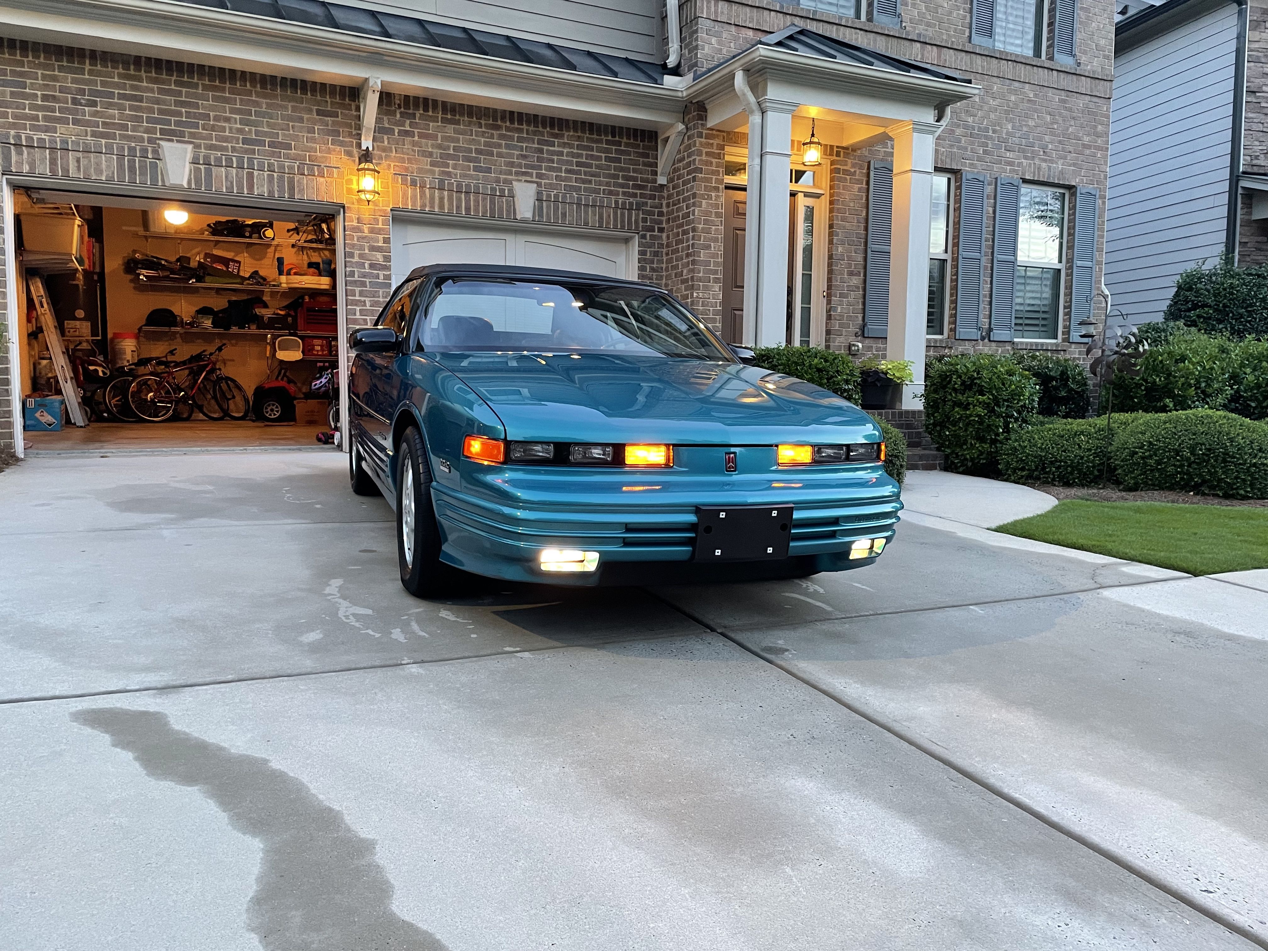

Eric Posted August 9, 2022 Author Report Share Posted August 9, 2022 I’ll have to give that a try. Haven’t had the time yet. Detailed it though! Quote Link to comment Share on other sites More sharing options...
55trucker Posted August 9, 2022 Report Share Posted August 9, 2022 That's a nice clean car...... want to come up & do mine?.........the arthritis is a *bitch* Quote Link to comment Share on other sites More sharing options...
