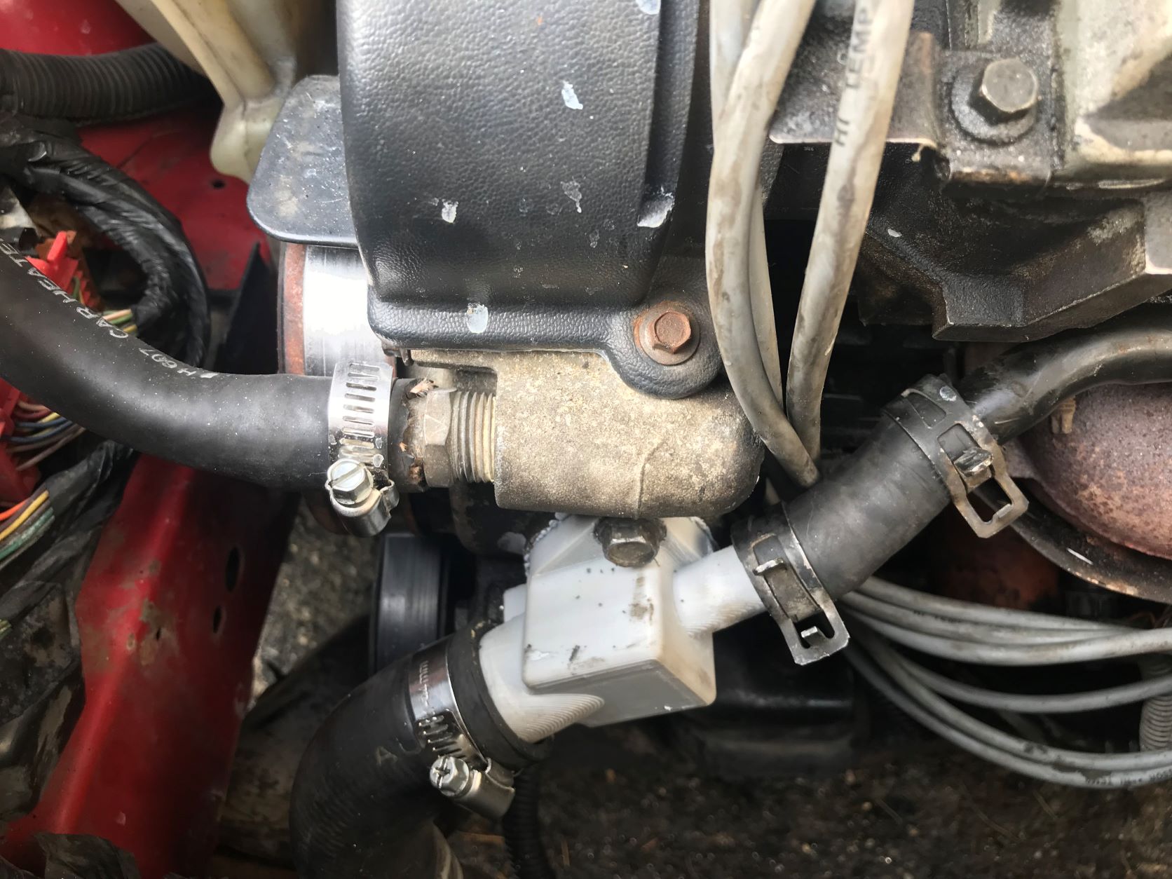

GTP091 Posted August 2, 2021 Report Posted August 2, 2021 (edited) Huh. I’m not entirely sure what that blue wire could be. Are any of your alternator harness wires blue? Possibly it is the knock sensor wire. The knock sensor wire is a a single lead and is dark blue. I guess you could go to the sensor and trace it back to see if it goes to the ecm. If it’s broke on the harness end that’s likely it. You’ll pull a code if it isn’t connected and ecm won’t be able to adjust timing to limit knock. Those 4 black wires and the other 2 with the ring terminals are certainly grounds. I just took a look at my engine to confirm. The 4 I have are grounded to the transmission on the forward bolt of the engine/trans bolt, just below the trans modulator and secured with a nut. The other two are connected in the same way but to the bolt just above the trans modulator. In the top picture you posted the lead your holding is actually pointed right at the bolt I have mine connected to that doesn’t have the nut on it. Looks like you need to tighten up the trans to engine bolts first? Clean em up and nut em down. Edited August 2, 2021 by GTP091 Quote

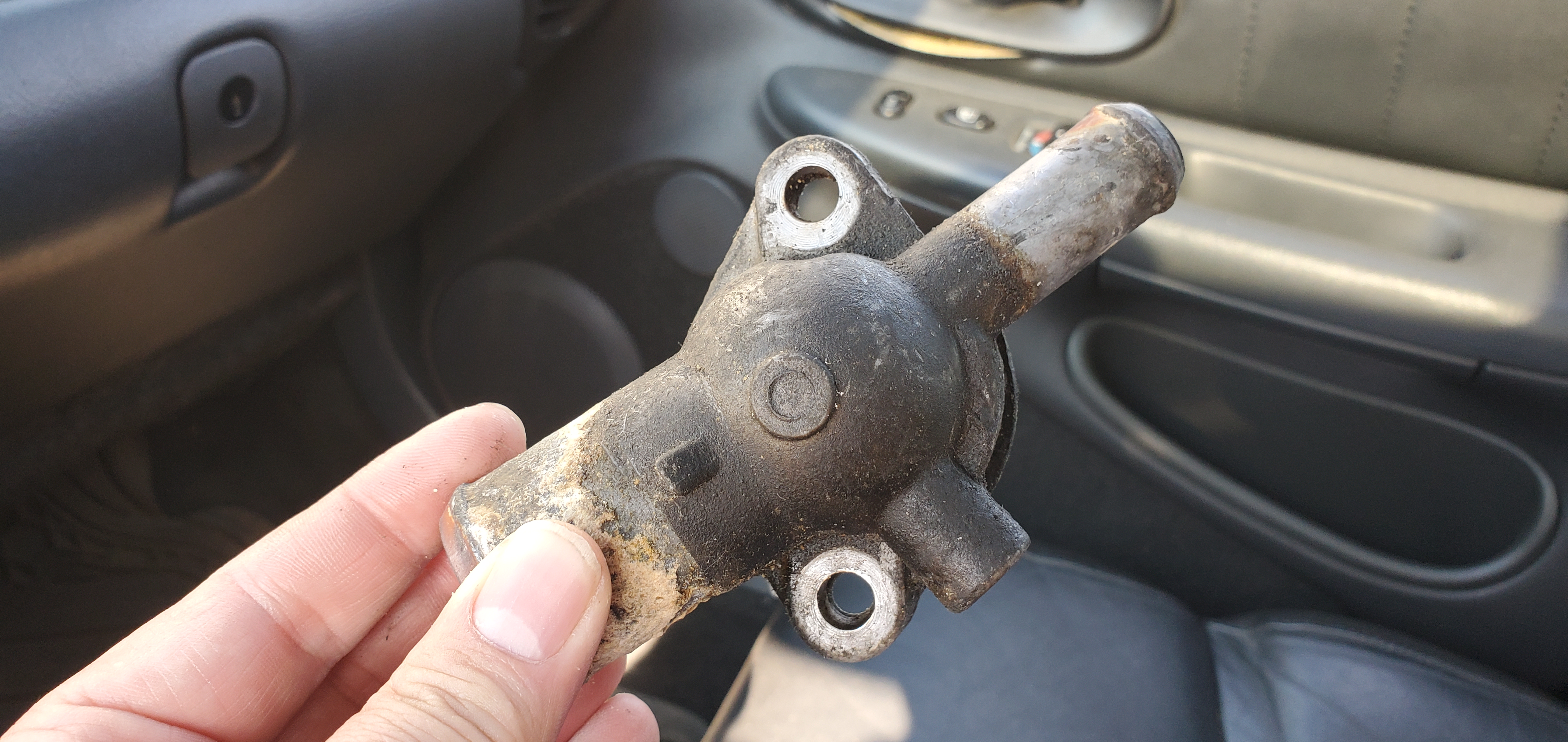

95cutlassv3rt Posted August 17, 2021 Author Report Posted August 17, 2021 Is there any way to transfer this to the convertible builds section? I installed the 3d printed part but I would like to combine everything into one thread. Anyhow, I had an issue and cracked the original one when tightening, long story short, I drove myself nuts searching the web for the water pump inlet, ended up using CAD and 3d printing one with the help of my friend Artie, he is brilliant. Just waiting for the permatex to dry. Fingers crossed!!! 94 olds vert and primergray 2 Quote
95cutlassv3rt Posted August 21, 2021 Author Report Posted August 21, 2021 So far so good, it was way easier to bleed the system then when the oem piece was in place, we are going on a trip this weekend and there is a heatwave in Maine. If the part survives we should have put about 500 miles on it by Sunday. I will be back with an update. Either the part thrives or we re-engineer and reprint the central chamber which I think is a choke-point but so far so good. Quote

95cutlassv3rt Posted September 10, 2021 Author Report Posted September 10, 2021 I have to say, I have tried everything, my 3d printed parts get soft and deform if the car gets over 200 degrees ferenheit, I need an inlet, I can't find one, I have never felt defeated, and I honestly want to set this car on fire and post the video. It is such a gorgeous example of a 95 cutlass supreme, and the fact that I cannot get a stupid piece of pig metal to fix my cooling system is driving me insane. If someone has a 2 port water pump inlet, I'll give you 50 bucks to send it my way. Quote
jiggity76 Posted September 10, 2021 Report Posted September 10, 2021 3 hours ago, 95cutlassv3rt said: I have to say, I have tried everything, my 3d printed parts get soft and deform if the car gets over 200 degrees ferenheit, I need an inlet, I can't find one, I have never felt defeated, and I honestly want to set this car on fire and post the video. It is such a gorgeous example of a 95 cutlass supreme, and the fact that I cannot get a stupid piece of pig metal to fix my cooling system is driving me insane. If someone has a 2 port water pump inlet, I'll give you 50 bucks to send it my way. PM sent. Don't worry, I'm to the rescue. Quote

jiggity76 Posted September 12, 2021 Report Posted September 12, 2021 7 hours ago, GTP091 said: Well done jiggity. is it to far gone for JB weld? Thanks! It's on it's way and he should get it by Tuesday. oldmangrimes, pwmin and 95cutlassv3rt 2 1 Quote
95cutlassv3rt Posted September 17, 2021 Author Report Posted September 17, 2021 Thanks Jiggity, I got it in the mail with bolts and clamps, thank you thank you thank you!!!! jiggity76 1 Quote
jiggity76 Posted September 17, 2021 Report Posted September 17, 2021 30 minutes ago, 95cutlassv3rt said: Thanks Jiggity, I got it in the mail with bolts and clamps, thank you thank you thank you!!!! You're very welcome. Sorry it took so long and I sort of forgot about ya. Glad it worked out. Quote
