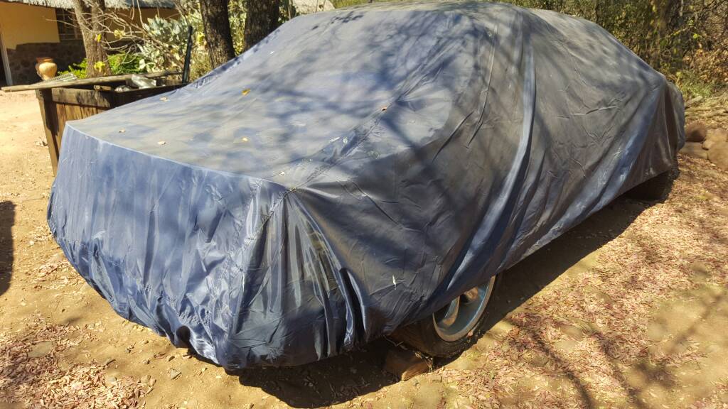

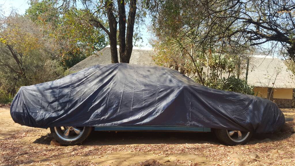

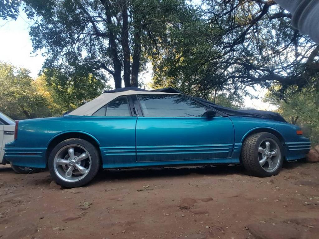

GabsOlds Posted November 14, 2017 Report Posted November 14, 2017 You guys are messing with my blood pressure! My 94 vert has been sitting all year under a cover in Africa, and I haven't thought about rats eating my new top, until you said something. I wonder what kind of scratches the cover itself has caused. Hopefully I'll be able to build a garage this December when I go down. Nas Escobar, oldmangrimes and 94 olds vert 3 Quote

GabsOlds Posted November 22, 2017 Report Posted November 22, 2017 I think the one on my car is waterproof. My battery will be dead for certain. 94 olds vert 1 Quote
